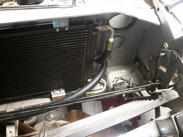

alrighty Posted January 16, 2013 Share Posted January 16, 2013 Hey Litman,none of the hoses(low or high side)run through the engine bay.Execpt for the 10" or so at the radiator support area. Quote Link to comment Share on other sites More sharing options...
alrighty Posted January 17, 2013 Share Posted January 17, 2013 Sorry,Litman just re-read your post and i completely screwed the pooch.I ran all hoses in front of radiator support.Then ran suction and discharge underneath compressor utilizing 180 degree fittings(never liked running lines over the top of compressor).This gives a much cleaner look I think. Quote Link to comment Share on other sites More sharing options...
Litman Posted January 17, 2013 Share Posted January 17, 2013 Thank you for the follow-up response. I was completely confused by the previous post but was afraid to admit it. I thought perhaps you had some super unobtanium system the worked without a compressor. Thanks for the images. I like the clean install. Certainly gives me a lot of ideas. Being that my compressor is in the stock LS1 location, which is directly below the water pump inlet/outlet, I am thinking of installing the four way bulkhead fitting just above the PS frame rail, near the shock tower. The lines, perhaps hard lines, will run in the fender well back to a point where then can punch through into the cabin. Need to noodle on this a bit more but it would provide the cleanest look possible. There will only be four short lines running in the engine bay from the bulkhead fitting to the compressor and water pump. Thanks for the inspiration. Quote Link to comment Share on other sites More sharing options...
