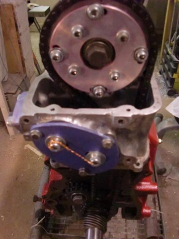

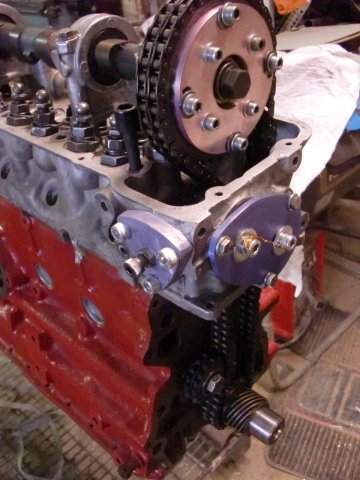

didier Posted April 9, 2013 Share Posted April 9, 2013 funny post around technical considerations ! i have many respect for Peter and also for A thomas, so for me , it's a real dilemme ! both have arguments ! i did'nt want to waste my money ( ) so i made my own idler gear system ! see photos down here! as far as power is concerned, i don't know;;;;;;;, my engine is stil waiting for my restotation to be finished. I'm making a davis craig EWP mount with reverse flow, and i made changes in the water distribution in the head ( without knowing Peter made something like this ) I think the power loss was more a temp issue in the head , leading to reduce ignition advance , and not the Kameari system. A friend here in France, with a Rebello engine has no problem with the K gear. ( just noisy ) congrats to PMC and hs30 , good guys ! don't leave us ! regards Didier excuse my english ! Link to comment Share on other sites More sharing options...

frank280zx Posted April 9, 2013 Share Posted April 9, 2013 Didier excuse my english ! Haha your french you cant help it Nice setup you have there .. any pictures of the backside of that plate ? Link to comment Share on other sites More sharing options...
didier Posted April 9, 2013 Share Posted April 9, 2013 Haha your french you cant help it Nice setup you have there .. any pictures of the backside of that plate ? No more pictures, but it's the same thing that a Kameari : sliding double gears in an aluminium alloy piece , ball bearings ( not spin rollers ) and oil jet on the lower gears. Hope that helps ! Link to comment Share on other sites More sharing options...

didier Posted April 27, 2013 Share Posted April 27, 2013 very funny post here , guys." I tell you my story : I have made my own Idler gear kameari system "just for the fun, it cost me 100 €uros ! i'm sure it will do nothing with power increase ! only to be able to say : i did it ! I will put an Australian electric water pump " Davis Craig " Just for the fun, it cost me 150 Euros, i'm sure it will do nothing for power, may be , just expecting a better cooling with mods on my head ( holes above the exhaust ports ) and i'll try reverse flow just to see. I can come back to original mount. I hope for the best advance ignition and good power, but i know it's not only with these mods ! Link to comment Share on other sites More sharing options...
didier Posted April 28, 2013 Share Posted April 28, 2013 (edited) ITS ALL IN MY HEAD MAN, ALL IN MY HEAD Get a block of aluminum or steel, make the shape of the inspection cover, but add depth to it so it goes into the head by however much. Mill two grooves. Order your idler bearing and sprocket. Make a plate,with a tapped hole so a bolt can thread into it and hold the bearing on. On the other side tap 4 holes for your lock screws, spaced the same amount as your slots. For the bottom make a cover plate where the tensioner went. Again tapped, bolt on idler. On the backside mill a slight groove or channel from the oil hole that was used for the old tensioner. Make it so that it comes up right behind the bearing, then drill a hole in the cover plate so it squirts the oil into the bearing. "easy" Until the bearing breaks off and you destroy a motor. Take a look at my post #73 I show photos of my build, it's very clear .No need for 600$, just about 100 € ! and it's very solid . Edited April 28, 2013 by didier Link to comment Share on other sites More sharing options...
josh817 Posted April 28, 2013 Share Posted April 28, 2013 ITS ALL IN MY HEAD MAN, ALL IN MY HEAD Get a block of aluminum or steel, make the shape of the inspection cover, but add depth to it so it goes into the head by however much. Mill two grooves. Order your idler bearing and sprocket. Make a plate,with a tapped hole so a bolt can thread into it and hold the bearing on. On the other side tap 4 holes for your lock screws, spaced the same amount as your slots. For the bottom make a cover plate where the tensioner went. Again tapped, bolt on idler. On the backside mill a slight groove or channel from the oil hole that was used for the old tensioner. Make it so that it comes up right behind the bearing, then drill a hole in the cover plate so it squirts the oil into the bearing. "easy" Until the bearing breaks off and you destroy a motor. Take a look at my post #73 I show photos of my build, it's very clear .No need for 600$, just about 100 € ! and it's very solid . Oh damn I didn't catch that one. I like your idea better with an adjusting screw! Wanna PM me more pics? Trying to figure out why there is an adjusting screw, but then two lock screws, unless the adjusted isn't physically attached to the top idea (just pushing on the backside of it?) Nice thinking! Link to comment Share on other sites More sharing options...
