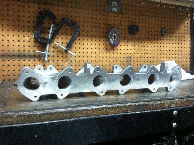

Leon Posted September 15, 2014 Author Share Posted September 15, 2014 On another note, I had some time to paint the TWM intake that I plan to swap in. Paint color is "Cast Aluminum" so it didn't really change the color of the part much but I wanted to do it because painted parts are easier to maintain than bare metal. I also decided to take some measurements for the sake of documentation. The Cannon roughly measures about 145mm/5.7" long while the TWM is ~106mm/4.2". That's a 1.5" difference in length, more than I expected! This is nice because it'll open up some room between the air horns and inner fender and master cylinder. I just ordered 3/8" phenolic carb mounting blocks which will extend effective manifold length to just over 4.5". Quote Link to comment Share on other sites More sharing options...

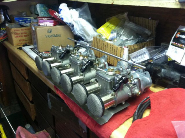

Leon Posted December 14, 2014 Author Share Posted December 14, 2014 Finally some more progress! I helped a buddy do the first startup and break-in of his L30 last weekend and it seems to have reinvigorated the thirst of hearing my L28 purr again. I port-matched the TWM manifold on the carb side Friday after work and ground the areas where the intake flange interfered with the MSA 6-1 header flange yesterday. I touched up the affected areas with some new paint. Today, I got the carbies all mounted up along with the heat shield. The last bit left is to finalize how I want to do the linkage and then finally reinstall! Quote Link to comment Share on other sites More sharing options...
bradyzq Posted December 17, 2014 Share Posted December 17, 2014 Looks great! You don't specifically mention it, but since I think I see some sanding marks on the port side of the TWM intake, I'll assume you matched the runners to the ports too. MANY moons ago, like 20 years ago, I had my TWM intake matched to the intake ports. Surprisingly, the runners didn't line up perfectly with the ports. It was as if the bolt holes were evenly off a bit. Did yours line up well? Quote Link to comment Share on other sites More sharing options...
Leon Posted December 18, 2014 Author Share Posted December 18, 2014 Looks great! You don't specifically mention it, but since I think I see some sanding marks on the port side of the TWM intake, I'll assume you matched the runners to the ports too. MANY moons ago, like 20 years ago, I had my TWM intake matched to the intake ports. Surprisingly, the runners didn't line up perfectly with the ports. It was as if the bolt holes were evenly off a bit. Did yours line up well? Thanks Brady! I didn't want to do the ports as not to mess up the taper in the intake. I did check to make sure that the runners match the ports via using the gasket as a template. All seems good! Quote Link to comment Share on other sites More sharing options...
