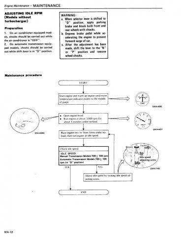

wickedminded Posted February 11, 2013 Share Posted February 11, 2013 (edited) I have a 1982 datsun 280zx non turbo I'm trying to find the idle screw it says its on top of the throttle chamber but it isn't where it shows in the FSM so anybody know where its at Edited February 14, 2013 by RB26powered74zcar Edited title to help clarify. Quote Link to comment Share on other sites More sharing options...

NewZed Posted February 11, 2013 Share Posted February 11, 2013 There's two, at least, really nice drawings in the FSM, one in Engine Maintenance and one in Engine Fuel. Shows a screwdriver stuck "in a hose" to adjust idle speed. Could be that someone has removed yours. Quote Link to comment Share on other sites More sharing options...

cgsheen Posted February 14, 2013 Share Posted February 14, 2013 Quote Link to comment Share on other sites More sharing options...
BluDestiny Posted February 15, 2013 Share Posted February 15, 2013 Its on the side of the intake, just behind the throttle body. will look just like the picture on the bottom right of the page that cgsheen posted. Quote Link to comment Share on other sites More sharing options...
Tony D Posted February 15, 2013 Share Posted February 15, 2013 On 2/14/2013 at 7:48 AM, wickedminded said: I have the 79 to 83 FSM THERE IS NO SUCH BOOK! FSM's are BY YEAR. What you got ain't an FSM, and you probably should follow the example of cgsheen and NewZed and get one from the free download site. BluDestiny describes it perfectly, right on the side of the intake manifold aft to the throttle body. It's bolted there, and is easily removed so you can adapt it to other vehicles that need an idle speed screw when doing EFI Conversions. I used it on my turbo EFI conversion, as well as a couple VW's and likely my Corvair when the time comes... Quote Link to comment Share on other sites More sharing options...
