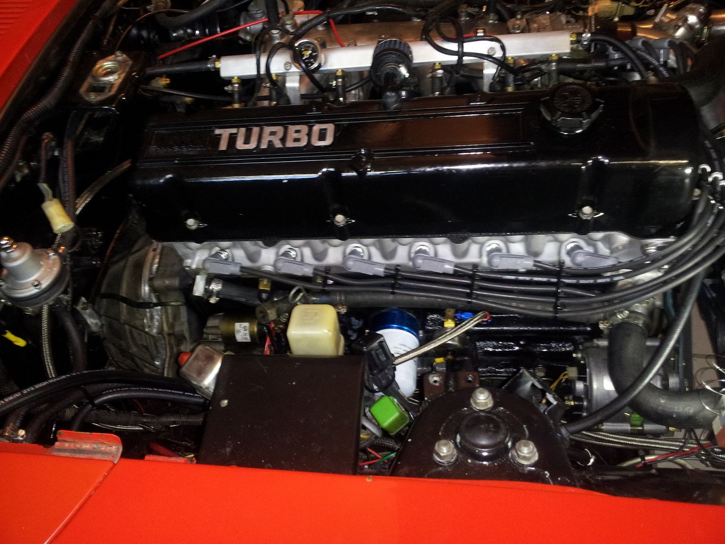

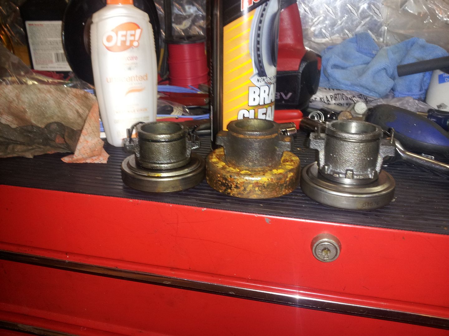

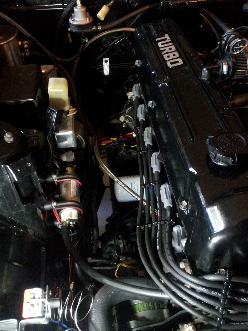

tooquick260 Posted May 27, 2013 Author Share Posted May 27, 2013 (edited) Yeah the clutch works and the tranny works... Now onto putting the wiring away. I did as much as I could, finished the passenger side, just need a 1 3/4" hole saw to run the ECCS wires thru the fire wall. Now still have to fix the turbo oil leak. Need a restrictor inline to the turbo. Also need exhaust, once oil leak is fixed will get the pipiing done. Then get an alignment and drive it like I stole it. Edited May 4, 2015 by tooquick260 Quote Link to comment Share on other sites More sharing options...
volfan98 Posted May 28, 2013 Share Posted May 28, 2013 So the MSD wire set that you used is 31233? They look a lot better routed that way. Quote Link to comment Share on other sites More sharing options...
tooquick260 Posted May 28, 2013 Author Share Posted May 28, 2013 Yes I agree, Cleans up the hole engine compartment Quote Link to comment Share on other sites More sharing options...

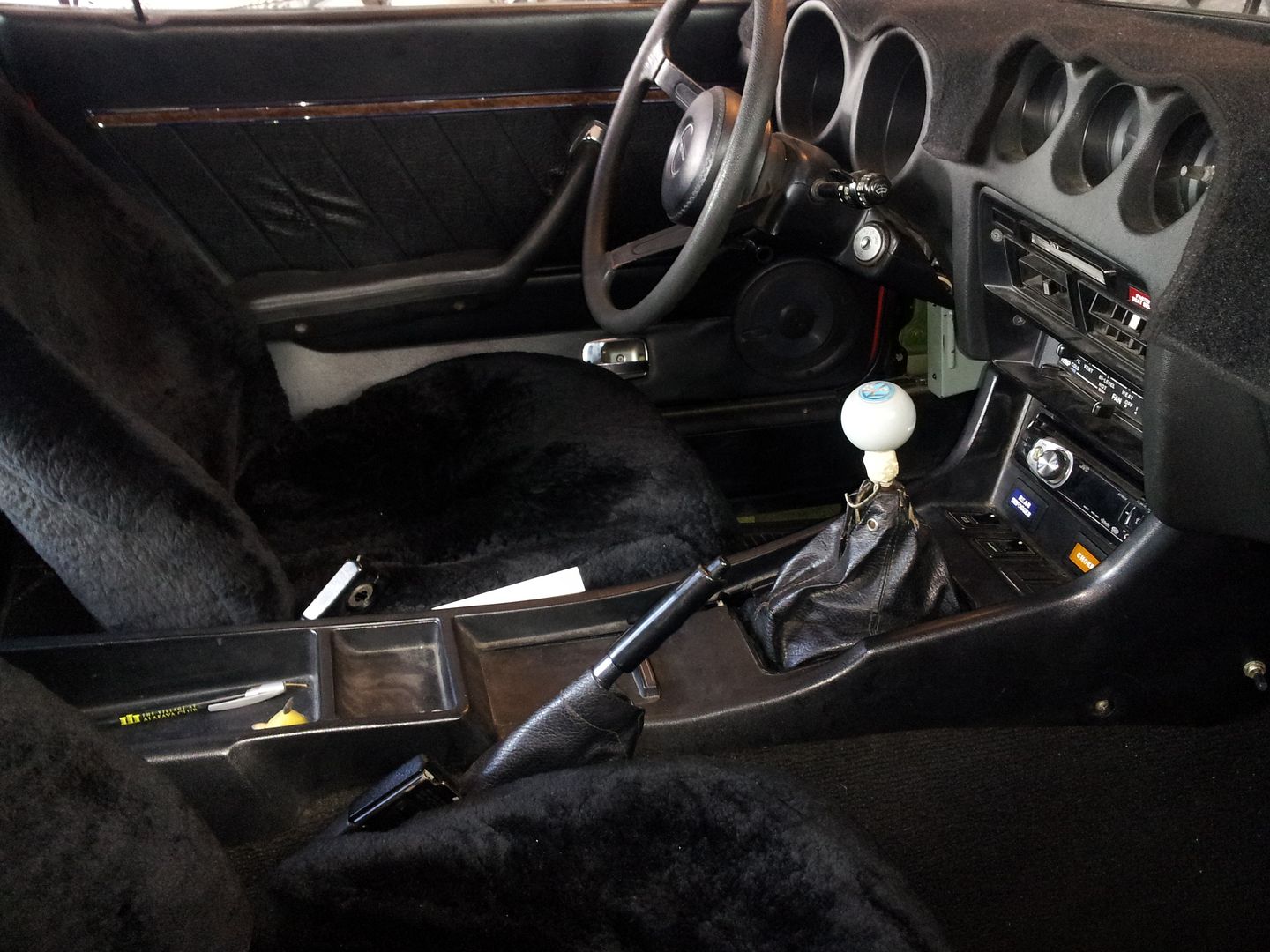

tooquick260 Posted May 30, 2013 Author Share Posted May 30, 2013 (edited) Well pulling the turbo off to get the seal replaced. Still getting oil and smoke coming out the tail pipe. Here is a pic of the interior. I used one of my dad's old round ball shift knobs. Looking for a new one. I have the stock leather shifter boot sitting there and will see about getting it to fit better. The S15 shifter is really fat at the bottom which makes it hard to tie the leather straps. Maybe I can sweet talk mom into making me a new one Edited May 4, 2015 by tooquick260 Quote Link to comment Share on other sites More sharing options...
