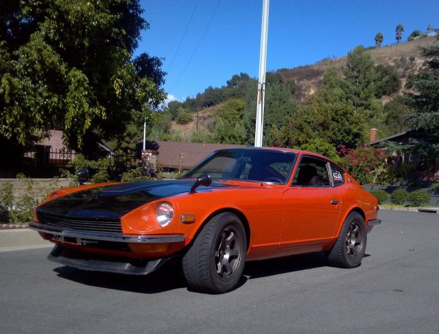

ktm Posted April 24, 2013 Share Posted April 24, 2013 Rota Grid Offroads, 16x8 +10 shod with 245/50R16s. The front wheels have a 10mm spacer and the rears no spacer. I had to roll the fenders due to the tire size. A narrower tire with a smaller profile (tires and wheels at an inch larger than stock diameter) would probably have sufficient clearance. Quote Link to comment Share on other sites More sharing options...
