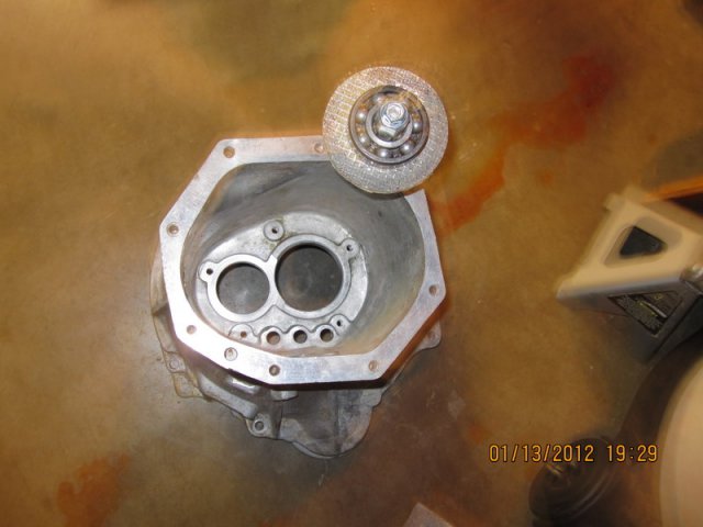

Ok so the nightmare continues. I'm having a hell of a hard time finding a machine shop around the Seattle area that can handle the job of mod'ing the L28 bell housing to except the 240sx gear box. Most shops here will not even talk to me when I mention car parts machining.
The bell housing is at a custom hot rod shop (last ditch effort) right now and I'm waiting to see if they can do what I need (probibly not).

The part that makes a machinist nervous, or cause a high quote, is cutting the hole for the bigger 240SX bearing.  If you swap bearings instead, the rest is low precision work that nobody should balk at.
Exactly and this is why I had to go talk with the machinist. This mod is the point of no return, unless you have another transmission. I had the machinist read the web page that has all the info and pictures.
"its not a problem, we just need to know that you can't change things back after this mod is done." is what dude is telling me.
Yes I know what's going on. Yes I understand the information on this web page I had you read. IF you would let me use your lathe I could do the mods required. THAT really caught the machinist off guard!! So the guy called me on it and really started asking me about the process, and the measurements. I used his mics and calipers, took some measurements, crunched the numbers, and explained how I needed the "cuts" done. After that, everybody was satisfied and the work I needed was done. Now the parts are at the trans shop, and they are going thru the gearbox replacing all the bearings and any syncros that may be bad. The cost for the machine work was 100$
I bored out the bearing hole myself on a mill at work with next to no training and only a few hours practice on some other parts. This should be a piece of cake for any experienced machinist!

False alarm, the trans shop called and they are unable to clearance the 280z bell housing to fit the larger countershaft bearing and  gear.
So it looks like im s.o.l.............................................................;-(
They only enlarged the shift rod hole?  Weak.
Swap bearings and do the clearancing yourself.
