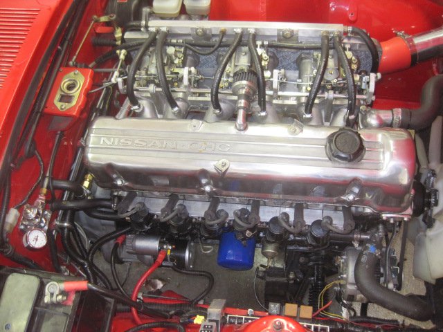

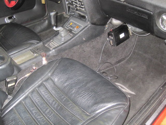

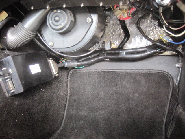

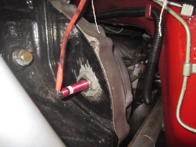

madkaw Posted April 4, 2014 Author Share Posted April 4, 2014 Cleaned up the wiring and called it a wrap!! some pics Quote Link to comment Share on other sites More sharing options...
winstonusmc Posted April 5, 2014 Share Posted April 5, 2014 Looks good. I have been wanting to move my ECU somewhere like yours for a little while. I really like the idea of a flywheel trigger. Looking good! Quote Link to comment Share on other sites More sharing options...

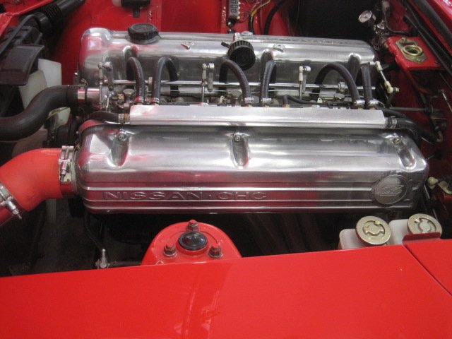

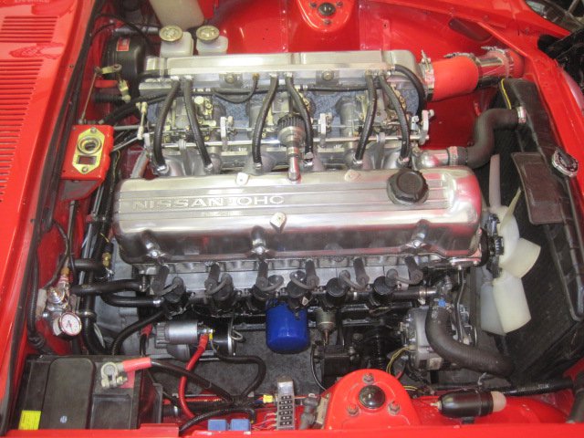

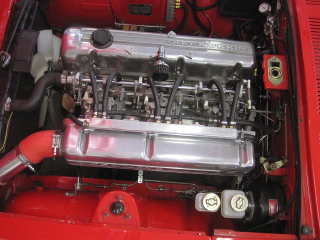

madkaw Posted April 12, 2014 Author Share Posted April 12, 2014 So I have been playing around with the tuning and so far so good. I have advanced all regions of the table and my MAP reading seem stable enough to tune with. I need to taek my son with me and have him man the laptop and plug in numbers on the roll-especially for cruise. Cleaned up the engine bay for some pretty pics. Quote Link to comment Share on other sites More sharing options...

Chris83zxt Posted May 3, 2014 Share Posted May 3, 2014 Very clean engine bay. Hope I can get mine looking that organized at some point Quote Link to comment Share on other sites More sharing options...
