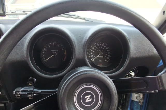

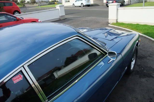

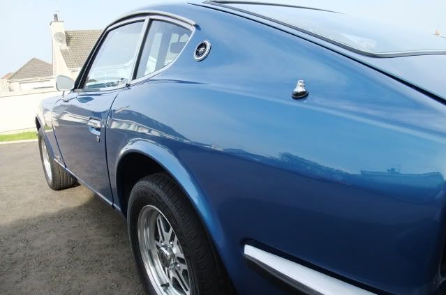

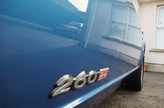

I'm still planning on sticking an RB26 in this so thought a build thread would be a good idea. The first few posts are just copied:

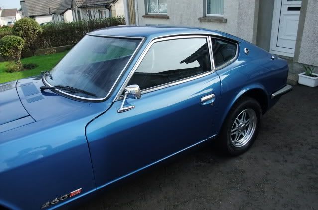

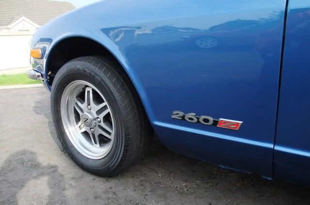

Just bought my first Datsun and I'm really happy with it so thought I'd post some photos. I've still got loads to learn about these cars so I'm sure this forum will be a huge help.
1979 Datsun 260Z
Shes in great condition, only 28480 miles on her when I bought it although its not far of 29k now. She was built in 1978 but only first registered in 1979 and going by the chassis number she was one of the the last to be imported from Japan to the UK. Theres few photos with my Civic in them also, shes a 1991 Civic running a 243hp B20.
It drives beautifully, its had new bushes all round and with the low miles on the chassis it still feels really tight so its a joy to drive.
I have real big plans for her involving seam welding, cageing, hugely uprated suspension and brakes and an engine swap, I like the idea of a V10 because I love them but failing that I'd like an RB26DETT.
For now though the first mods will be:
Paint the brake calipers and drums
Polish up the lips on the wheels
Give the engine bay a good clean
Clean out the carbs
Do something with the rocker cover
Give her a full detail, I've already done the inside but the outside still needs done
After that lot I'll be fitting a bigger better airdam and a rear spoiler follwed by a good coilover setup with adjustable camber plates welded in as shes definitly too high at the moment. Then I'll have to fit the arch flares before I can fit my new wheels other wise they won't fit.
Photos
Sorry for the amount but I couldn't decide which to put up.

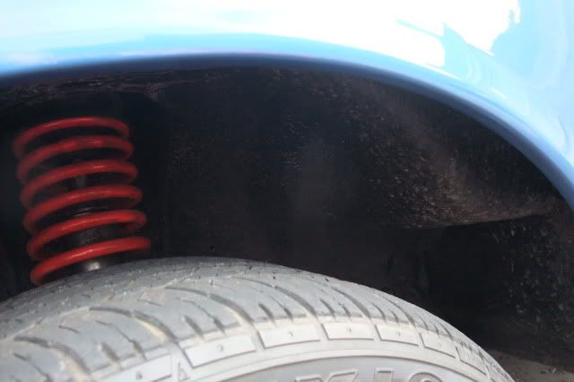

Got to work on the rear wheel arches, any rust I found was ground back to clean metal, sanded, cleaned, primed, painted and then undersealed:
P-side before:
P- side after:
Drivers side before:
During:
After, I also painted the brake drums.

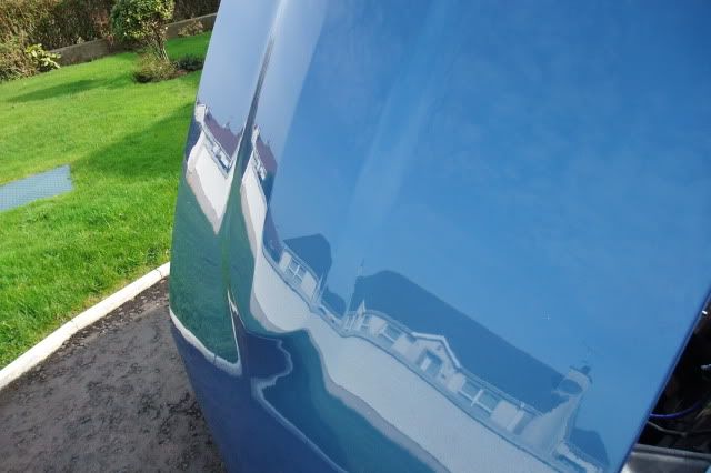

I polished and waxed the front end, I have since finished the car, but didn't get any chance to take photos.

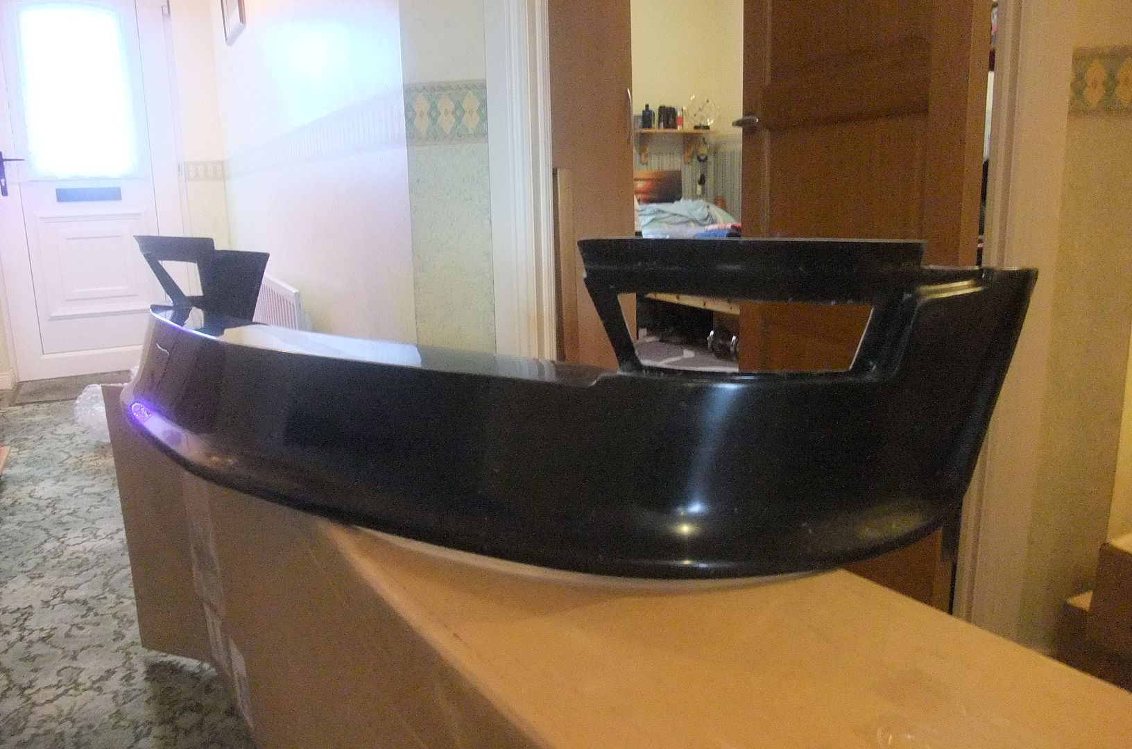

Airdam

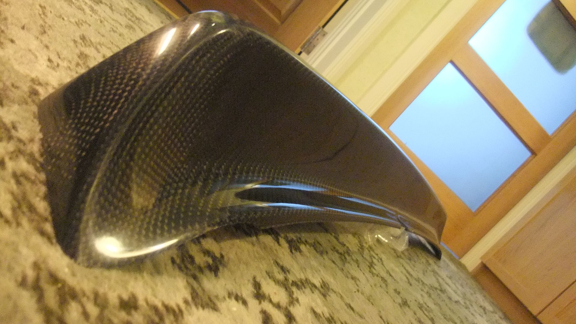

Carbon Fibre BRE style rear wing, very lightweight and rather nice looking:

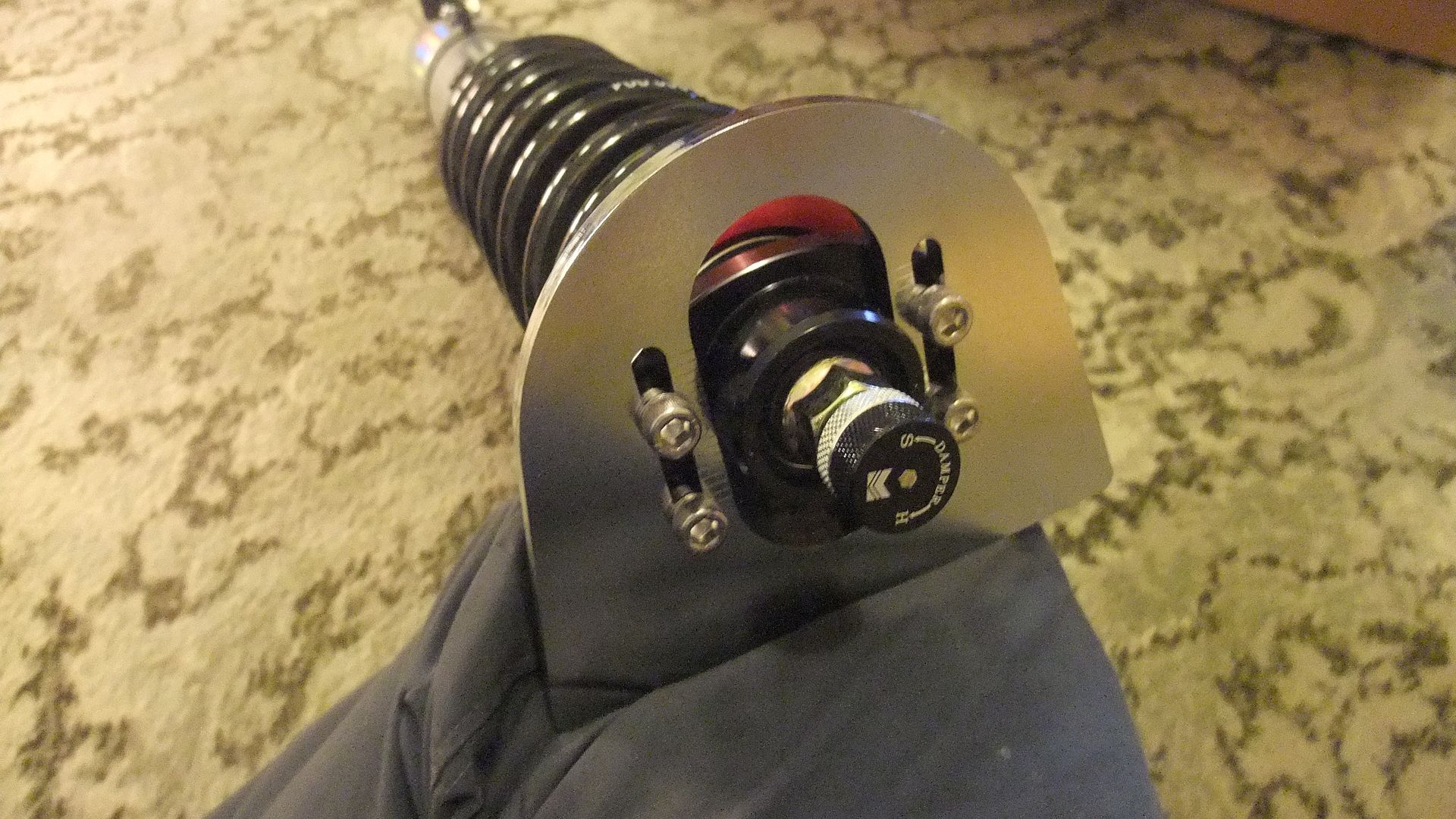

Coilovers, should do a nice job, fully adjustable and the quality looks very good.

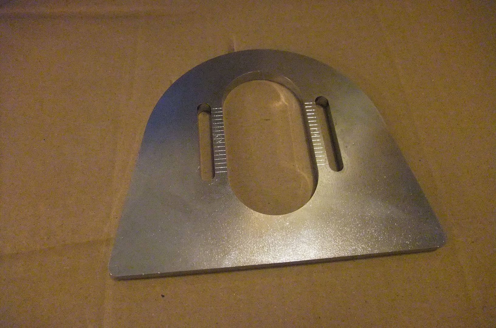

Camber plates to weld in, only fitting these to the front for now:

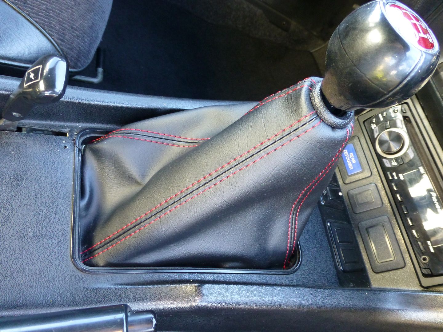

Red stiched gear gaiter, thought mine was a bit tatty:

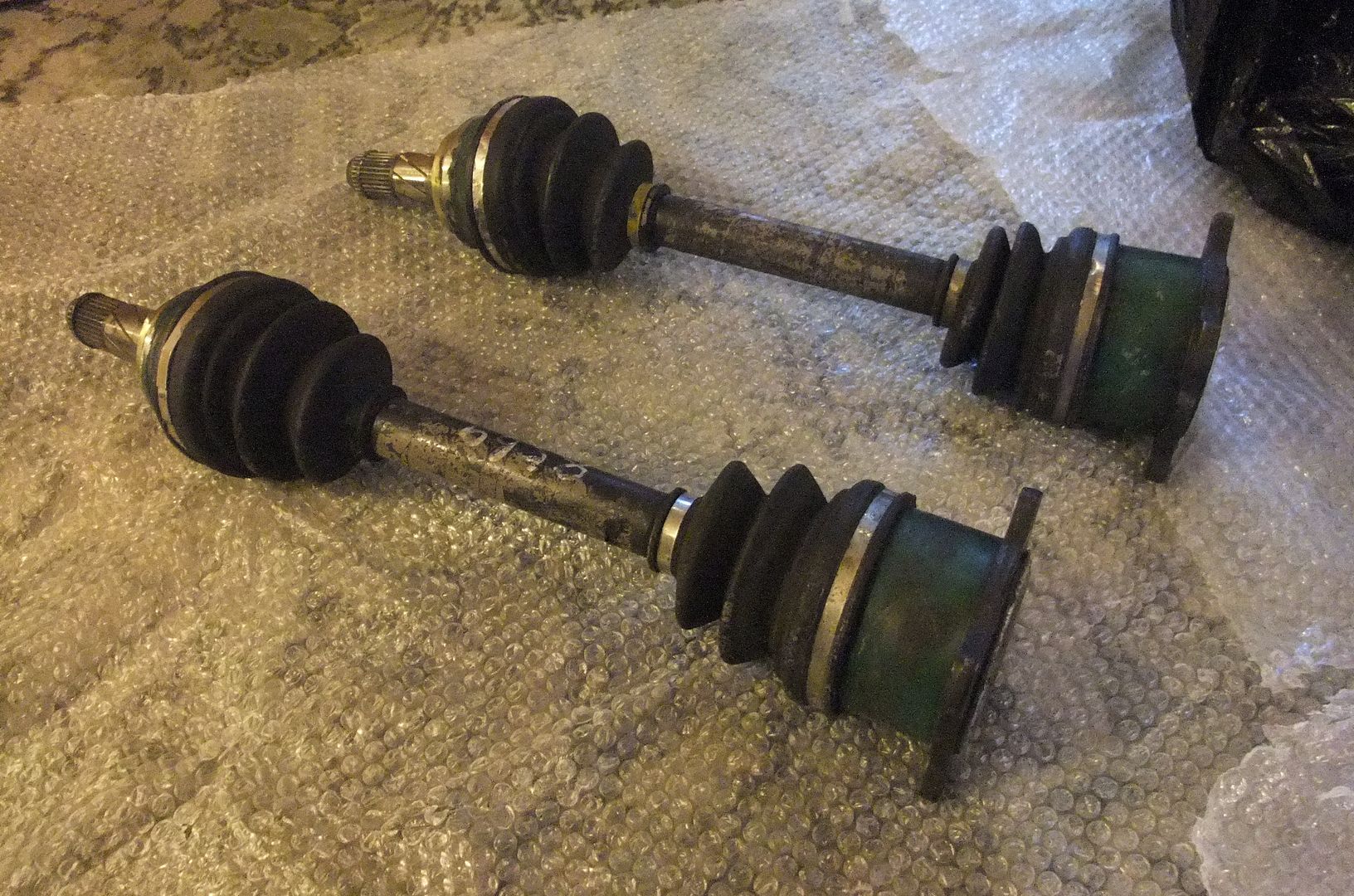

Z31T CV driveshafts

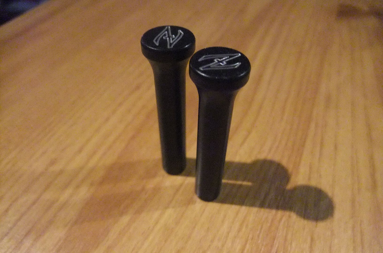

Billet alloy lock pulls:

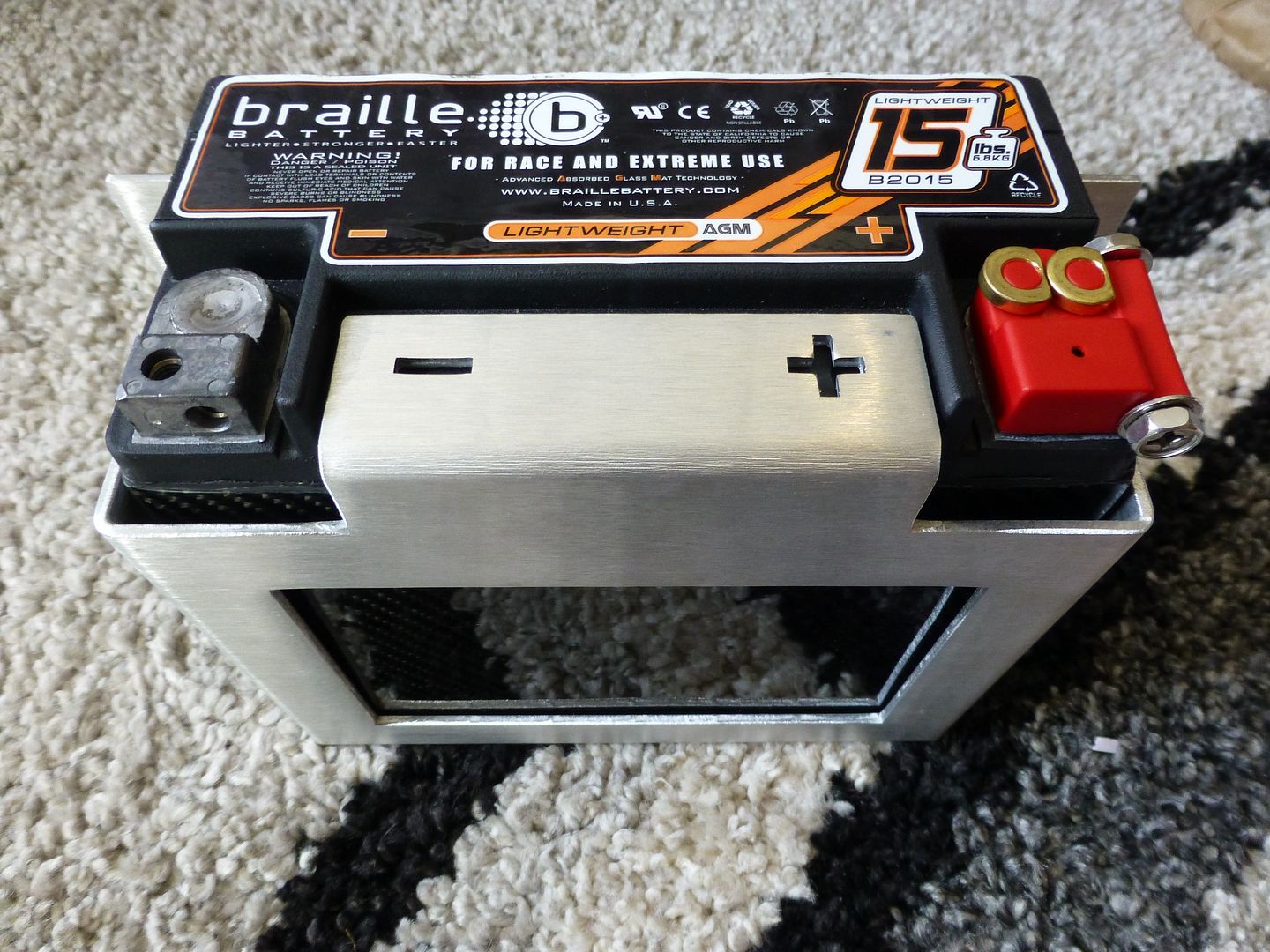

Ok, so I blew way too mich money on my battery setup, but I just love it  :D  Guess I must have a bit of carbon whore in me.
Battery through bulkhead fitting, as battery will be mounted behind the passenger seat:

Custom made shorter and stonger shafts for the Z31T cv setup:

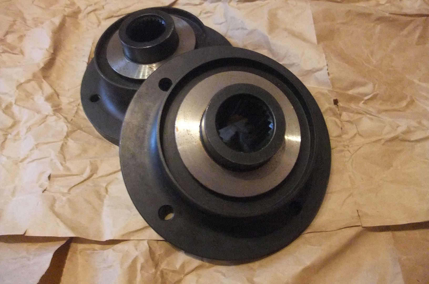

To go with the billet cv companion flange convertors:

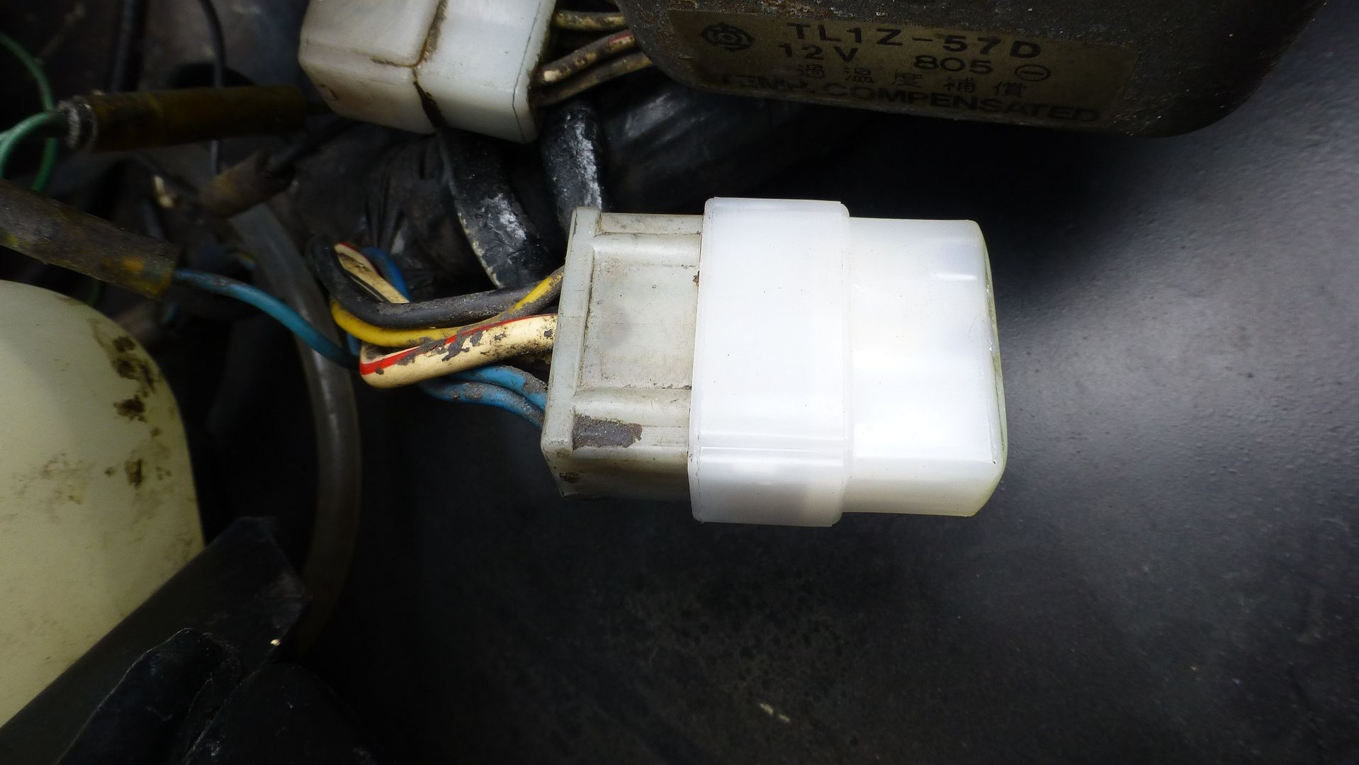

New alternator with internal voltage regulator so I can get rid of the external one and tidy up the bay:
Some wiring covers and heatshrink:
Will make all my wiring look much neater (will use black heatshrink on the rest rather than red)

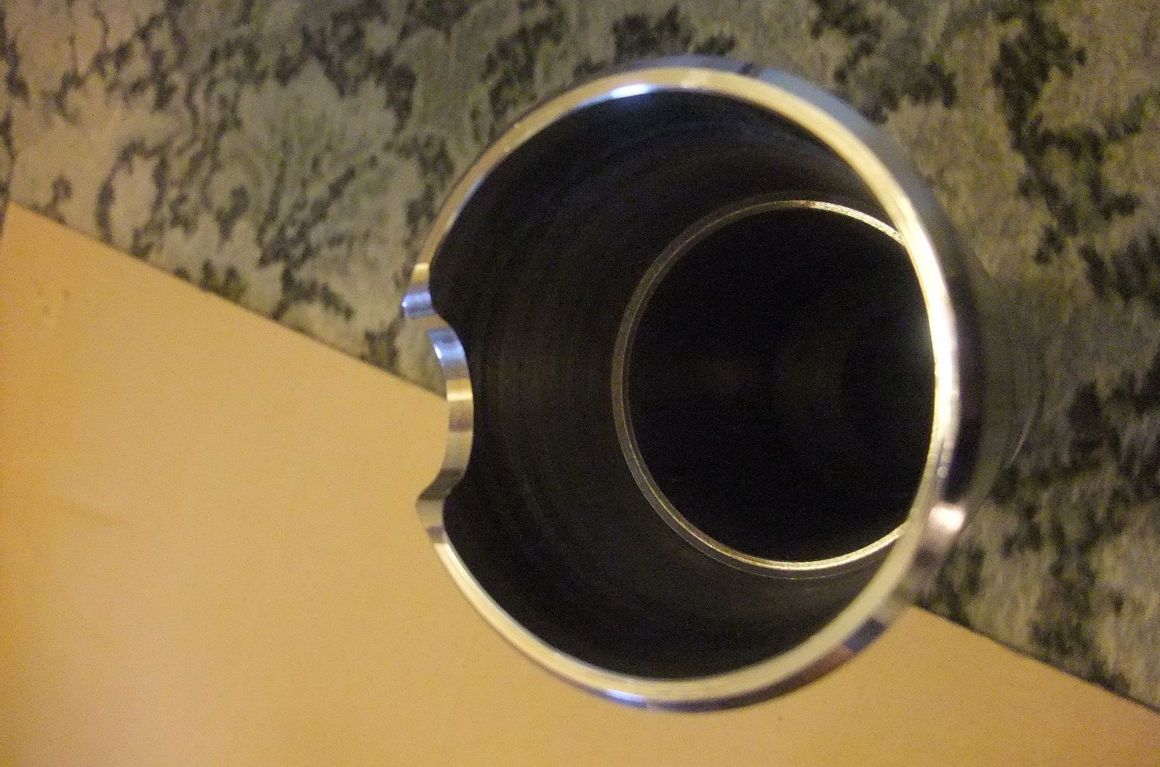

AZC Billet alloy shorter steering arms to quicken the steering with built in bumper steer spacers:

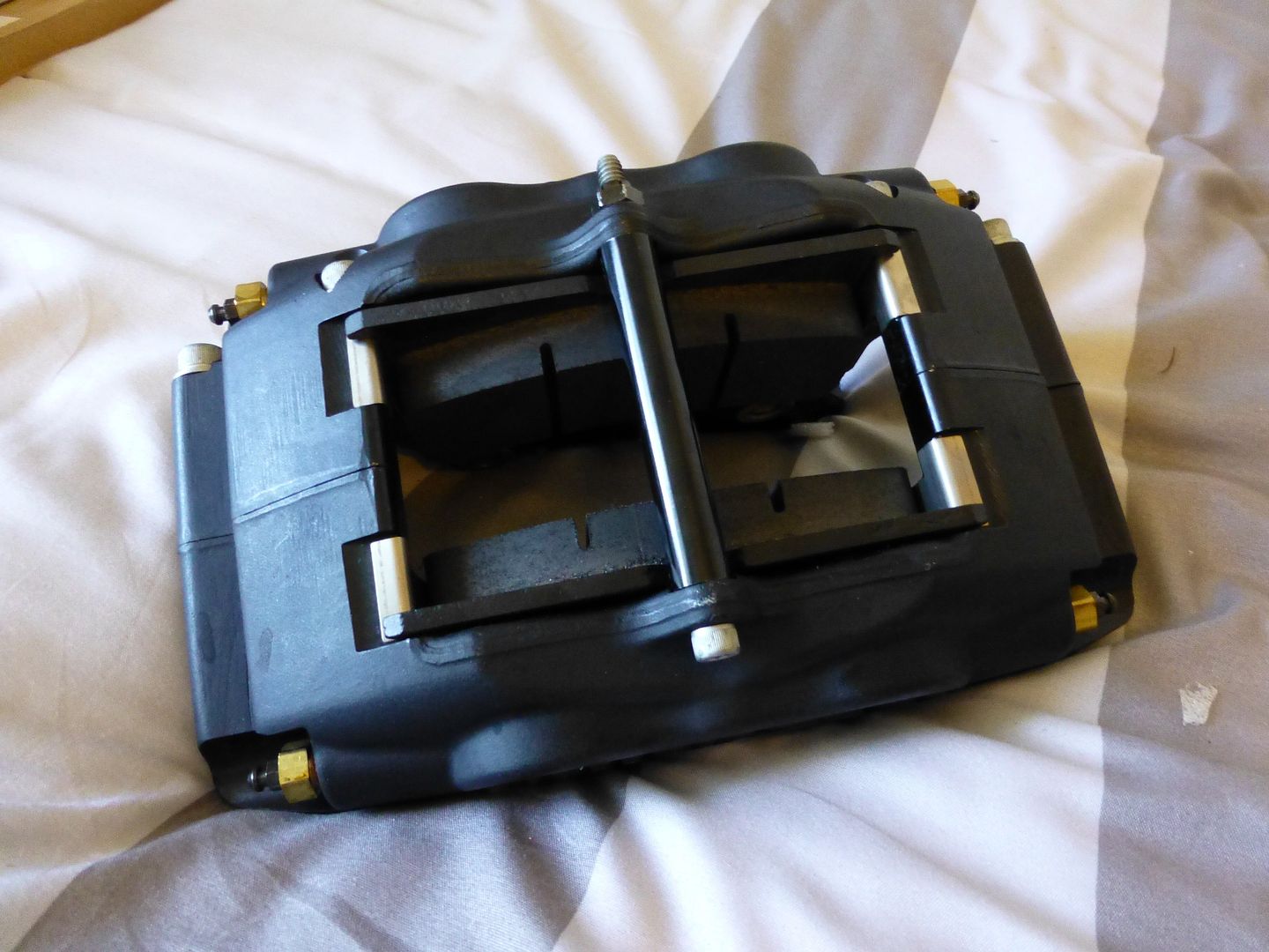

Brake Setup
Going to be running these bad boys on the front:

Changed my crappy old alternator for a more powerfull one with an internal voltage regulator, its a much better job, my interior and exterior lights now work better and brighter and I've got rid of the ugly external regulator:
Old One
New One:
Conversion Plug:
Gets rid of this thing:
