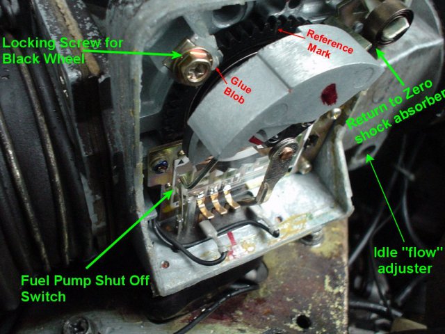

richie2619 Posted June 25, 2014 Share Posted June 25, 2014 Before I swapped to the V8, My '78 was getting a consistent 23MPG on a 225,000 mile engine. Ironically, it got about the same with the 8, if I could keep the back half of the carb closed. Someone mentioned the possibility of the injectors having inconsistent flow due to carbon deposits. You may need to check the spring tension of the air flow meter. I've heard of people trying to richen up the fuel by altering the spring. Quote Link to comment Share on other sites More sharing options...

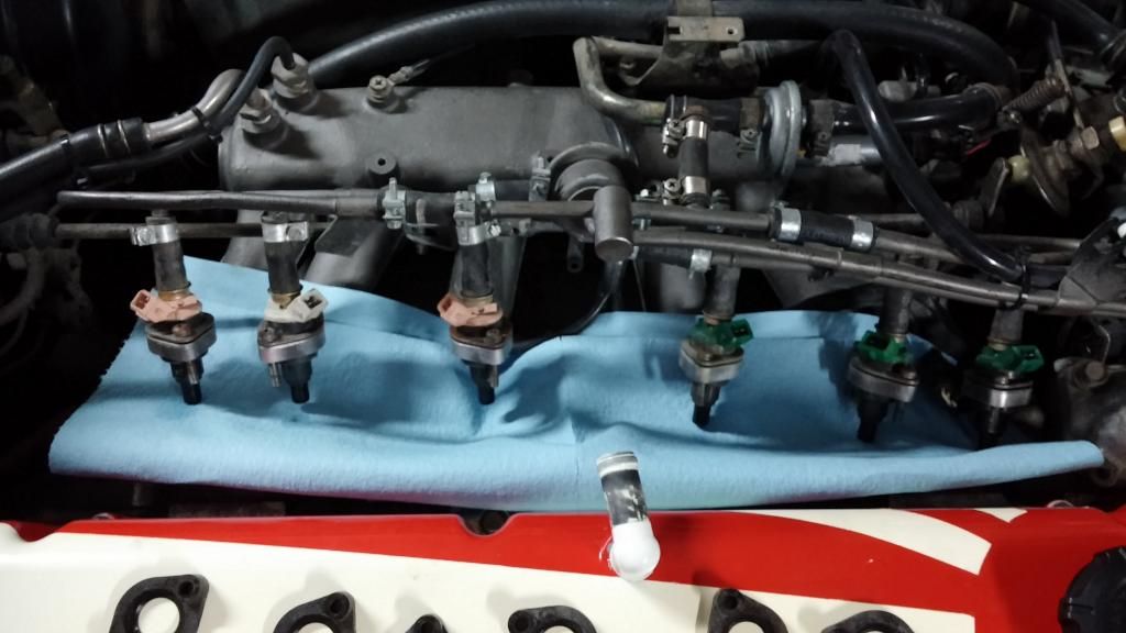

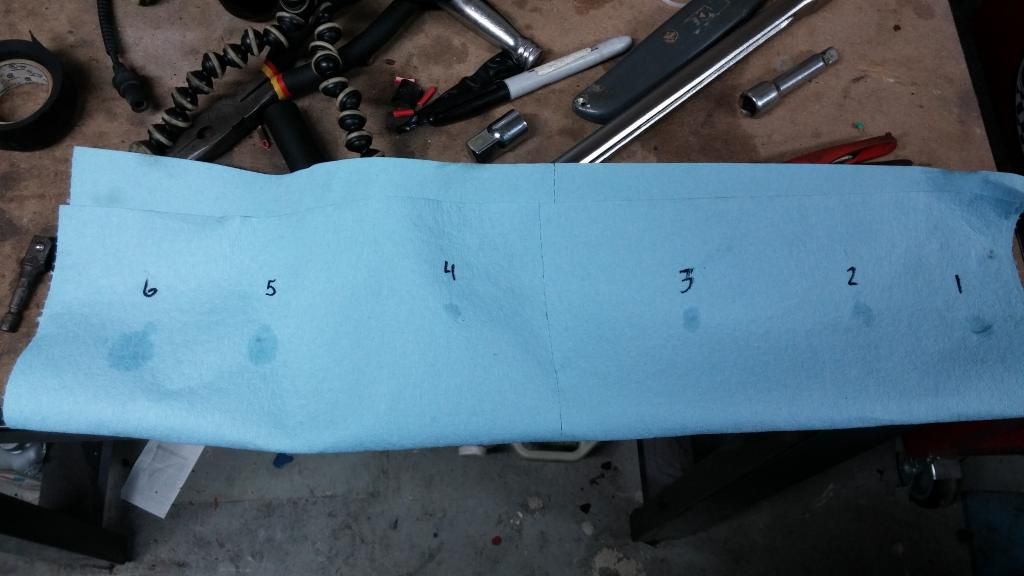

osirus9 Posted July 27, 2014 Author Share Posted July 27, 2014 So after I did my EFI adjustments I was up to 17.6mpg! Still losing fuel pressure though. So I popped my fuel rail off and pressurized the fuel system. Apparently ALL my injectors leak? How could they all leak!? pics of the test setup and results: This picture was taken after about a half hour of letting the system sit and depressurize. So I took my extra set of injectors, looked them over, and none of them look that great. I'm going to send them off to get cleaned and be done with this mess... Quote Link to comment Share on other sites More sharing options...
