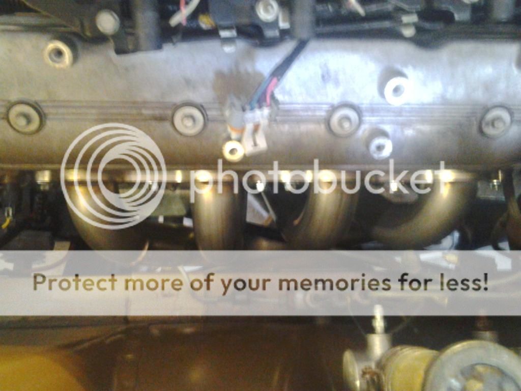

280zjake Posted November 8, 2013 Share Posted November 8, 2013 (edited) here is a pic of my headers installed. I'll let the car down and get one with plug wires n a bit Edited November 8, 2013 by 280zjake Quote Link to comment Share on other sites More sharing options...
