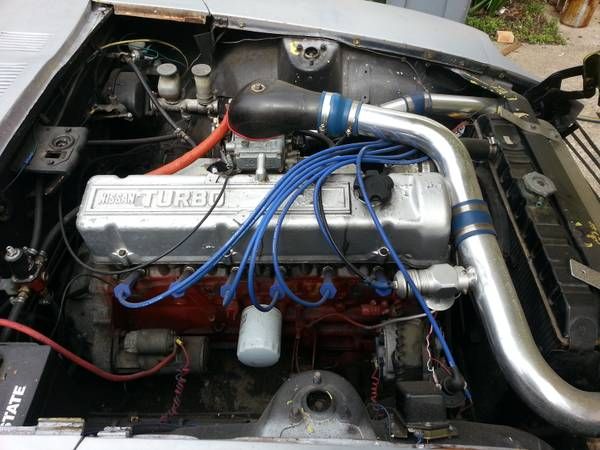

SuperSamuri Posted March 22, 2014 Share Posted March 22, 2014 Just purchased a '71 240Z with a Holley blowthrough (or is this a drawthrough?) set up with a Garrett AR 50 turbo and a large intercooler and adjustable boost set at 10lbs. New member, and any additional info on this set up or any members personal experience would be appreciated. Initial idea was to do fuel injection (probably Megasquirt) but the car drove really well on a 100 mile freeway run from the Bay Area to Sacramento, Still have to drive in back to Los Angeles at the end of the month. few things to take care of first including bleeding the brakes. Car was a non op since 2010. Quote Link to comment Share on other sites More sharing options...
Tony D Posted March 22, 2014 Share Posted March 22, 2014 That's an Intercooled blow-through setup. Quote Link to comment Share on other sites More sharing options...
