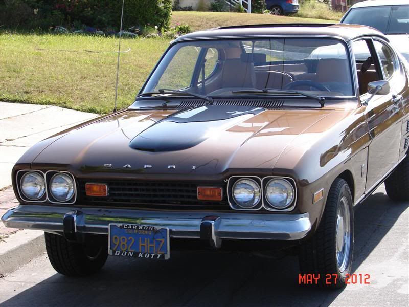

After the body and paint still with original drivetrain:

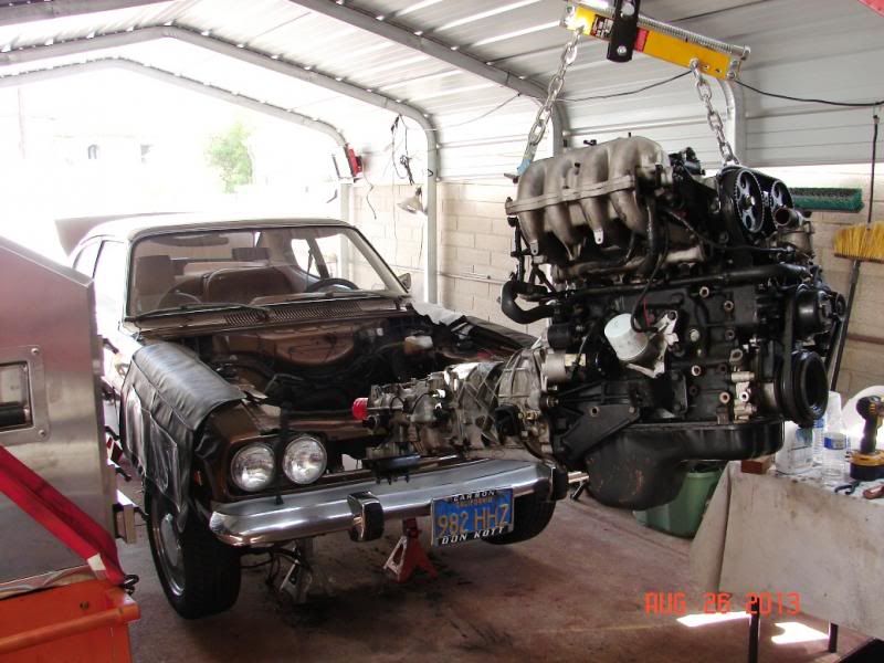

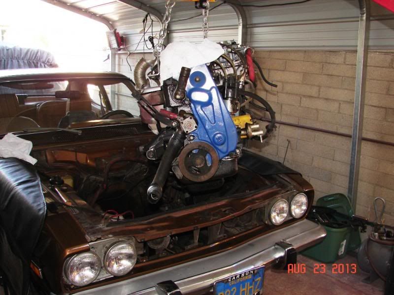

Pulling the engine:

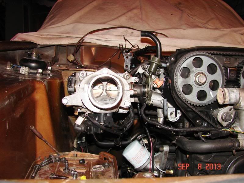

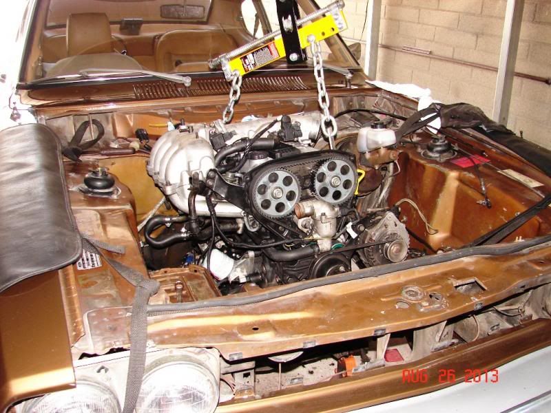

First test fit of the FE:

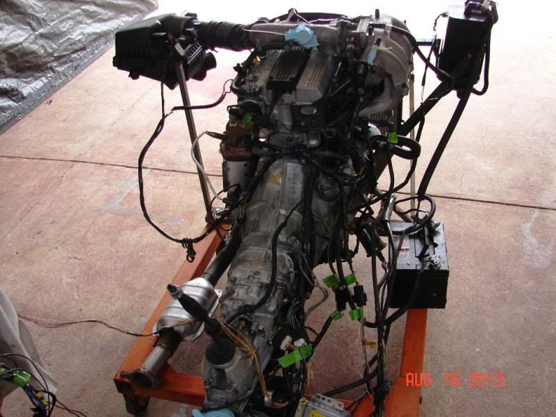

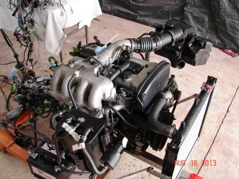

Hooked everything up and fired it on the stand:

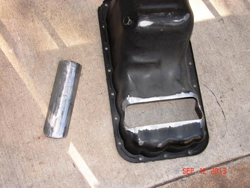

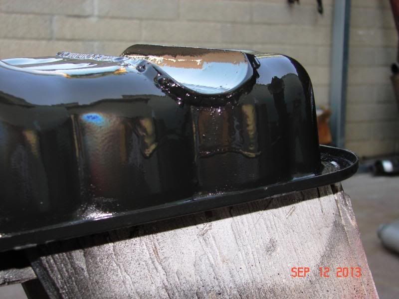

Modified the oil pan to allow lowering the front of the engine a couple more inches:

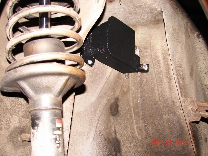

Absolutely no way to mount the clutch slave in the engine bay (between the brake booster and inner fender).  Now in the wheel well (with a protection cover):

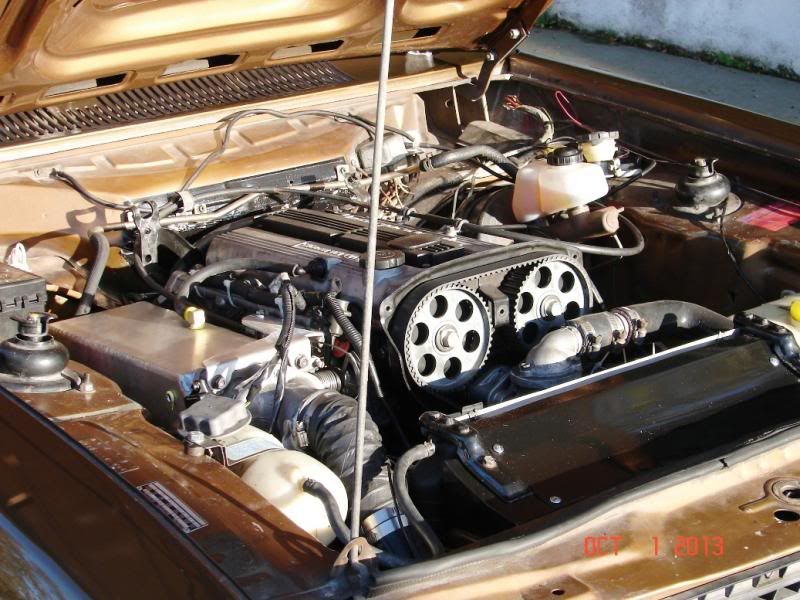

Modified intake (hood clearance):

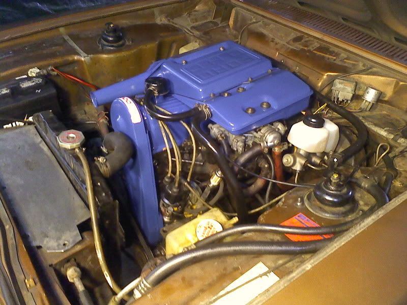

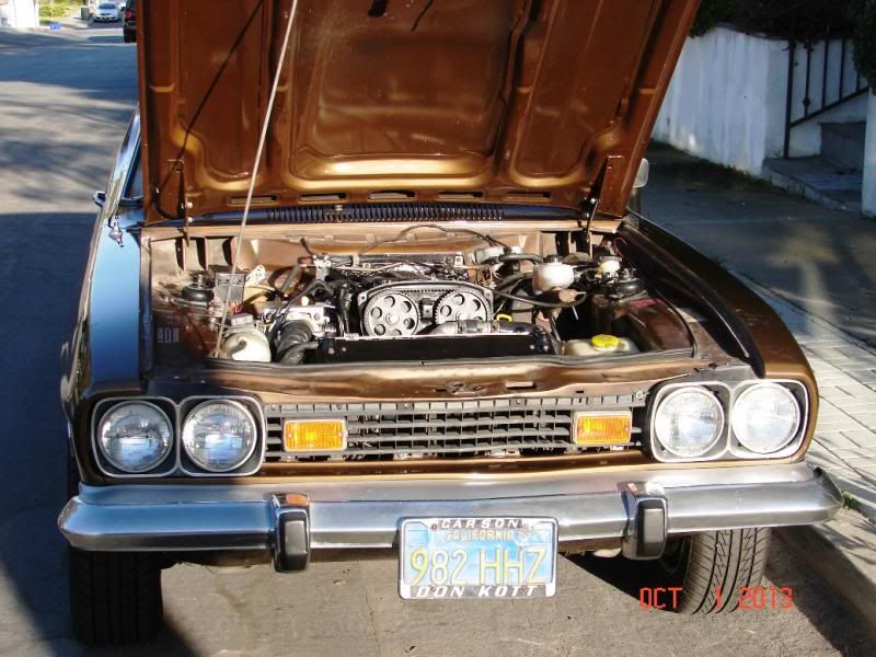

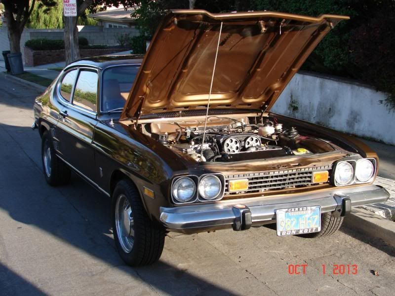

And final installation:
