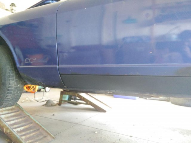

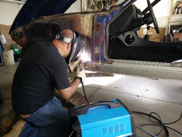

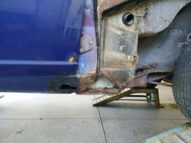

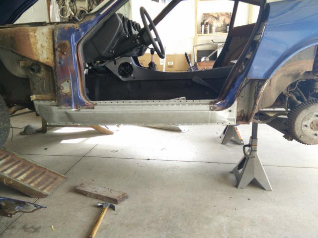

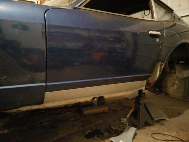

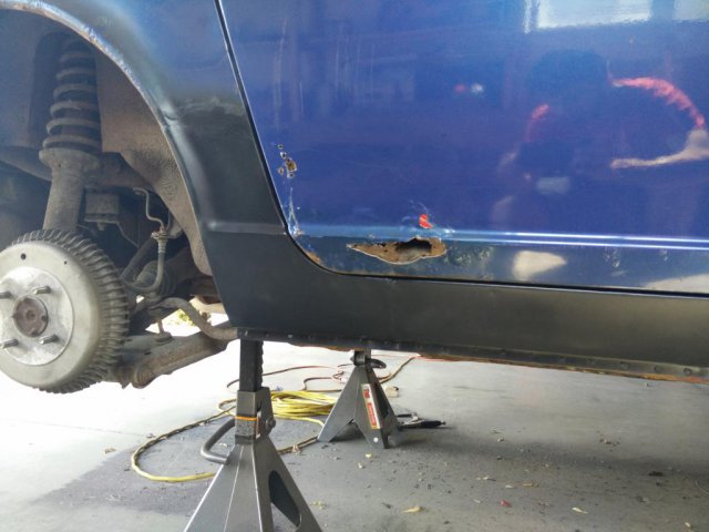

Zetsaz Posted July 24, 2015 Author Share Posted July 24, 2015 Couple more randoms of the full rockers in the middle of alignment, some rust, a couple of welding shots, and the passenger door rust I'll have to patch. Quote Link to comment Share on other sites More sharing options...

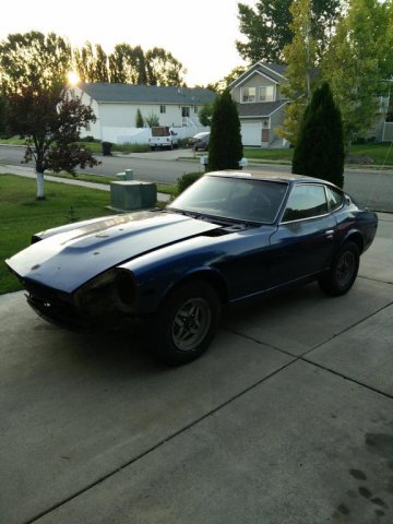

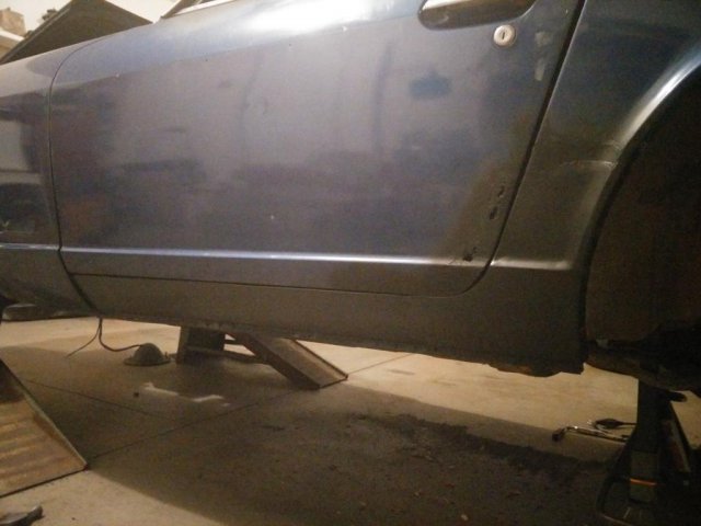

Zetsaz Posted August 22, 2015 Author Share Posted August 22, 2015 Here's the last picture I took before putting it back in my garage. Not really put back together but tons of progress was made in the last year. The engine feels pretty good, huge portions of the metal have been fixed, seats reupholstered, nice fbody fuel tank properly installed, internal racetronix fuel pump running beautifully, carpet kit cut, door interior all there except the driver door panel not being installed. Excited to get back at the end of the school year (I'm teaching Music at a high school here in Washington) Quote Link to comment Share on other sites More sharing options...
RebekahsZ Posted August 22, 2015 Share Posted August 22, 2015 Beautiful work! Quote Link to comment Share on other sites More sharing options...
seattlejester Posted August 26, 2015 Share Posted August 26, 2015 Bummer to be away from your car, but gives you more time to plan . Quote Link to comment Share on other sites More sharing options...

ladams17 Posted September 14, 2015 Share Posted September 14, 2015 Do you sharing where you bought your patch panels from? Rockers and etc.. Quality? Fitment? Quote Link to comment Share on other sites More sharing options...
Zetsaz Posted September 14, 2015 Author Share Posted September 14, 2015 Do you sharing where you bought your patch panels from? Rockers and etc.. Quality? Fitment? I bought them from a few sources: http://www.blackdragonauto.com/ http://www.thezstore.com/page/TZS/CTGY/classic02o04b The rails, which haven't been installed yet because the floors need to be repaired were purchased from http://baddogparts.com/ The rails from Bad Dog look extremely sturdy and well made and they're supposed to weld over the originals. If I remember correctly, both MSA and Black Dragon source their repair panels from Tabco, so it doesn't make too much of a difference where you get them from. The rocker panels and doglegs didn't need to much work to fit properly and weld in, but they're not perfect from the start. Still fairly easy though well... the modifying was just some trimming and drilling holes for the plug welding. The rear lower quarters were a really tough fit actually. I ended up cutting off the corners on both of them because it made the fitment almost impossible and just making little ovals to cover the holes from the old bumper shocks. Quality of on all of them is fine for pretty much any application. You have to remember though that none of these are perfect fits the way they arrive at the door. They always need a little bit of coercing and even slight cutting to make them fit your application. I spent probably 4 or 5 hours making them fit what I needed. That time doesn't account for cutting metal off the car then the welding done. They still need a lot of cleaning up to be presentable and ready for paint, but damn if it doesn't already look so much better than before. Quote Link to comment Share on other sites More sharing options...
