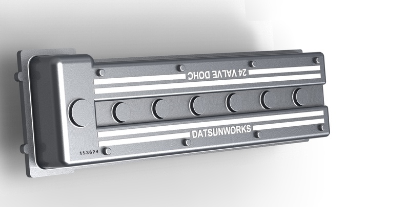

Twin cam head for the L6 from Derek at Datsunworks
...I'm trying to emulate the Nissan text from that era. And that was quite plain and blocky. I'm open to improvements on plain and blocky but it's going to be plain and blocky no matter what:)
I can do plain and blocky :), although I'd recommend varied font and font/size if you really want to match older Nissan motors. Even the S20 motor, which could be considered the closest cousin to your creation had a Serif font and an outline font (albeit blocky on both accounts).
Also, as far as I know, most Nissan motors said twin cam 24 valve, not DOHC. That's more of a Honda/Mitsubishi thing...

Thanks for posting that picture as it highlights why foundrymen (foundry persons) hate type. Look at the defects around the NISSAN. This is from the sand breaking when they remove the pattern. Or at least that's what it would look like if it was sand cast. I don't know what kind of numbers of S20's were being produced. It's possible that they were permanent mold but it looks like a sand casting to me. Serif type is even worse. If I do "DATSUNWORKS" in a serif the size of the serif is only .035".
Also the type style has to be a font that I have. And that means what ever is in windows 7.  I'm not going to get into vector drawing those many individual letters. I've done it on restoration projects but not on something like this.
Actually, production S20 cam covers were low pressure diecast. See photo of underside with splash cover removed.
I like the cosmetic 'defects'. I could have repaired/improved them, but chose not to. They suit the period, age and character of the car, I think.
Something to think about, perhaps?
Edited by HS30-H
Share this post
Yep that's a die cast all right!
If I was doing a restoration I would do a 3D scan and replicate it warts and all.  But I want a more refined look than 1970's production.
When I'm designing I know when I've hit the point where I'm happy with the look AND the part can actually be produced.
Because esthetic design is subjective it can alway's be better. But it may not be able to be produced.

Just as a heads up, If there is a font that you want that is not on your machine you can always add additional ones, most of which can be found for free on the web. :)

I can provide the vector files in a multitude of formats, should make importing the data to whatever you're using simple ... Just saying!
And I can provide the font files for future use.

I'm going to make the pattern as it is in post #361. But there is nothing stopping anyone from modifying it after the fact in a number of ways. Especially if your plan is to powdercoat. Raw aluminum is trickier because the modified area won't match the surface of the rest of the casting.
