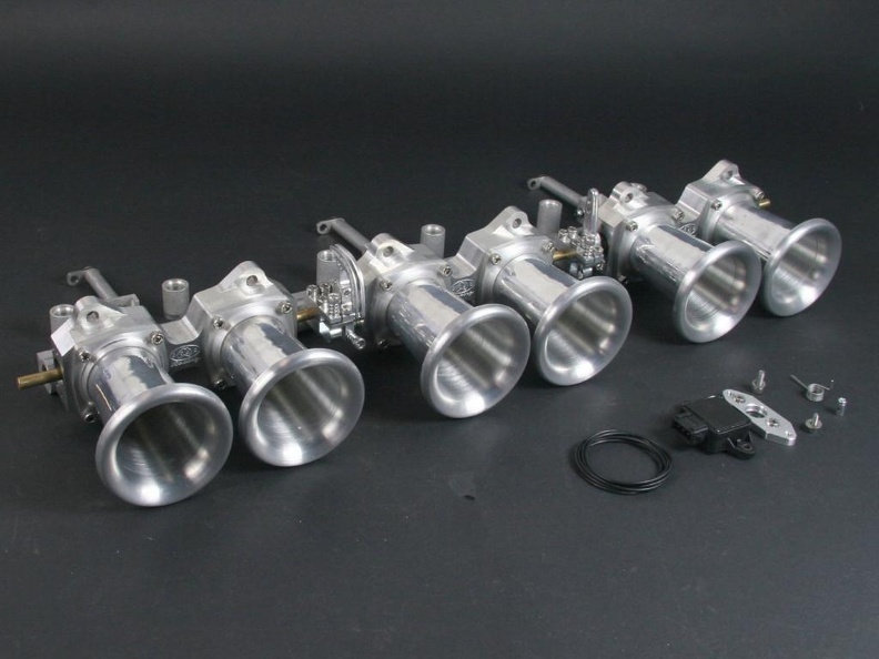

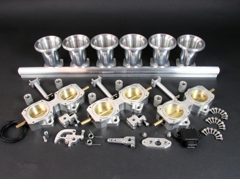

Derek Posted November 5, 2014 Author Share Posted November 5, 2014 (edited) Well just pulled the trigger on these: 50mm with 88mm horns. Got them from EFIHardware.com. I can't seem to find it listed on their site but I bought them from them on ebay. http://www.ebay.com.au/itm/6-Cylinder-DCOE-Individual-Throttle-Body-ITB-Plus-TPS-and-Fuel-Rail-Kit-50mm-/261574780258?ssPageName=ADME:B:BOC:AU:1123 They look to be really well made for the price. A lot cheaper than the Jenvey's and probably a lot better quality than OBX. They were recommended by 1vicissitude and considering what all you get for the price I really don't think I could do better. The intake will have injector bungs molded in so the lack of them in the throttle body isn't a problem. I really like that they use sealed bearings as opposed to bushings. They also use 6 degree butterflies which is another plus. I wish they were cast looking as opposed to billet but that's just me. I like castings:) Derek Edited July 7, 2017 by Derek Quote Link to comment Share on other sites More sharing options...
Xnke Posted November 6, 2014 Share Posted November 6, 2014 Do they come in 58MM???? If not...can you mod a set that large? Lemme know when yours arrive! Quote Link to comment Share on other sites More sharing options...
Tony D Posted November 6, 2014 Share Posted November 6, 2014 I have a set of their DCOE bodies. You will not be disappointed in them, they are very well made, high quality components from what I've seen on mine. Quote Link to comment Share on other sites More sharing options...

Derek Posted November 23, 2014 Author Share Posted November 23, 2014 Thanks Garvice Things are at a standstill for a bit as I'm swamped with regular pattern work. It usually slows up a bit this time of year so hopefully I'll be able to get back on it soon. I did receive the package from EFI Hardware and the stuff looks great. The only complaint I have (and I passed this along to them) is the edges haven't been de-burred. It makes a really well made piece feel kind of cheap. And it is well made. I'll hit it with a de-buring tool and all will be fine. Got a price for doing the head work. $1250 for seats,guides, deck and surface, multi angle valve job. This includes cutting the valve seat pockets in the raw casing. Another $550.00 to line bore the towers should I choose to go that direction. I have no idea if these are reasonable prices or not. Making progress on the modifications I need to make to my new (old) mill in order to do the machine work on the head. So things are happening just nothing particularly interesting:) Derek Quote Link to comment Share on other sites More sharing options...
