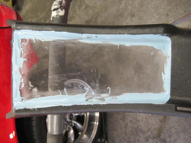

madkaw Posted June 22, 2015 Author Share Posted June 22, 2015 (edited) Well glad to see all the progress on the console, but doesn't help us BW t5 guys with fitment. Decided to just update my console with some fab work. Found some pretty cool plastic sheet at Lowes that is supposed to be pretty tough. I cut out the partition of the console that separated the shifter hole to the access panel for the fuse box. It was already busted from the T5 shifter smacking it around. Just cut out a piece of plastic and cut and melted it into shape. Found an old box of bumper repair stuff(6 years old) and it l was still okay. Works great as a glue and filler and what some are using to repair their dashes-like I did. Anyway, after some adjustments on console position I cut a hole for the shifter. Not sure if 'm going to run a leather boot or not. The t5 rubber doesn't look bad by itself. I eliminated the choke slot and I painted the console with Sems texture to try and duplicate finish. I painted it but I need to do some more coats. I will shoot some more pics when done. Edited June 22, 2015 by madkaw Quote Link to comment Share on other sites More sharing options...
