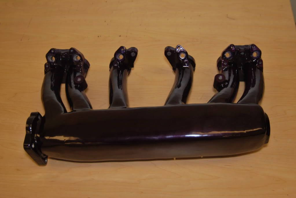

michael wales Posted February 22, 2015 Author Share Posted February 22, 2015 So I'm thinking after some discussions and looking at what I want from car at trying out the Arizona Z 4bbl intake but instead of the normal 390 carb using MSD's atomic EFI. The EFI is touted to work from 100ci to 500ci be it N/A or boosted and seems like it might let me run a similar setup as 280zex while cutting out the need to worry with carbs and letting me move into this cars fuel system into technology from at least my lifetime. I'm not hoping for the cheapest, most advanced or best anything really; just something that WORKS and works to my liking. As a street car I don't see how this system will not meet my needs other than being a bit pricy, but I figure my two sets of triples will help cover the cost. Any thoughts? I've seen some tidbits from OZconnection who seems to be the closest to what I'm going for but I'm excited for it to get warm so I can start making progress. I think I'll start N/A as I get some turbo parts together and build my 2.8 motor into something more suited to boost and maybe try my 2.6 at stockish boost levels if I can get everything together turbo parts wise before I'm done with the 2.8. Quote Link to comment Share on other sites More sharing options...

seattlejester Posted February 26, 2015 Share Posted February 26, 2015 Seems a bit convoluted to buy a carb manifold, then replace the carb with a TBI system. Why not just run an EFI intake manifold? Would save you quite a bit. If you want room to grow you can get megasquirt or another aftermarket ECU. I mean at 2300 for the TBI setup, and 400 I think for the manifold. That just seems like a lot of money. Quote Link to comment Share on other sites More sharing options...
michael wales Posted February 27, 2015 Author Share Posted February 27, 2015 If I decide to do any cam work ill look into Robello for sure thanks for the hands on info on their work. The TBI through the AZ intake boils down to the fact that Meqasquirt isn’t something I’m knowledgeable in or frankly interested in and the ease of the MSD EFI kit along with its great reviews intrigues me. I think the setup would look very clean and aesthetically I can’t say the same for the ZX setup and the webs of hoses it brings along. Lastly I can’t say that having something that will almost assuredly standout from the crowd doesn’t come into the equation either. Again I know it’s not the most economical or even best overall solution necessarily but it intrigues me and has me excited so I think I’m going to go with it. That being said I whole heartedly appreciate the inputs and advice, even if my not choosing to follow them leads you to think otherwise. Quote Link to comment Share on other sites More sharing options...
seattlejester Posted February 27, 2015 Share Posted February 27, 2015 I mean I'm not here to dissuade you, but to address your points... Regardless of the system you buy, you will have to either learn to tune it or find a tuner. You can shave the intake manifold, not anything new For the money you are looking at, you could even get a custom intake manifold. Your last point is completely valid, because it's different and a conversation starter/preference that alone is good enough justification. Good luck sir, keep us informed with how it turns out, been curious about the setup. Personally I think the triple webber carbs is a really good look. Quote Link to comment Share on other sites More sharing options...
michael wales Posted February 28, 2015 Author Share Posted February 28, 2015 i really like the triples myself looks and performance wise i,ve just never gotten around to learning the finer points of them and i figured since i had two sets and im personally more intrigued by EFI why not let them pay for my swap. MSD claims the atomic kit is complety self learning once youve inputted the basics such as engine size, basic cam profiel, etc and will even adjust to boost later on, that and its flexibilty engine size and power wise was what really sold me on it. its said to be a pretty painless experience and most of those comments were found on various discussion boards. ill be sure to keep you guys updated, hopefully this will give another option to those of us who want another way forward with a felxible EFI soultion. Quote Link to comment Share on other sites More sharing options...

seattlejester Posted March 3, 2015 Share Posted March 3, 2015 You hit the nail on the head, it is in reference to the self adjusting. I know hotrod has tested and left generally good marks, but they too had to call in for reinforcements and help to help certain situations. You will have to learn it at some point, or hire/employ/enslave/befriend someone who does know it. It is not just about the fact you should know what is in your car and be familiar with it in case of problems, but it is in that you should know the theory behind it to make the decision on how safe or how risky you want to push it. Tuner studio offers an auto tuning option on their software for the megasquirt as well, but you still need to play around with other settings like cold start, idle, etc etc. Even with the analyze live running it didn't catch certain problems I had and left some quirks here and there. It runs a very simple algorithm, up to the user to take advantage of that. The point of it is that if you are purchasing it to cut the need for a tuner out of the situation, that's probably not a good idea. The point behind it is that it is a stepping stool to make you into a basic tuner. You run the tuning program, tweak here and there, call support and ask questions, get suggestions implement, and in that front you end up learning. Believe their pitch that you bolt it on and you never have to touch it again maybe a bit on the naive side, granted it seems like they are trying to make it easier. 1 Quote Link to comment Share on other sites More sharing options...
Tony D Posted March 3, 2015 Share Posted March 3, 2015 "The point of it is that if you are purchasing it to cut the need for a tuner out of the situation, that's probably not a good idea." BOSS EFI out of Corona CA was the original manufacturer of these systems, and they CAN get pretty close... I was buffaloed by 'rah rah' articles in Enthusiast Magazines a couple of times where they say one thing and reality is something totally different. My Megasquirt fired right up and I could drive it around the block using the B&G 383 Chevy Fueling map on my L6. It goes to your definition of "works"... Every one of them has a protocol to save the file after your 'self-tuning drive' and you will have to learn that. Don't not prepare on basic knowledge based on a salesman's claim it will do it all for you... Never. Ever. Quote Link to comment Share on other sites More sharing options...
michael wales Posted March 4, 2015 Author Share Posted March 4, 2015 Well the MSD unit is on its way, I decided to pony up for the return kit as well to avoid some of the issues that seem to be present even with the pulse width modulated fuel pump. Apparently under certain conditions (hot summer days and the car is in Virginia..) the system is unable to compensate for the lack of cooling that the circulating fuel would provide vice a dead head system. All I am waiting for is for Arizona Z cars to get some more intakes in stock (they are saying early next week) or for one to come up for sale sans carb and a free weekend. Quote Link to comment Share on other sites More sharing options...
