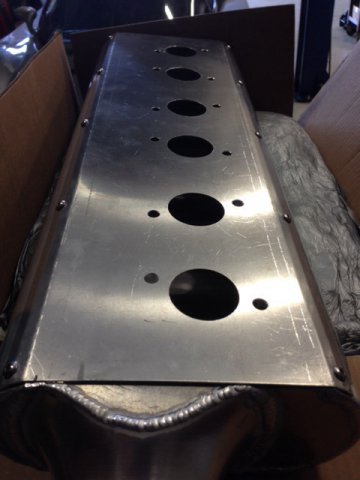

Hoover Posted April 15, 2015 Author Share Posted April 15, 2015 i have to figure out how to go from oval to round without too much fabrication. I don't have a sheet metal roller. if this was for a turbo car, i'd go a different route and use .25 extruded tube. maybe that's next. I just need to figure out how to make it seal and be removable like the hks surge tank. Quote Link to comment Share on other sites More sharing options...

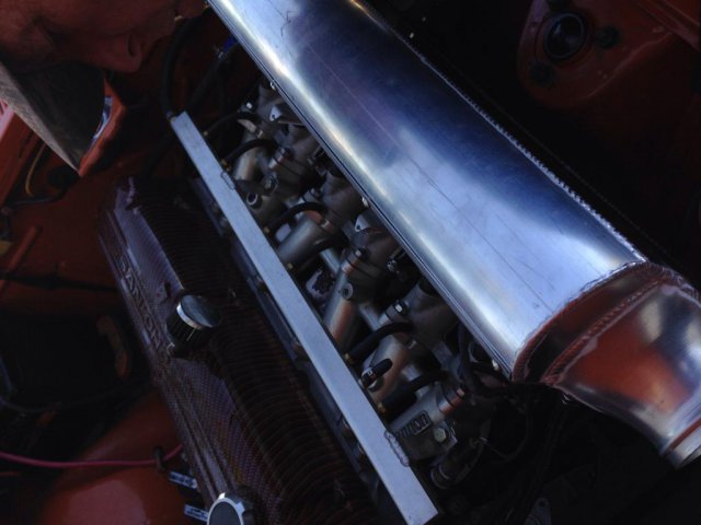

SleeperZ Posted April 16, 2015 Share Posted April 16, 2015 Nice intake setup! Fuel injected ITB, best flow. Quote Link to comment Share on other sites More sharing options...
Hoover Posted April 16, 2015 Author Share Posted April 16, 2015 thanks! I may build another one that's made for boost. Will install this one tomorrow and finish the intake with a velocity stack (if it fits) and cone filter. I didn't want to modify the front radiator struture opening and will just leave a filter shoved into the front corner of the engine bay. Quote Link to comment Share on other sites More sharing options...

Hoover Posted April 16, 2015 Author Share Posted April 16, 2015 (edited) thanks! I was just trying to find a solution to limit heat induction at the velocity stacks. The other problem area are the intake manifold runners being so close to the header primaries. The heatshields don't work when the hood is closed, that's why the OEM design is encapsulated. I may ceramic coat the airbox, intake runner and header, then insulate the header with inconel wrap which is amazing stuff. I'm going to datalogg the difference in intake temperatures during a simple drive on the street, freeway etc.....this will give us real world data. Edited April 16, 2015 by Hoover Quote Link to comment Share on other sites More sharing options...
Hoover Posted April 16, 2015 Author Share Posted April 16, 2015 measure twice cut one..... !#@$!@#$@!#%#$%$%#@$^@#^$ Quote Link to comment Share on other sites More sharing options...

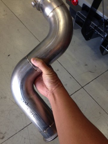

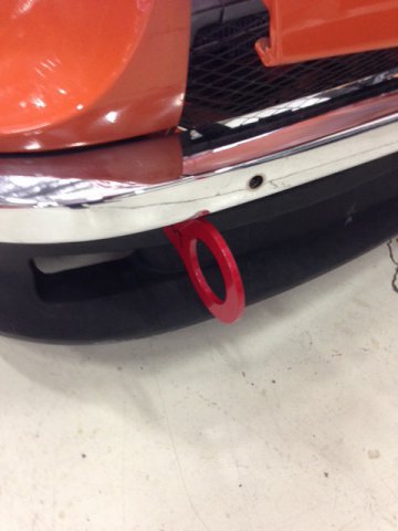

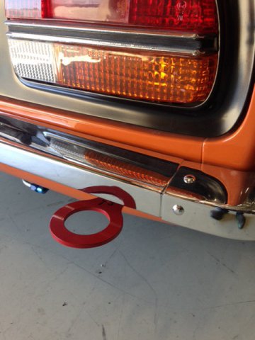

Hoover Posted April 17, 2015 Author Share Posted April 17, 2015 tow hooks installed, building another backing plate for ITB (measured incorrectly) and found a downpipe in a box..... If I go turbo, I can use this and get a head start.... Quote Link to comment Share on other sites More sharing options...

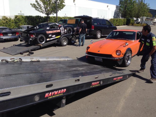

Hoover Posted April 18, 2015 Author Share Posted April 18, 2015 I've got a ton going on today. Decided to rebuild my race car and have the Z towed home. AAA pays off here! Quote Link to comment Share on other sites More sharing options...
