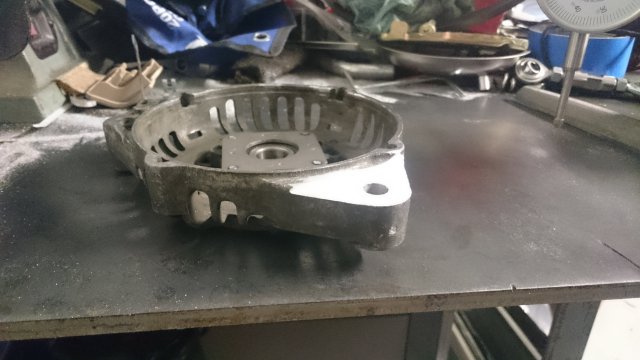

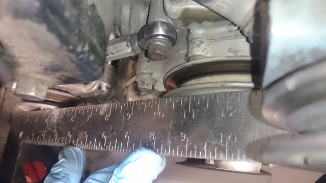

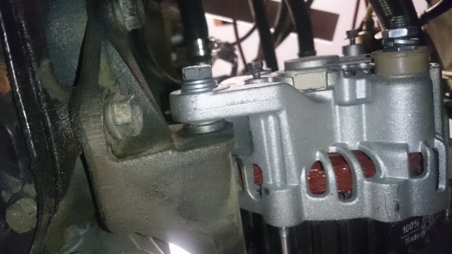

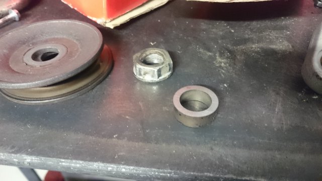

Decided this was a good place to post my Nissan Quest 125amp alternator swap. (around 5/2018)
The taurus fan was pulling too many amps, I had belt slippage issues when it would kick on and low voltage.

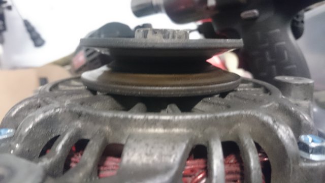

I used a file to flatten the top of the alternator casing to fit the v-band pulley.
Lapped the spacer down to get the pulley as close to the alternator face as possible.
It doesn't wobble even though I did this by hand.

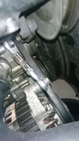

The vbelt was still significantly misaligned with the water pump & crank pulley, I had to cut the tab a bit to bring it into alignment again using a file.  not ideal but kept it flat enough to align properly.
Couldn't get the camera to focus properly on this one.
Added a spacer in the mount to compensate for the lost material.

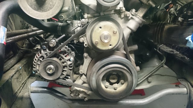

The result was good.
Checked alignment to the water pump pulley and the crank pulley.

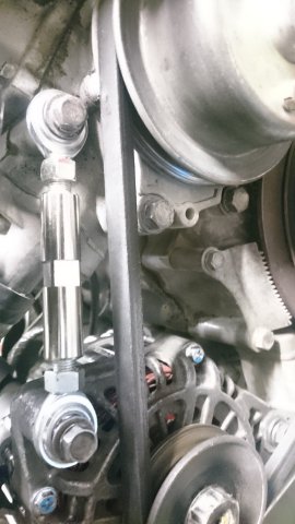

The setup now requires a shorter belt & adjustment rod.
I used a generic domestic alternator adjustment rod that comes with 3/8" rod ends and added bushings to drop down to 5/16".
Belt part number is an A34.
A43 belt works for power steering.
I used gates hi power belts, they're great.  they actually tighten up when they wear instead of loosening up.

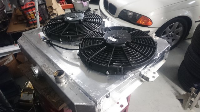

However this was only a band-aid to the real issue, which was that terrible taurus fan.
I swapped over to dual spal 12" fans, they flow about the same and pull a lot less current.

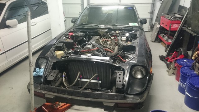

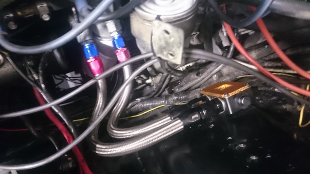

I also remounted the oil cooler right up against the radiator so the fans actually pull through it now, although oil temps aren't an issue I want to keep it that way.

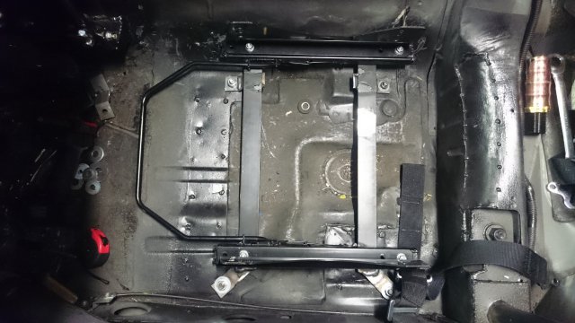

Finally centered and leveled my seat bracket properly

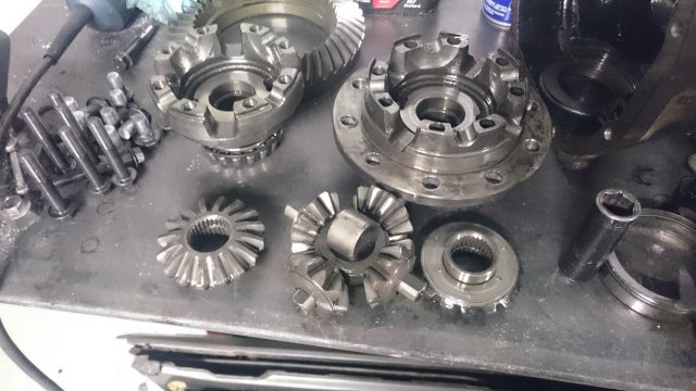

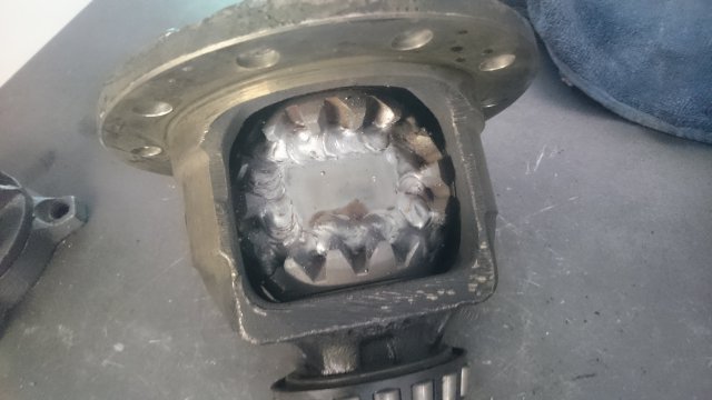

The M30 open diff is a very interesting design compared to the old R200's.

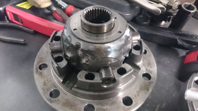

No matter, its metal and that means it can be welded.
As I've started plate welding diffs, I added some small plates inbetween the gears as filler material.  The carrier will split in half before this breaks.
Here's an S13 diff I did not long ago, you can see its much stronger than the first one I did on my car.

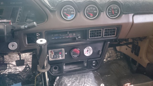

Details are important.  Added a gauge panel to fill the empty hole in the center console, as well as house my chippernut shift light.
After adding an oil temp gauge worrying that my oil temps were too high, I actually came across the opposite issue.
My oil temps were actually too low cruising on the highway, so I added an oil thermostat.

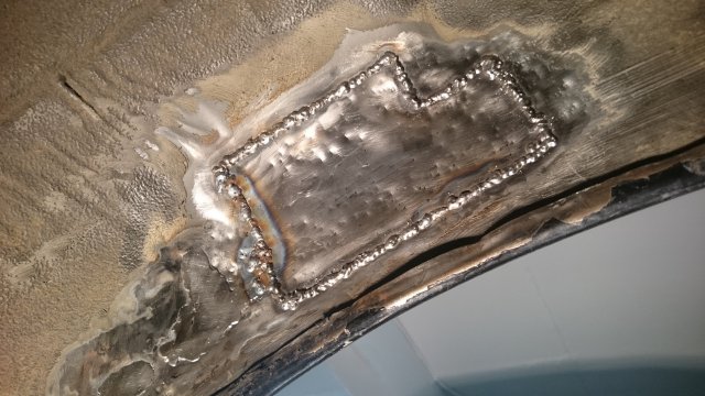

The ZX has a strange notch sticking into the rear arches, I don't like tires rubbing so I cut it out.
Don't mind the booger welds... I ground them back after :(

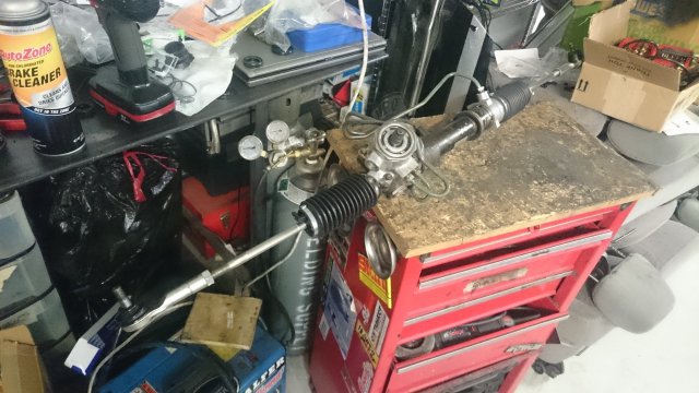

With a rebuilt rack after the failure at my last Thunderhill west event 9/23/2018 I rebuilt my power steering with all new seals.
The pump was also rebuilt including a very expensive OE reservoir cap to fix all my leaks.
On returning to Thunderhill west a couple weeks ago on 3/17 I show up to the track, turn my car around in the pits to unload my track gear and there's a puddle of ATF on the ground.
The rack blew out before I even got it on track!
The driver side boot was full of ATF, same side that failed last time.  Unfortunately with the smog test due and some other personal things getting in the way I have no time to fix until later next month, I'll be recording here and hopefully finding a mistake in the rack rebuild that caused the seals to blow out again.
I still ran on track, just removed the PS belt & drained the rack.

The steering rack issue ended up just being a small installation oversight due to the way I put the center seal in, I had pushed it over the gear and it cut the seal.
I assembled the rack from the other side of the main shaft and was able to get everything to seal up no problem.

I lost a bunch of pictures from recent work when my phone died, but here's a brief update.
When I slapped in my cam in a few months ago before the Buttonwillow event I also installed a new Powerbond crank damper PN# PB1212N.
Last weekend I went to check the timing after my dizzy cap screw backed out and couldn't find the crank mark.
Pulled everything apart and re-checked the balancer against a degree wheel, the outer ring has rotated by about 35 degrees.
I bought the new part because I was afraid of the 40 year old factory unit slipping!
During disassembly I found that my new aftermarket engine mounts are also starting to fail again.
Going to just order up some OEM nissan units, the original factory parts never had issues.
Annoying to still struggle with reliability at this point, but at least there's less things to fix at this point.
After ignition issues at Buttonwillow I realized I simply hadn't changed my dizzy cap & rotor for several years!
Finally took the time to finally install these Accel 8.8 plug wires that have been sitting on the shelf for over a year.
Really can't tell if they've helped anything, but they look good.
As it sits today, waiting for the decision on what crank balancer to go with.

Looking at your video it looks like you are still running a locked diff which will be jerky in corners and not give a smooth drive transition like a really good clutch type LSD will. OS Giken FTW.
Getting a 280ZX track worthy is a huge job so well done there, the 280ZX is one of those in between cars, still old school and lacking in powertrain development that benefited later model Z's.
  • 2 weeks later...
260DET, thanks for the comment.
I'm still running a locked center, and really can't justify the expense to upgrading to an LSD for this car since I'm not doing any level of competition.
A huge contributor to the high speed instability is the alignment settings, my last alignment was optimized for drifting and was almost ideal for that purpose.
An LSD has been on the list for a long time, but with how beat up this chassis has gotten over the years I'm starting to only do the maintenance required to get as much seat time as possible rather than upgrades.

Cooling is still an issue, typically Its creeping up to 220* water temps after a hot lap session.
I'm currently working on a few more maintenance bits and optimizations, going to be on thunderhill 3 mile in a couple weeks with SpeedSF.
