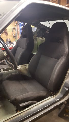

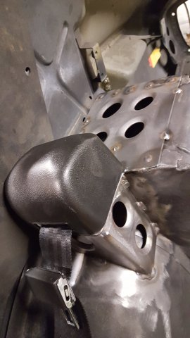

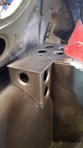

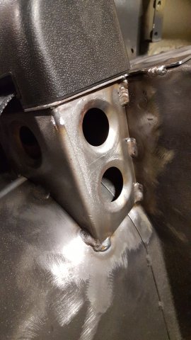

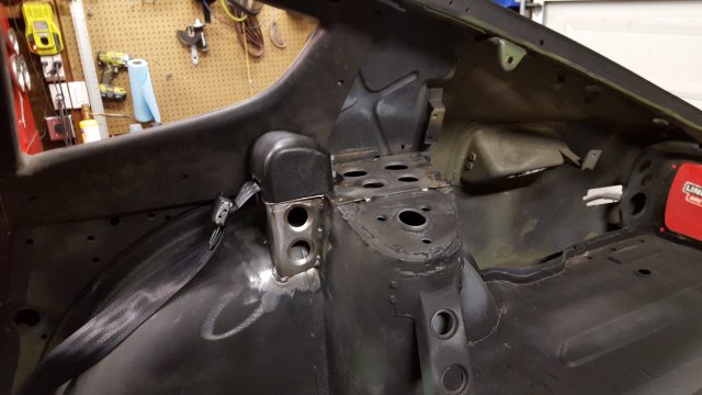

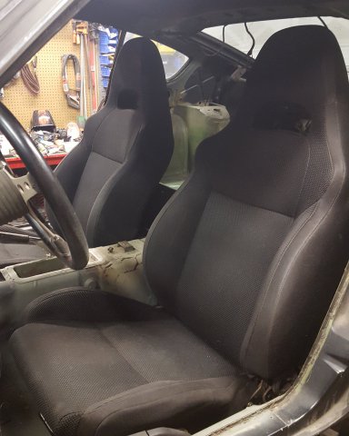

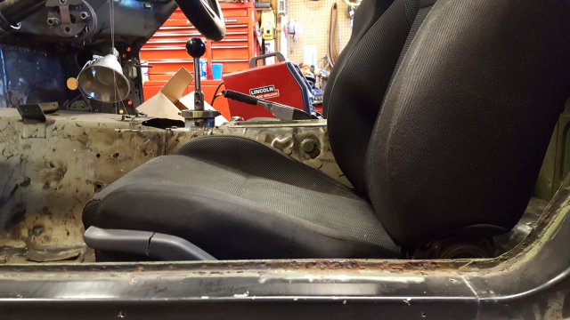

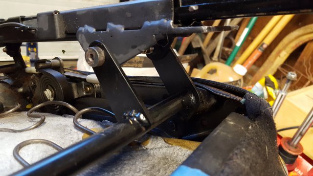

LLave Posted July 20, 2018 Author Share Posted July 20, 2018 Closing the loop on this one. I finally got this all sorted. I ended up with 2004 WRX seats, modified to fit in the Z while retaining the adjustable height mechanism on the driver side. I picked up a set of Wesco roadster retractable seat belts. Designed and built a little mounting pad on the rear strut tower. Seems to all work pretty well. Mildly interesting pictures: Quote Link to comment Share on other sites More sharing options...
Evlevo Posted July 21, 2018 Share Posted July 21, 2018 That seatbelt mount looks damn near OEM. If i didnt know any better id say it was. Good work! Bookmarked for when i get around to the seatbelt point of my build. Must have been in a different seat thread, but last year i posted a picture of 2010 wrx seats in my z. IIRC they are slightly narrower than the stock z seat and fit quite well. Quote Link to comment Share on other sites More sharing options...
LLave Posted July 22, 2018 Author Share Posted July 22, 2018 On 7/21/2018 at 12:46 PM, Evlevo said: That seatbelt mount looks damn near OEM. If i didnt know any better id say it was. Good work! Bookmarked for when i get around to the seatbelt point of my build. Must have been in a different seat thread, but last year i posted a picture of 2010 wrx seats in my z. IIRC they are slightly narrower than the stock z seat and fit quite well. Expand Thanks man. Upgraded OEM is sort of what I am going for. Quote Link to comment Share on other sites More sharing options...
