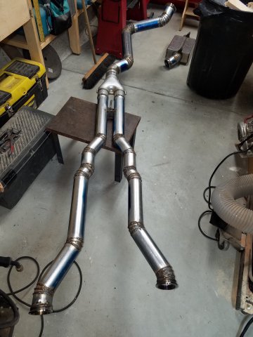

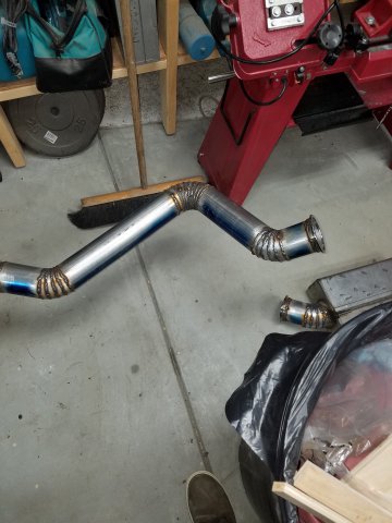

Looking through my build thread here, it’s looks like I have added much of what I’ve been doing. Thought I’d toss up a pic of my exhaust. It’s dual 2.5” to a single 3” to a single Spintech muffler. Now that it’s running I’m pretty happy with how it sounds.
