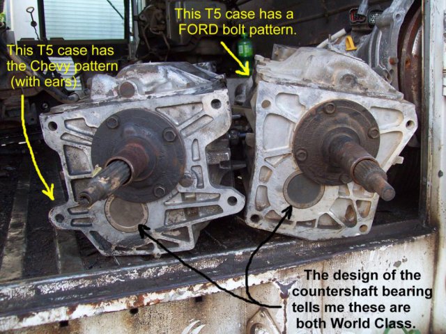

rajien2 Posted September 16, 2015 Author Share Posted September 16, 2015 Hey guys thanks for all the information, I might come off as wanting to make the car just like the rotsun however I really just like the turbo aspect. I have the JTR manual on its way now, I hope to have it by friday and start diving into some details. Now the part about the manual transmission not being very well explained makes me a little nervous... However I have done some reading that using a T5 from a mustang is a good way to go, can anyone confirm this? Thanks Cody Quote Link to comment Share on other sites More sharing options...
R3VO 3VOM Posted September 16, 2015 Share Posted September 16, 2015 (edited) Not from a mustang. From a V8 Camaro. Difference is the bellhousing pattern and subsequent matching case pattern. V8 Camaro T5 bolts on. Mustang T5 you'll need an appropriate clutch disc and either an adapter to use a chevy bellhousing or an aftermarket bellhousing that's drilled to accept the mustang T5 pattern. Now there is talk of rare bellhousings that allow mustang T5 trans to bolt to a chevy pattern engine (I think they were "ironduke" jeep housings but not 100% sure) but these are hard to find. Just going Camaro T5 makes your life easy with the swap. V8 Camaro T5 is what JTR recommends for a manual swap. Edited September 16, 2015 by R3VO 3VOM Quote Link to comment Share on other sites More sharing options...
rajien2 Posted September 16, 2015 Author Share Posted September 16, 2015 Oh very cool thanks that would have been a big pain! Ahhh alright so what im gathering... Just go buy a complete V8 Camaro and just sell the shell later. Quote Link to comment Share on other sites More sharing options...
