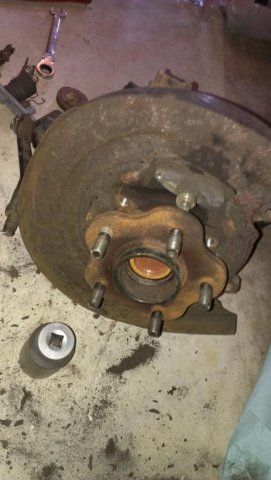

As the title implies attempting to remove the rear hub assay from the backing plate. Got my axles, R200 and brakes dismounted but this is not coming off. Any bright ideas are welcome. See photo attached (it's borrowed but mine looks exactly the same).

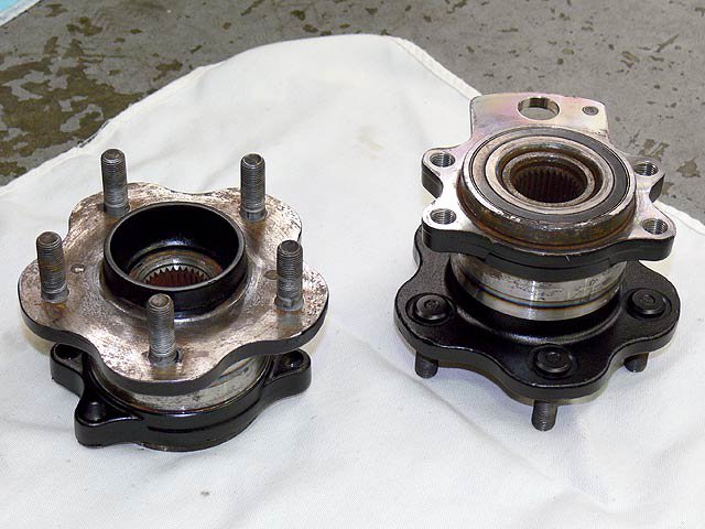

Looks the same as the Z32 rear hubs. When I took mine apart, getting those 4 bolts out was pretty hard. I had to fabricate a long bar to hold the backing plate, then use a long extension on a breaker bar. Once those 4 bolts were out, it pretty much jiust fell apart.
Should have been more specific... I fail. The bolts came out like butter with an impact gun. The rear portion of the hub assay is stuck inside the backing plate. I knew I should have posted a photo of my own.
I've tapped from the axle side and tried using a three jaw puller to "push" it out.

I claim victory... I used a liberal amount of Kroil, then a 1/4" steel disk that I put in the back of the hub followed by locking the 5 ton puller over it and driving it with my Milwaukee 300 ft-lb impact wrench. Just went *ping* and popped right out.
