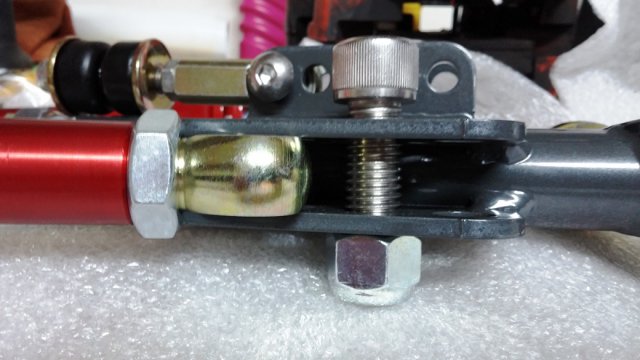

I am just posting a couple pictures of T3's GTX2 control arm and T/C rod package that I just received.  There were some concerns in two threads Here and Here as well regarding how the T/C rod connects to the arm.
In T3's pictures (seen Here), you can see a rod end where the T/C rod connects to the arm and it can pivot about the connection.  As shown in the two photos below, that has now been changed to a solid rod end that has a tight fit between the brackets.
I am going to call T3 in the morning and suggest they update the photos, as the posts above as well as the old photos might "scare" away potential customers.

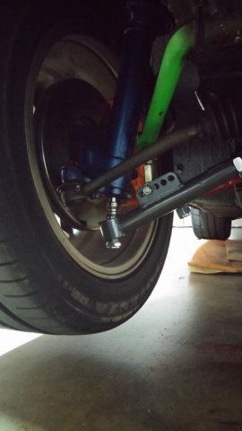

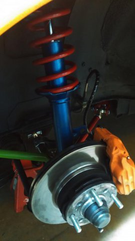

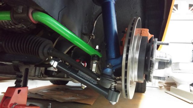

Pictures as promised.  I am running 16x8 +10 wheels with a 10mm spacer in the front. I installed the bump steer spacer which helped to raise the lower portion of the "ball joint" spindle by approximately 23 mm (per T3's website).  I have around 25 mm/1-in. of clearance between the bottom of the spindle and my wheel.
