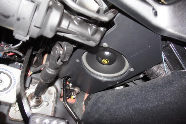

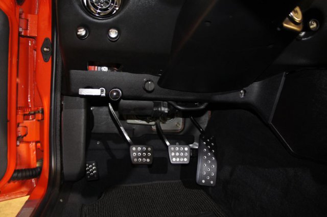

TimZ Posted January 2, 2016 Share Posted January 2, 2016 (edited) I took this quick cell phone pic today to document the Performance Pedals but noticed that you can actually see the motor to the ZPower Steering unit protruding slightly below the edge of the dash board (silver bulk). It does not impede your feet from acting on the pedals but illustrates the limited space available for this install (at least in my 1978 280Z). I will be painting the unit black to make it less conspicuous. 20151215_174134.png Sorry - I've been meaning to respond to this for a while and kept forgetting. If you clock the motor 180 degrees from the way you have it, the motor will sit higher and be out of sight. It's kind of a tight fit, but it can be done, even with the factory AC: Also on the 78 Z at least there was a speed switch built into the speedo that was used for emissions purposes with the manual transmission models. It changes states at around 10 or 15 mph. I used this switch to power a relay that switches in different resistance values for the assist level adjustment - I get higher levels of assist at low speeds and lower assist levels once I'm rolling. The controller that they use seems to filter the transition, so the change in assist level isn't obvious. I _really_ like this setup - it's one of the best mods I've done to this car! As someone else already mentioned it does take more than just a couple of hours to install, but you can still do it easily in a weekend, and it's WAY easier than trying to figure out how to mount a PS pump, get a belt to it, retrofit a rack and plumb the hydraulics! Edited January 2, 2016 by TimZ Quote Link to comment Share on other sites More sharing options...
dmoralesbello Posted January 3, 2016 Share Posted January 3, 2016 Interesting TimZ. Let me take a look at my set up again and look for the reason why I didn't locate the motor on the other side of the steering column but I do remember that the placement I decided upon was based on the easiest fit. I'll let you know. Thanks for the idea. Quote Link to comment Share on other sites More sharing options...
TimZ Posted January 3, 2016 Share Posted January 3, 2016 (edited) Interesting TimZ. Let me take a look at my set up again and look for the reason why I didn't locate the motor on the other side of the steering column but I do remember that the placement I decided upon was based on the easiest fit. I'll let you know. Thanks for the idea. At first it doesn't look like it will fit the way I mentioned, but it will! Edited January 3, 2016 by TimZ Quote Link to comment Share on other sites More sharing options...
dmoralesbello Posted January 8, 2016 Share Posted January 8, 2016 TimZ, I looked at my set up yesterday as I was looking for a space to mount two 5 1/4 speakers under the dash. I suppose you are correct and the unit could be rotated 180 degrees and placed to the right of the steering column but I couldn't wedge it much higher than on the left side so I left it where I had it (left of the steering column). Once painted flat black it's virtually unseen and I'm in the process of fabricating ABS panels to mount a speaker in the space to the right of the steering column (see 280Z Restomod Progress). Quote Link to comment Share on other sites More sharing options...
dmoralesbello Posted January 10, 2016 Share Posted January 10, 2016 Here's a pic of the final look of the ZPowersteering unit install with the motor to the left of the steering shaft, painted flat black and I still had enough space to mount a speaker panel to the right of the steering column. I will also add that I'm getting more accustomed to the feel. 1 Quote Link to comment Share on other sites More sharing options...
