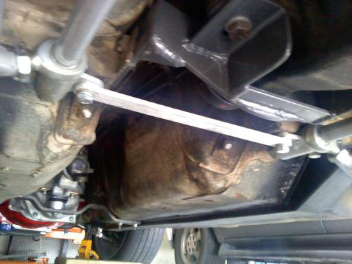

hornedcow Posted September 21, 2016 Author Share Posted September 21, 2016 The differential mounting bushings were the root cause of the noises I was hearing. What was making the noise is kind of scary. The pinion (and thus the driveshaft) were lifting up several INCHES and hitting the parking brake equalizer on the bottom of the body. The rear of the differential is solid mounted to the 1/2" thick billet mustache bar through 2 studs on the rear differential cover. I cannot believe that those parts would flex as much as they did. I'm sure if I attempted WOT I would have broken something, either the diff cover, mustache bar, or the mounts for it.Anyway, I'm a little miffed that I missed those bushings but I'm glad their catastrophic demise didn't seem to cause any other issues. I had some energy suspension urethane bushings shipped in, since literally every other bushing on the car has been replaced with such. Went for a little test drive down my street and no more noises! Woohoo!Side note, air chisel was worth every penny to get the old bushing shells out. Screw doing that any other way.I've got a few minor things to button up and I can start driving around on the street for some real testing. Quote Link to comment Share on other sites More sharing options...

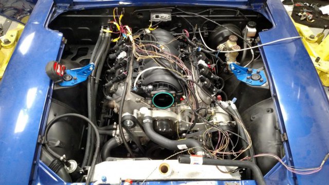

hornedcow Posted December 13, 2016 Author Share Posted December 13, 2016 Working more on it. Completed the belt drive and intercooler mounting and plumbing. Just electrical, PCV, and tuning to do. Quote Link to comment Share on other sites More sharing options...
