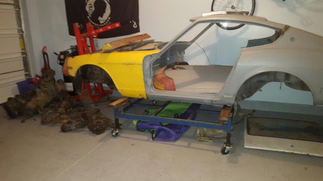

240Zdan, have you done any research into Techno Toy Tuning? I am looking at coilover systems as well as new suspension in general as my car is a shell currently. Trying to get a feel for where my money would best be spent on a street car/potentially light track use application. I have looked at Bilstein, T3, and AZC and they seem to be the best 3 options. Just trying to get someone to give some insight into their respective performance.
I appreciate your feedback on Megan products, I have seen some of their stuff and wouldnt have been able to tell they they are inferior products.
This is how my project currently sits.
Share this post
