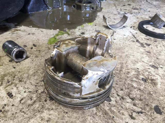

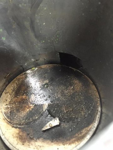

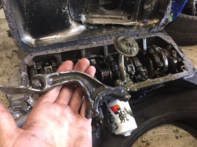

budgy Posted September 19, 2016 Share Posted September 19, 2016 (edited) Decided I would start a thread to chronicle some of my build so I can look back and remember the fun I had doing this. ZFever has harnesses for the VQ37HR working great with Osiris/Uprev which makes this swap a reality now. Got a few pictures as the car is now, I blew up my 3.2 stroker build not long after that action shot was taken. Block I believe failed due to heat stress. Got some pics of that aftermath, I thought the engine would just run cooler if I dumped a ton of coolant into the crankcase. Blew off a PCV line and had a crazy amount of vapour pour out of the engine bay on the track. Got my heart pounding This engine actually still started and ran by the way! I have a collection of parts coming in soon, but will try to make large updates rather than a ton of small ones over the course of the winter. Found an excellent shop to do paint/body and most all of the work will be handled by professionals, I really don't have the time to do this kind of project on my own. But many props to those of you that make the time and do it all on your own. Will have turn signals, and even a CEL. The redline on the reflash will actually be set @ 8100RPM, but not sure I will need to go past 8 so I am happy with the look of the tach, the 10K tachs to me I do not like the spacing as much. These gauges were a design that I basically copied/inspired from the AWR guages made for Miatas. Edited September 19, 2016 by RB26powered74zcar Quote Link to comment Share on other sites More sharing options...

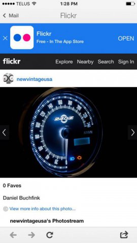

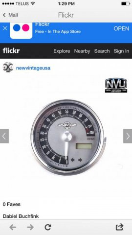

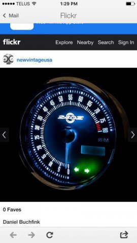

budgy Posted September 19, 2016 Author Share Posted September 19, 2016 Not sure what happened there, Flickr is usually safe for me. Screenshots are the next best thing; custom gauges by New Vintage USA. Redline is actually 8100, but I like the way the 8K spacing works over 10K. doing custom tach redline would have added significantly to the cost. These were not cheap but I am happy I did them seeing the night time shots. Quote Link to comment Share on other sites More sharing options...

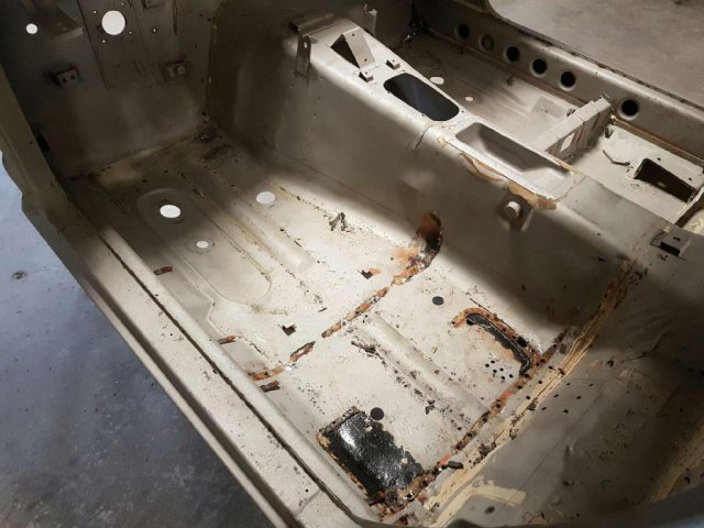

budgy Posted February 7, 2017 Author Share Posted February 7, 2017 Getting sent off for water/media blasting soon! Quote Link to comment Share on other sites More sharing options...

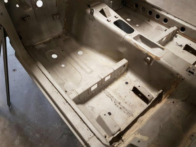

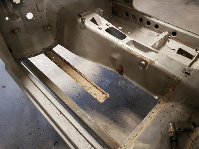

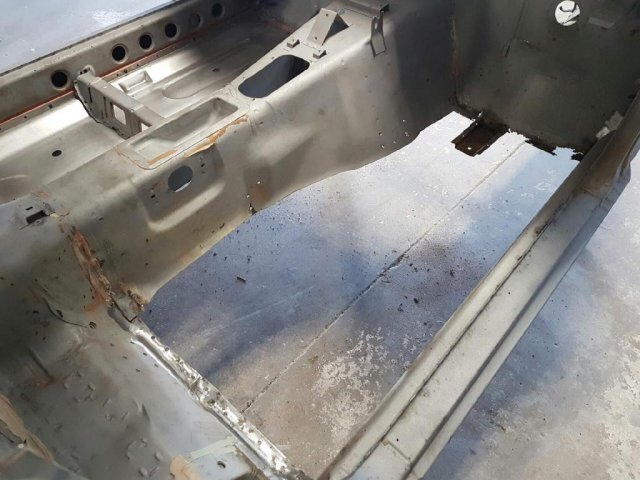

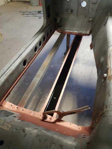

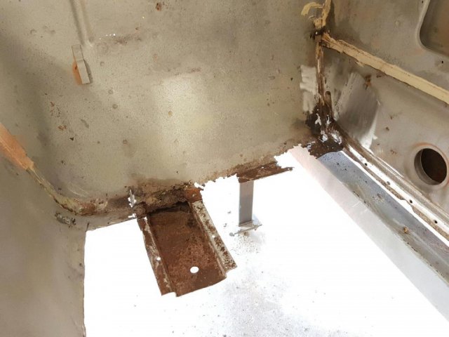

budgy Posted February 14, 2017 Author Share Posted February 14, 2017 (edited) Typical Datsun stuff, hopefully its not too bad to fix behind the battery tray that thing is a nightmare.Hoping I get mounts and headers from McKinney soon so it doesnt hold things up before body primer.Drip rails very disappointing to see what was basically just flat steel welded in before. A whole new 'C' shaped piece will have to be made and welded into place. Edited February 14, 2017 by budgy Quote Link to comment Share on other sites More sharing options...

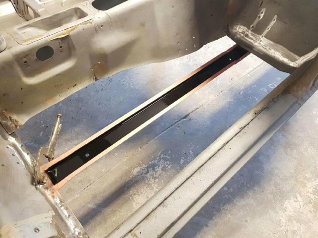

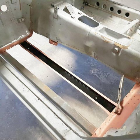

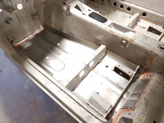

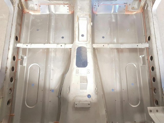

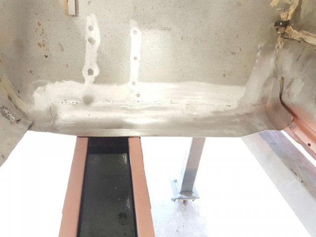

budgy Posted April 12, 2017 Author Share Posted April 12, 2017 Progress! Something very satisfying about seeing the rust that was there and now gone! Quote Link to comment Share on other sites More sharing options...

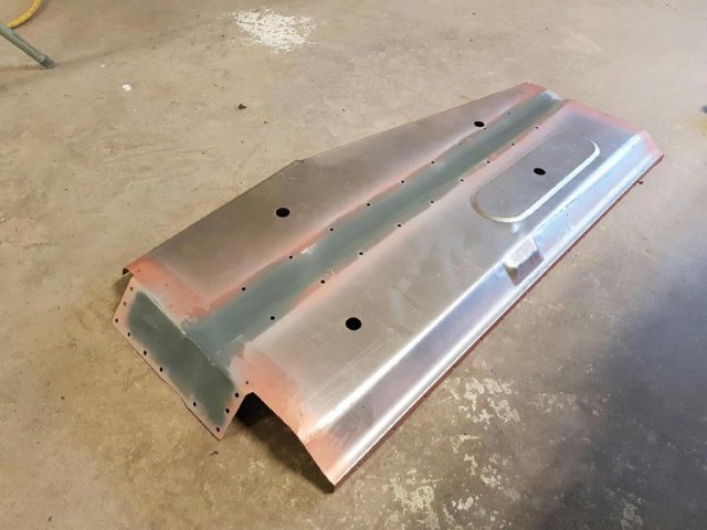

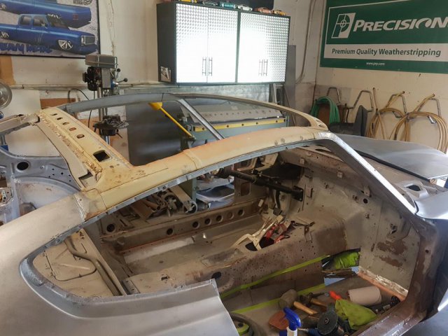

budgy Posted July 11, 2017 Author Share Posted July 11, 2017 (edited) Decided to get rid of the aftermarket sunroof for the cleanest possible look. Removal of factory drip rails was poorly done. Got a fair bit of metal work to do before she goes into primer, but things are finally about to start moving forward more rapidly. Wanted to share a photo of a truck that was painted the same way my car will be. It's why I chose this small shop, guy does excellent paint and body work. Edited July 11, 2017 by budgy Quote Link to comment Share on other sites More sharing options...
