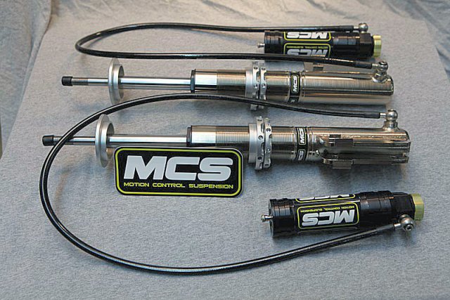

But I would love to get to the stage of having something like MCS Remote double adjustables.
I've been trying to see if this has been done before, sure it has but cannot find.
I can see cutting the strut tube down to about a 2" stub.
Then machining and welding a sleeve down into that stub (to assist getting the position and angle correct).
Then transitioning to a beefy steel stub to which basically standard type fancy shocks could be bolted.
Keeps the strut arrangement and gets a better shock.

I'm figuring this will be a $6k+ set of shocks.  The real deal... so not doing this part on the cheap.
I just sent my Koni 8611s back for a dyno inspection and they got a clean bill of health.
All the M3 guys I race with are running MCS remote resivoir double adjustables.  They have triple adjustables but they are a lot more.
I've been working with MCS and they can build a custom solution in the $6k range (plus or minus, likely plus tho).
Not a bad price really...
