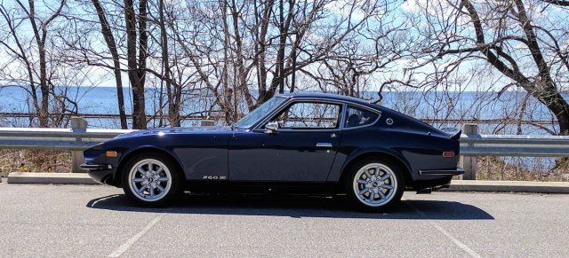

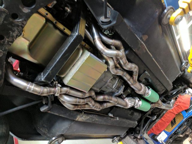

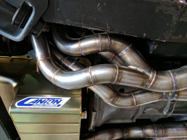

thedarkie Posted April 6, 2017 Share Posted April 6, 2017 (edited) I've had my 260Z for about 6 years now with a mild Ford 302 that was getting tired and boring, so when an interesting engine came up for sale I impulsively jumped on the deal. Its still Ford Windsor based and I figured would be a relatively straight forward drop-in, but small differences tend to claw away at the bank account QUICK! The heads had taller and bigger exhaust ports, so custom headers had to be made... the engine was lacking a mechanical pump, so the fuel system had to be upgraded, the old distributor and ignition was incompatible with the new roller cam so MSD took a bunch of my money. The $1000 oil pan it came with wouldn't clear my crossmember, etc etc. updated pics from Apr 17 Anyways, I just fired it up for the first time 2 days ago and took it out for a shakedown around the neighbourhood today....... and its already painfully evident that this car, in its current configuration, is stupidly overpowered. I've always loved how aftermarket flares and wide wheels look, but my car is too clean to go under the knife so now I'm basically shopping for as wide a tire as I can fit on these wheels, under the stock fenders. I might luck out with a 225 or 235 in the rear, so it'll need to be something very sticky. Slicks?!?! It never sees rain, hmmmmmmmmm! New engine is in. Its an SBF based Dart block with 4 bolt mains, Diamond pistons, H beam rods, TFS-R heads, and some other goodies. I decided to keep it carb'd despite the new engine coming with a lot of EFI parts - maybe I'm stupid, but I just think it helps maintain some "old school" character. 4 mpg? Who cares If you're having headers made, might as well give the fabricator some creative freedom and see what comes out! He absolutely killed it. Its such a shame its basically almost entirely hidden under the car. Im gonna have to buy some mirrors or cut a hole in my floor so I could look at them while driving. 1-7/8 primaries 4-2-1 into a single 3.5" back section I guess its still a muffler? More like a Coke can.. added just for good measure, in case the system was too loud. It sounds amazing.. not a muscle-car 'hollow' rumble, but kind of an exotic bass feel to it. Very happy with how it turned it, which was essentially a guess. Edited April 19, 2017 by thedarkie Quote Link to comment Share on other sites More sharing options...
rturbo 930 Posted April 6, 2017 Share Posted April 6, 2017 What suspension do you have? With coil overs and rolled fender lips, you should be able to squeeze a 275 under the stock fenders in the rear. You'll need to go to a 17" or 18" wheel though. How much power does it make? Some chassis reinforcement might be needed, although your subframe connectors will help with that. Those headers look pretty wild. I think we need a sound clip. Quote Link to comment Share on other sites More sharing options...
seattlejester Posted April 6, 2017 Share Posted April 6, 2017 ^Seconded on the sound clip. I appreciate the work involved in those headers as well. Made sure to give himself enough room to weld all the way around or made them all equal length. Depending on how attentive he was and which cylinders he matched before merging it could give a more flat plane sound then the traditional cross plane. Quote Link to comment Share on other sites More sharing options...
Chickenman Posted April 6, 2017 Share Posted April 6, 2017 (edited) Lot of guys in the PNW are running DOT- R compound tires on the street. Yokohama 048 or 050's are very popular. These are very lightweight cars with some pretty good power to weight ratios. Turbo guys are pushing 250 to 275 RWHP in 2,000 lb cars. BFG rivals are also a very sticky tire and come in lots of sizes. Looks like you're running some sort of 3 season tire now? DOT -R compounds will make an amazing difference. Some of the DOT tires are " Cheater " sizes. So a 225 is more like a 235 or 245 in actual width. BTW, Toyo R1R's are really sticky and really wide for their stated size. The 245/40x17 should handle your Power without having to cut the sheet-metal. They have a lot of sizes in this tire. It's often overlooked Edit: What size rims do you have now? Edited April 6, 2017 by Chickenman Quote Link to comment Share on other sites More sharing options...

ryant67 Posted April 6, 2017 Share Posted April 6, 2017 I just bought a set of 225/50r15 Toyo R888R's, which is the new version of the old R888. They are supposed to be better in the wet, and are still 100 treadwear. Should be plenty sticky, and still reasonably practical for the street - at least as practical as r-comps can be anyway. If you are in the Toronto area, I found these guys unbeatable on price: http://www.greenleaftire.ca/track-and-competition-pricing.htmlYour car looks great by the way, wow!!! Quote Link to comment Share on other sites More sharing options...
thedarkie Posted April 6, 2017 Author Share Posted April 6, 2017 On 4/6/2017 at 2:51 AM, rturbo 930 said: What suspension do you have? With coil overs and rolled fender lips, you should be able to squeeze a 275 under the stock fenders in the rear. You'll need to go to a 17" or 18" wheel though. How much power does it make? Some chassis reinforcement might be needed, although your subframe connectors will help with that. Those headers look pretty wild. I think we need a sound clip. The suspension is from AZCar, their tubular arms and coil over setup. I think you're waaaaay optimistic about how much meat I can fit in the back, 275s seem out of the question. I really like my fitment right now so I'll try to measure how much more space I have to the spring. I'm guessing a 245 might be about max?? I wanna stick with 16s also. As for power - I hate to guess, but similar builds are easily 500hp at the crank so I guess thats one goal to aim for. On 4/6/2017 at 7:42 AM, Chickenman said: Lot of guys in the PNW are running DOT- R compound tires on the street. Yokohama 048 or 050's are very popular. These are very lightweight cars with some pretty good power to weight ratios. Turbo guys are pushing 250 to 275 RWHP in 2,000 lb cars. BFG rivals are also a very sticky tire and come in lots of sizes. Looks like you're running some sort of 3 season tire now? DOT -R compounds will make an amazing difference. Some of the DOT tires are " Cheater " sizes. So a 225 is more like a 235 or 245 in actual width. BTW, Toyo R1R's are really sticky and really wide for their stated size. The 245/40x17 should handle your Power without having to cut the sheet-metal. They have a lot of sizes in this tire. It's often overlooked Edit: What size rims do you have now? They're 16" panasports, Im not sure about the width but they may only be 7.5" so Im super-limited with what rubber I can throw on there. I'm really not wanting to change the wheels, so I'll just get the stickiest widest rubber these wheels will support. R-compounds might have to do the job. R1Rs were on my radar - hopefully I can find a shop that would let me mount a few different sizes on my wheel for testing. Like you said, some of them are wider than others so an extra wide 225 might even be too much for my wheel to handle. On 4/6/2017 at 8:03 AM, ryant67 said: I just bought a set of 225/50r15 Toyo R888R's, which is the new version of the old R888. They are supposed to be better in the wet, and are still 100 treadwear. Should be plenty sticky, and still reasonably practical for the street - at least as practical as r-comps can be anyway. If you are in the Toronto area, I found these guys unbeatable on price: http://www.greenleaftire.ca/track-and-competition-pricing.html Your car looks great by the way, wow!!! Let me know how the 888's work out for you - though with this weather I doubt you'll be doing much driving yet do you take yours out in the wet? Thanks for the tip on that shop, yeah Im in the Toronto area so I'll definitely give them a shout when I start shopping tires. You ever drive out this way with your Z? Quote Link to comment Share on other sites More sharing options...
