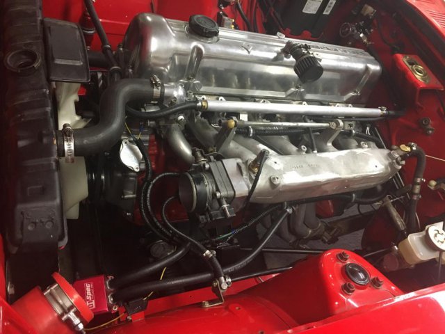

What year 240sx TPS on L28 engine?
turbogrill
Not really most tb out there are dslots and if he's not changing linkage to other side should still open clockwise. And even then most standalone can calibrate a TPS sensor. Go with 92 from automatic, keep in mind you won't use the 3 pin sqaure plug that looks like the fuel injector rather the 3 pin with rounded corner. Should come off TPS with a little pigtail.  Also you might have to re drill the mounts / ears according to what I read I didn't cause I changed the whole throttle body to a 240sx unit with spacer ofcourse
