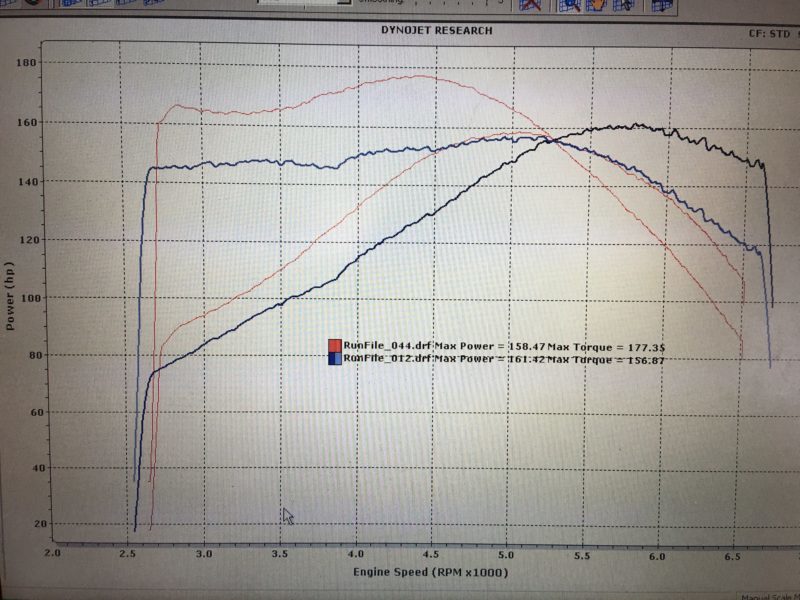

Kirkster Posted August 10, 2017 Share Posted August 10, 2017 Ok, Brief background. First Pull is from a few years ago with the group buy SENZA PARI intake. We figured the short intake runners killed the Torque on the motor. Second Pull is from this spring with a rebuilt .40 over motor as the old motor dropped compression on the #4 cylinder and had to be rebuilt. The motor is an N42 with N42 head and is completely stock with the exception of the .40 overbore. We are readying a new intake which will be port matched to the head and also will have had the runners opened up. The big issue we have with the current intake is this is a webbed EGR intake and the intake log is necked down for the last 2~3 cylinders and we are not sure if that is impacting the flow. So we are going to a non webbed non EGR intake that is the same diameter the whole way down the log. The real issue that we would like to solve is moving the HP and Torque a bit further along in the RPM range as the Torque peak is faith at 4400RPM and the HP peak is at 5000RPM. we expected it to not peak at such a low RPM. We are also thinking an adjustable Cam Pulley might help us move the peaks. Any thoughts?? Quote Link to comment Share on other sites More sharing options...

Kirkster Posted August 10, 2017 Author Share Posted August 10, 2017 (edited) On 8/10/2017 at 2:02 PM, ryan95i4 said: Was the Senza intake used on both pulls? Just wanted to clarify that the only difference was the rebuilt w/ .040 over. It sounded like you went back to webbed EGR intake, but you stated the fresh bottom end was the only difference -- just making sure I read that correctly. I went to the webbed EGR intake due to the short runners on the Senza intake killing the torque on the motor. This advice was from a guy that was racing and crewing for them in the good old days Run file 12 is the Senza intake Run 44 is the webbed EGR intake. The longer runners definitely brought the torque back... Edited August 10, 2017 by Kirkster Quote Link to comment Share on other sites More sharing options...

TimZ Posted August 11, 2017 Share Posted August 11, 2017 (edited) On 8/10/2017 at 3:53 PM, Kirkster said: We are probably ordering an adjustable cam sprocket soon. Just putting a toe in the Hybridz waters on any other ideas... ...so is this the _same_ motor rebuilt and bored 0.040" over, or is it a different motor/head? Your description sounds like it's two different motors, but it's not clear. Do you know what the cam/cam timing was for both motors? It's possible that the cam was advanced on the Senza motor with respect to where it was timed on the new motor, which could also result in torque curve differences. Edited August 11, 2017 by TimZ Quote Link to comment Share on other sites More sharing options...
Kirkster Posted August 11, 2017 Author Share Posted August 11, 2017 On 8/11/2017 at 12:42 PM, TimZ said: ...so is this the _same_ motor rebuilt and bored 0.040" over, or is it a different motor/head? Your description sounds like it's two different motors, but it's not clear. Do you know what the cam/cam timing was for both motors? It's possible that the cam was advanced on the Senza motor with respect to where it was timed on the new motor, which could also result in torque curve differences. Yes it is the same motor/injectors/megasquirt with just the intake manifolds being changed along with the rebuild and overbore... Don't know what the cam timing is as the motor was previously factory stock and we did not check the cam timing when the rebuilt motorwent back into the car. Quote Link to comment Share on other sites More sharing options...

Tony D Posted August 15, 2017 Share Posted August 15, 2017 An adjustable gear may move it up somewhat, but there likely will be a torque tradeoff made (it will be peakier, loss at the bottom). There is only so much you can do with the L28 cam which peaks at around 5300. An L20A cam, or L26 C cam was the hot ticket from my recollection. They will pull all the way up to a power peak at 6500. The difference in the two, you see the characteristic HP curve is very similar, timing will move it left or right, not up or down. The torque curve is the same, it will move SLIGHTLY upward, but there will reach a point that the bottom end just go away completely. The torque is VERY dependent on proper timing events. It will move a LITTLE, but it will get peakier. The HP will move somewhat left or right...we are talking 2 to 4 degrees max.It appears run 12 had a better, wider torque curve, and the HP curve was proper. The Red Traces though higher and WAY to early, and my bet is you will be able to move them where the blue traces are, without affecting much on the bottom end, the torque falls off WAY to early on the blue traces as does the HP. I think the timing is slightly off, maybe 2 degrees. Get that adjustable cam gear and get the events proper...or just reference it, and then go 2 degrees one way, and 2 degrees the other. That will show you which way will gain you what you want. Quote Link to comment Share on other sites More sharing options...
