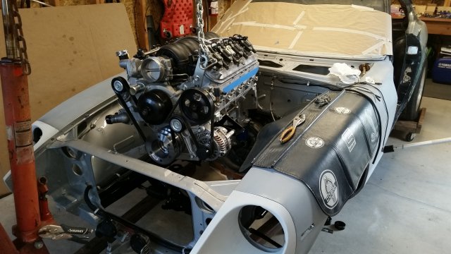

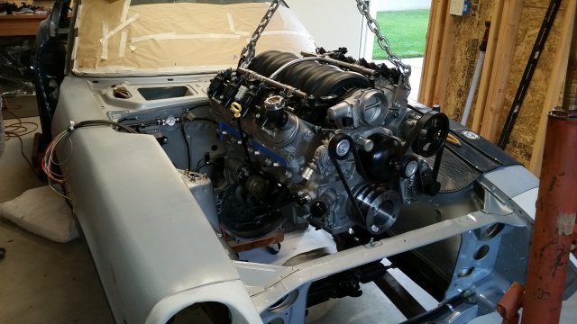

mrk3cobra Posted October 4, 2017 Author Share Posted October 4, 2017 LS2 finally going in the 240Z for the first time. Quote Link to comment Share on other sites More sharing options...

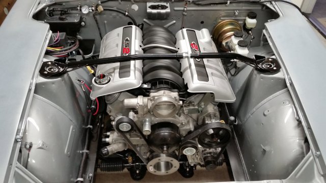

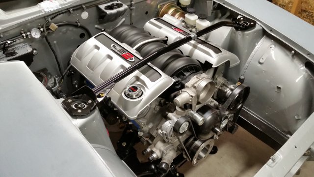

mrk3cobra Posted October 4, 2017 Author Share Posted October 4, 2017 Ls2 with Hoke performance kit installed in the 240Z last night. Pete 1 Quote Link to comment Share on other sites More sharing options...

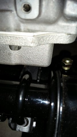

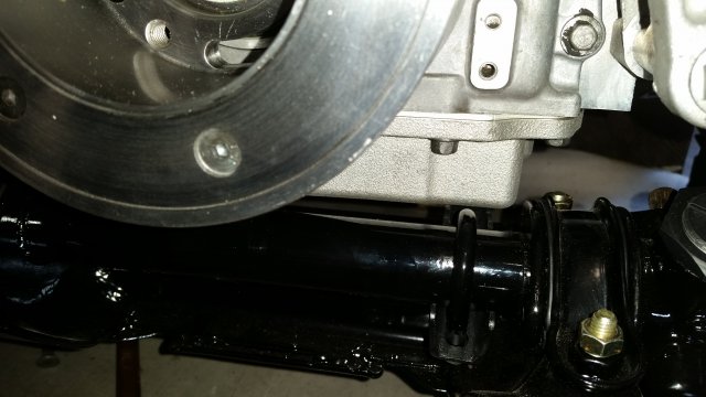

mrk3cobra Posted October 4, 2017 Author Share Posted October 4, 2017 The only problem I had was the oil pan rested on the Ubolt bracket on the steering rack. I think I will trim some of the bracket and add a washer on top of the motor mount to raise the LS2 by 1/8". I think it will clear, or I can do what Austin suggest and remove the Ubolt and bracket and run without it. Pete Quote Link to comment Share on other sites More sharing options...
trackzpeed Posted October 5, 2017 Share Posted October 5, 2017 If I remember right, that UBolt is necessary for rack stability. Just my .02. Progress looks great and car is coming along nicely. Jim Quote Link to comment Share on other sites More sharing options...
Richard Oben Posted October 5, 2017 Share Posted October 5, 2017 Yup have to keep U bolt. Washer time Having the engine low is one thing too low can lead to other issues. Nice job. Clean build! R Quote Link to comment Share on other sites More sharing options...
BrandenZ Posted October 5, 2017 Share Posted October 5, 2017 That's odd. I had no such U-bolt clearance issues. In fact, due to steering rod placement adjustments that I needed to make with the Hawks headers, I actually had to loosen and move it with the motor installed. Did you use both sets of washers included in the Hoke kit? If so, I'd probably just add a 2nd set to both sides. Bonus: that'll get your exhaust a bit higher. Quote Link to comment Share on other sites More sharing options...
mrk3cobra Posted October 5, 2017 Author Share Posted October 5, 2017 I received 4 washers, I used one on the bottom and one on the top of each mount. I know when I received the cross member from Austin he said that it was from a 280Z, I guess there could be a slight difference that could cause the issue. Pete Quote Link to comment Share on other sites More sharing options...
BrandenZ Posted October 5, 2017 Share Posted October 5, 2017 Maybe so. I received the same and also installed one on the top mount and one on the bottom on both sides. Well, the install looks fantastic aside from that one blip! An extra washer or two on both sides should do the trick. BTW -- Is that an underdrive pulley on the crank? Quote Link to comment Share on other sites More sharing options...
mrk3cobra Posted October 6, 2017 Author Share Posted October 6, 2017 "BTW -- Is that an underdrive pulley on the crank? " Yes the pulley is a 25% underdrive pulley from Summit racing. Quote Link to comment Share on other sites More sharing options...

LLave Posted October 6, 2017 Share Posted October 6, 2017 Maybe you can move the u-bolt clamp to the far passenger side and sneak it in. Perhaps on the outside of the bushing. Or.... Maybe make a wider flatter u-bolt with some 14ga or something. Just an idea. Quote Link to comment Share on other sites More sharing options...

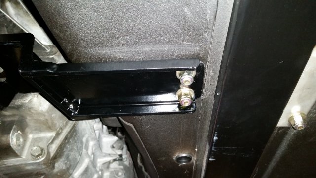

mrk3cobra Posted October 10, 2017 Author Share Posted October 10, 2017 Finished the T56 install. Wiring harness should be arriving this week. Pete Quote Link to comment Share on other sites More sharing options...

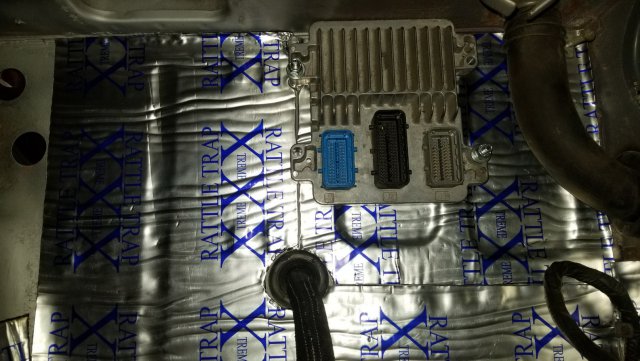

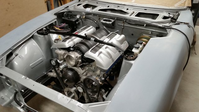

mrk3cobra Posted October 11, 2017 Author Share Posted October 11, 2017 LS2 Computer installed. Pete Quote Link to comment Share on other sites More sharing options...
