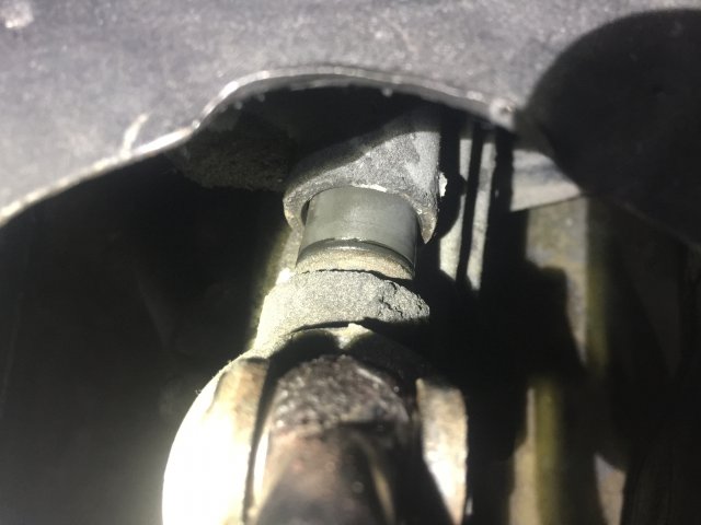

Jboogsthethug Posted January 19, 2018 Author Share Posted January 19, 2018 Now, on your transmission does your shifter slide in and out, like on the video in the first link I posted? Or does yours stay in place? Mine is coming out like a piston and I've wondered if it is indeed a pin missing that is supposed to stop that from backing out like it is, which would make sense why I can't even touch the 2nd, 4th, and reverse gears. I can;t even grind the gears, it's not engaging at all when I am able to shift into the area they're supposed to be. This piece, I've attached the picture showing the place where it slides in and out inside the circle, the arrows demonstrate it's movement. Quote Link to comment Share on other sites More sharing options...

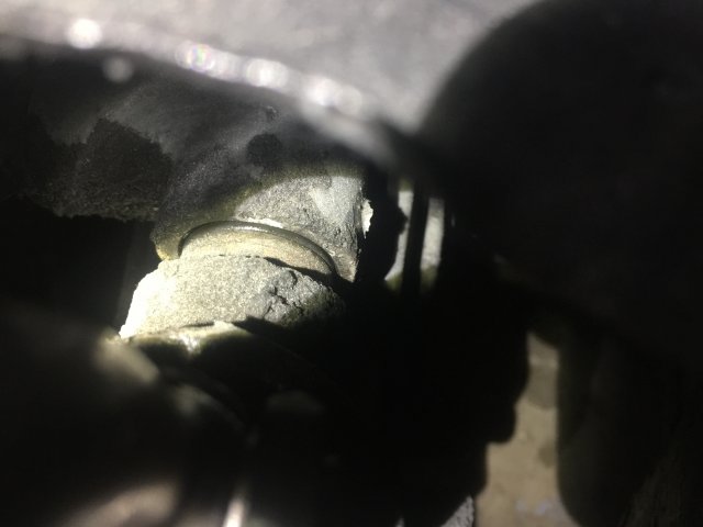

Jboogsthethug Posted January 19, 2018 Author Share Posted January 19, 2018 more pics to illustrate the situation Quote Link to comment Share on other sites More sharing options...
winstonusmc Posted January 20, 2018 Share Posted January 20, 2018 That's not right. It shouldn't come out like that. Quote Link to comment Share on other sites More sharing options...
Zetsaz Posted January 20, 2018 Share Posted January 20, 2018 (edited) This is mine. Same area you're pointing to. It's almost all the way in. The pin on yours on the front side is out in that picture. That piece shouldn't move in and out. Should only go side to side. Edited January 20, 2018 by Zetsaz Quote Link to comment Share on other sites More sharing options...
Jboogsthethug Posted January 21, 2018 Author Share Posted January 21, 2018 On 1/19/2018 at 5:23 PM, winstonusmc said: That's not right. It shouldn't come out like that. 21 hours ago, Zetsaz said: This is mine. Same area you're pointing to. It's almost all the way in. The pin on yours on the front side is out in that picture. That piece shouldn't move in and out. Should only go side to side. Ok this is definitely narrowing it down! Thank you so much for the info. Is this what you're talking about? assuming that's what you mean, I'll have to look into that and see if I can find that particular piece online. if not, I suppose I'll buy a new transmission! I'll keep you updated. Quote Link to comment Share on other sites More sharing options...

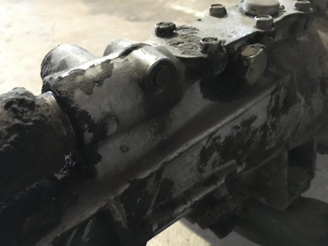

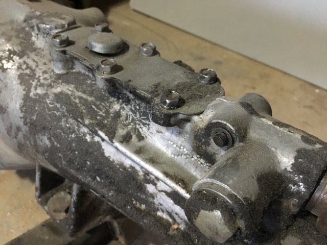

Jboogsthethug Posted April 21, 2018 Author Share Posted April 21, 2018 OK so I pulled the tranny to get a better look, I'm not seeing any missing pins on the outside, do I need to take the cover off to get to the inside or something? Am I just missing something obvious? is it possible that the pin needs to be pulled out, then the shifter repositioned, then reinstall the pin? IMG_0164.MOV Quote Link to comment Share on other sites More sharing options...
rossman Posted April 21, 2018 Share Posted April 21, 2018 7 hours ago, Jboogsthethug said: is it possible that the pin needs to be pulled out, then the shifter repositioned, then reinstall the pin? Just pull it out and check it. It may be worn or broken internally. Quote Link to comment Share on other sites More sharing options...
