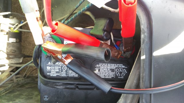

skillinp Posted February 22, 2018 Share Posted February 22, 2018 Hello all, long time, no see. Which is good since I typically only come here when something is bad... anyway I've got this problem, see? Started a bit ago, a little trouble getting the car to start. Classic *click* when I'd turn the key. Checked wiring on my starter, since one has come off in the past leading to this problem... not this time. I rock the car a little in desperation (I'm on a dirt road, quite far from civilization at this point) and somehow it starts up. Whew, I think. I get home. Try turning it on again? Click. all wires connected. OK, must be the battery. I get a jump from a neighbor, run it for a while and I turn on the lights to see how it's going. This kills it. Well. Not going to bug the neighbor again, wait for my girl to come home. Jump it, run over to the neighborhood Napa. Guy comes out to test the battery and alternator. He says battery is bad, alternator is good. I had to jump it to get this tested. Jump again to drive over to AutoZone because I still have the battery under warranty until March (Bought it just shy of two years ago). Guy verifies battery is no good, I replace it, but not before brushing the cables free of any possible corrosion. Car won't start. I jump it to go home because I don't know what else to do, and I need to get to work asap anyway at this point, so now I'm borrowing my girl's car for work. Thanks babe! But still not sure about this car. I have a multimeter that I am a little familiar with, use it to test the ground, and it's good. I jump it again and decide to just run it a bit to see if the battery was just dead from the store (it had almost no charge at this point). I run for a little bit and LO! There's smoke coming out of the dash vents on the driver's side! Electrical smell. Great. I'm about to pull the dash apart, which I've never done before and am not looking forward to because my best guess is a short somewhere in there. It's not a well-educated guess. Any ideas? Car info: '73 240z with l28 and upgraded windshield wiper motor ('94 Accord, I believe) and upgraded MSA fuse box, both of which were done over two years ago. no radio, no A/C, no heat connected (core just sitting there) and none of that has been changed/touched in years. Quote Link to comment Share on other sites More sharing options...

skillinp Posted March 10, 2018 Author Share Posted March 10, 2018 Ok, thank you all so much for your time and ideas. It turns out that I'm just a big idiot. I couldn't find whatever was smoking, almost took the dash off in my search. It took me a long time to even get to this point because I've been busy with school and work and the daylight just isn't what it is during the summer months (yet). ANYWAY. I get out the multimeter and do some more tests. I figure I'll try to make it smoke some more with the middle panel and vent panels out so I can see where it's coming from. This means I have to jump start it again, but I wanted to see how the voltage was doing before. OH, LOOK AT THAT, the battery is at 12.3 ish volts. THAT'S WEIRD. so I touch to the engine, yup, still 12.3, so the ground is good. Maybe I should actually test the positive connection. Hmm... would you look at that, it's only giving 3 volts. So I'm a big idiot. I take off the terminal and clean it (again! I swear to god, I brushed and cleaned very thoroughly when I changed the battery), notice there was some grease which came off. Don't know how it got on there. Starts right up when I reattach battery to terminal. I swear. to. god. I can't believe I'm so dumb. Drive it around the next day, it stopped again. Popped the hood, cleaned the terminals again, works again. WTF. I think it must be the anti-corrosion grease I bought which came with the felt pads when I got the battery. Never been an issue before, so idk why it seems like it's an insulator now. Fun story on the picture, before I cleaned the terminals off the second time, I found I could jump the car to itself using the battery which had a poor connection. Anyway, sorry for wasting everyone's time, but thought you deserved an update. TL;DR: OP is an idiot and didn't clean the grease off the positive terminal of the battery when installing. It was the battery's connection the whole time. 1 Quote Link to comment Share on other sites More sharing options...
