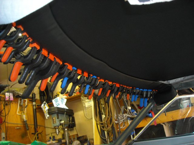

I went to fabric shop bought some thin foam and black marine vinyl. You can take your old as a stencil and make it a bit bigger you have about half an to an ich where you can pinch it in. Mine came off  my roof wasnt clean and used a weak adhesive.
  • Like 1
Share this post
I got a headliner from the Z store.com and you're right it was quite thick. Had to trim about an inch on the sides and the back because it was a little oversized.
Also I thought I could be safe with the spray-on adhesive and not get it everywhere so I didn't tape off the upper vinyls and yes I ended up getting glue everywhere haha.
But I used a clean cloth and that stuff called Goo Gone and it came right off no problem... I did however cover my up my seats with a old bed sheet.  I used SEM gloss black vinyl paint on the new headliner and it look'
