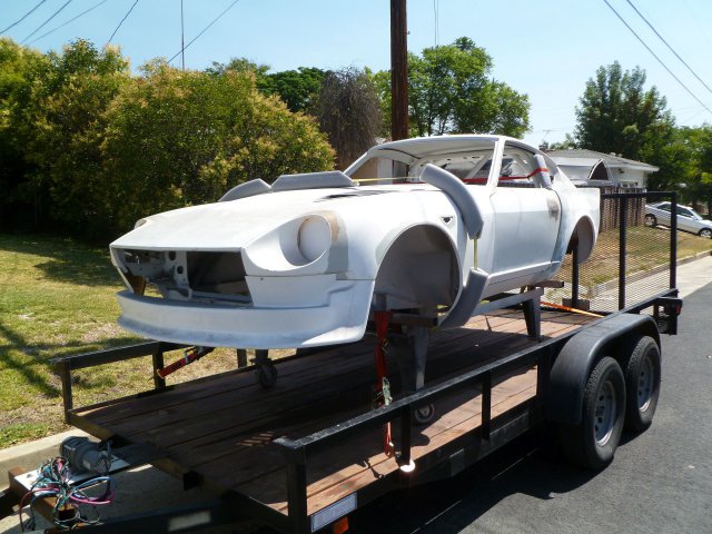

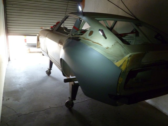

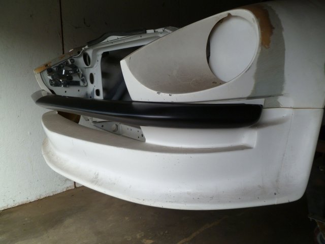

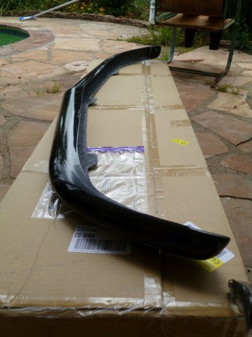

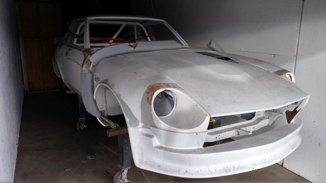

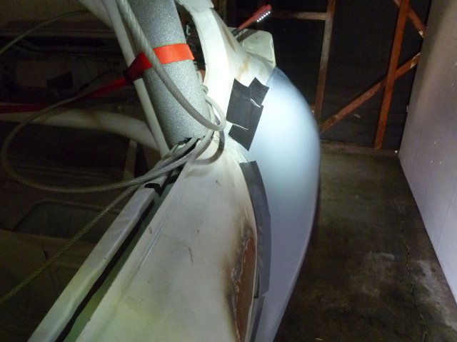

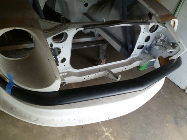

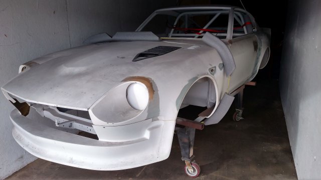

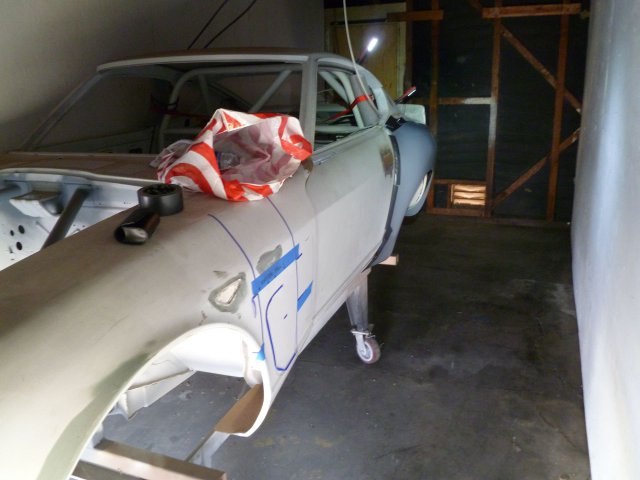

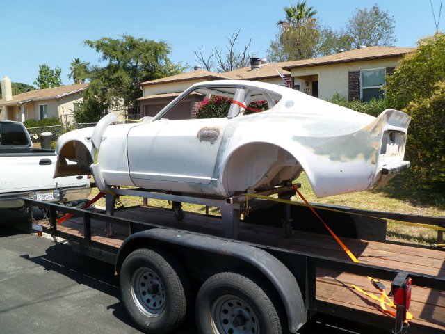

Nelsonian Posted September 14, 2018 Share Posted September 14, 2018 (edited) I have the front wedge shaped bumper in fiberglass from the Pandem kit that I ordered through Greddy.com. It was not the greatest constructed piece, but I contacted Greddy who also sent my supplied pics to Pandem who made good with a whole new one shipped for free. I was not expecting that nor did I push for that extreme result. The new one was of better build quality, but a little thin on the under side V/wedge area. I have to customize it to fit the rest of another front end wide body kit from Ztrix. I also have a full "Subtle Z" kit from Ztrix.com that increases width 1.5" over stock. Since having the kit blended on to the rear quarter panels, I decided to go wider rear and ordered the "YZ" quarter panels that offer 3" over stock width and allow a 12" wide rim to fit. There was some small fitment work required to get the Subtle Z kit to fit as to be expected with fiberglass and I suspect the new YZ rears will require some as well. John Washington of Ztrix is a stand up guy with very good communication and willingness to do right by you, I can't state that enough.... Here are some pics of my car project with the subtle Z kit, subtle front and rear YZ taped on for a quick visual and lastly the front bumper from the Rocket Bunny kit which will require work to fit my front. Hope some of that helps..... Edited September 14, 2018 by Nelsonian Quote Link to comment Share on other sites More sharing options...
