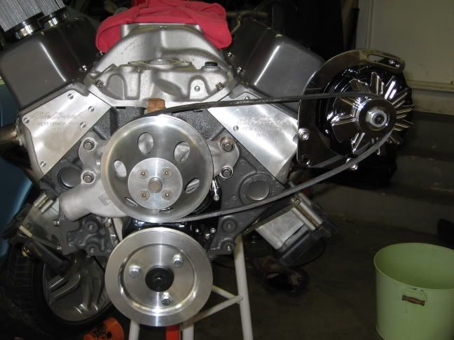

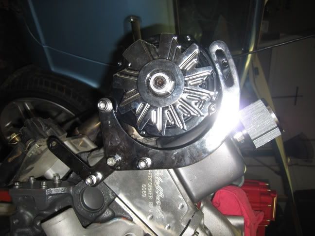

Thought I would post some pics of the two options I think are best w/ the short pump and the mount I picked up.
Drivers Side...Sits pretty close to the headers, think this is an issue? If I go this route, I'll have to add some bracing to the bottom hole, shouldn't be an issue, I'm just abit worried heat.
Passenger side I like a bit better, since the cyl head sits back a bit more on that side you get that much more clearance. Note the brace keeping the bracket from rotating, needs to be trimmed. I need to get longer standoffs, about another 1-1/8" should be just about perfect to center up the belt grooves. Should be cooler here as well as a shorter (cleaner) lead to the alt.
Let me know what you guy's think. Again this is the snug type mount (Yeah right :) ) w/ the short style water pump.
Does it look like there will be fitment issues w/ the strut towers or inside fenders? Hard for me to tell. Looked at some other pics of SBC's but didn't find any that were a top view of the clearance from VC to fender.
