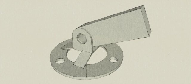

I am planning on connecting the rear strut towers in my 71 240z. Is it better to bolt it to the top of the struts? or can I just weld bars between the diagonal braces between the towers?
If a bolt connection is better, I will place one bar between the tops of the towers, and build a simple truss in between the towers.
One issue is - If I use the bolt connection at the top, is there any use of it being removable, since the rest would be welded?
FYI,I would use 1/2" x 1" steel bars. Im not overly concerned about weight.
