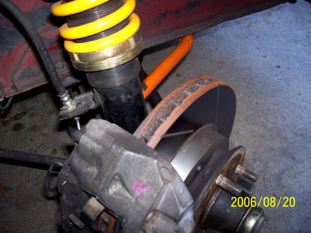

Zmanco Posted August 23, 2006 Share Posted August 23, 2006 Perhaps a picture will help. Look at the top of the frame. You can see the banjo fitting of the SS line on the left where it attaches to the caliper, and the female fitting on the right where it connects to the existing hard line. The only thing between them is the SS line itself. Sorry it's not framed better, I was guessing holding the camera under the car. Link to comment Share on other sites More sharing options...
JMortensen Posted August 23, 2006 Share Posted August 23, 2006 That does help. We apparently have different calipers. Mine were the solid rotor version, and they took a normal bubble flare type of connection. Your's obviously take the banjo fitting. Sorry, I guess I ASSumed they all used the same fitting. Link to comment Share on other sites More sharing options...
