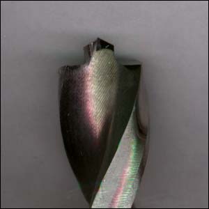

260DET Posted January 13, 2006 Share Posted January 13, 2006 An angle grinder works most times, as described for the cutoff wheel. A modified proper sized drill bit can also be used. The drill is ground with a flat face ie 90 degree angle to the shank, but with a sharp tit in the center. The tit helps keep the drill centered when starting, the flat face of the drill 'mills' the spot weld metal down. Quote Link to comment Share on other sites More sharing options...

Guest 73TPIZ Posted January 18, 2006 Share Posted January 18, 2006 Black and Decker (and others i believe) make a drill bit similar to the high dollar spot weld removers. I think the B&D is called a bullet bit. It's what 260DET talks about with the factory modification. Here's a link to a pic of one if you need one. Much cheaper than the "specialty" cutters with the replaceable 1/8th" center bit. Also, use a regular 1/8" bit for a pilot hole, and come behind it with the bullet bit. If you are watching close (safety glasses) you can usually see when the bullet bit goes thru the first layer. http://www.bcae1.com/images/jpegs/plexibanddbit.jpg I use the 5/16ths size and it seems to work well. Now since you are not re-using the rail, I'd just cut it off and grind the remaining lip off, as described above. Quote Link to comment Share on other sites More sharing options...
