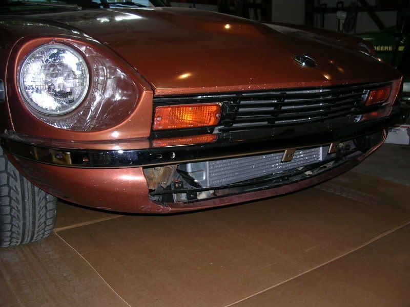

Pennyman Posted January 9, 2008 Share Posted January 9, 2008 Here's a pic of mine after the swap. Made my own front brackets similar to what was on the previous page. Used the stock 240z rear beackets bent a little to fit in the rear. Quote Link to comment Share on other sites More sharing options...
frldyzpimpn Posted January 9, 2008 Share Posted January 9, 2008 Here's a pic of mine after the swap. Made my own front brackets similar to what was on the previous page. Used the stock 240z rear beackets bent a little to fit in the rear. What type of air dam is that? Looks really clean. Quote Link to comment Share on other sites More sharing options...
SkYBlue280Z Posted January 10, 2008 Share Posted January 10, 2008 What type of air dam is that? Looks really clean. It looks to me like its the Urethane Air Dam right here http://www.thezstore.com/page/TZS/PROD/7AD2/50-1412 btw great looking Z! Love the rims and bumper Quote Link to comment Share on other sites More sharing options...
280Z Turbo Posted January 10, 2008 Share Posted January 10, 2008 Here's my car with a '70-'72 bumper. I used some 1" x 1/8" aluminum stock available at any Home Depot/Lowe's/etc. I used a thin piece of metal as a template and bent the metal to match. Quote Link to comment Share on other sites More sharing options...
