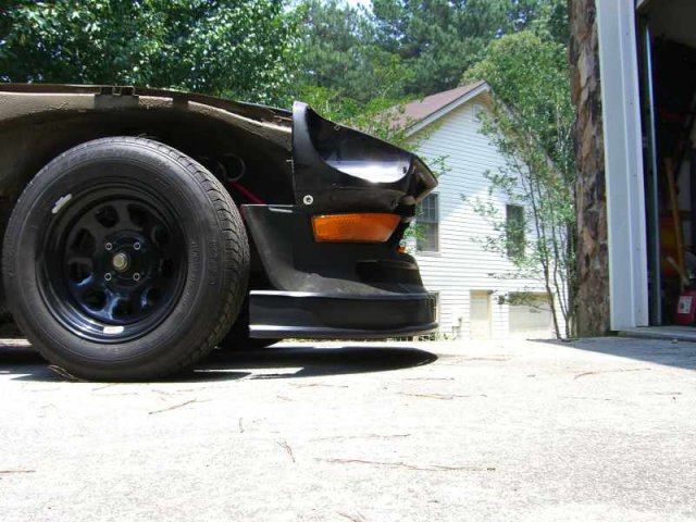

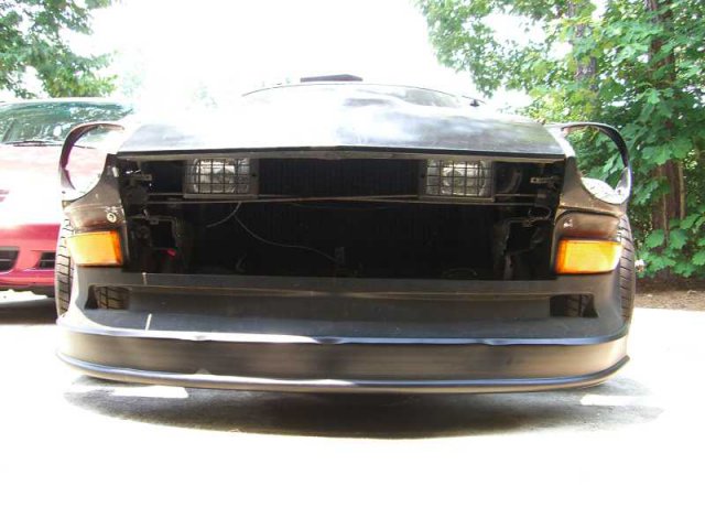

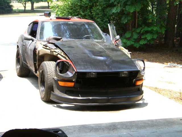

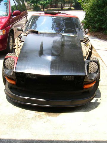

OlderThanMe Posted June 22, 2006 Author Share Posted June 22, 2006 the new low...time to install that splitter now that the edging is in place..just if I had metal cutting tools...I trimmed that passenger side that is too long... Quote Link to comment Share on other sites More sharing options...
OlderThanMe Posted June 22, 2006 Author Share Posted June 22, 2006 I am thinking of putting another layer on this stuff above the air dam to help block off the huge mouth. Comments and suggestions welcome anytime. Quote Link to comment Share on other sites More sharing options...

palauoriginal Posted June 27, 2006 Share Posted June 27, 2006 diggin the splitter Quote Link to comment Share on other sites More sharing options...
OlderThanMe Posted June 29, 2006 Author Share Posted June 29, 2006 cool thanks. I still need to get a metal cutting tool for my house so I can finish shaping the outer profile shape. Quote Link to comment Share on other sites More sharing options...
