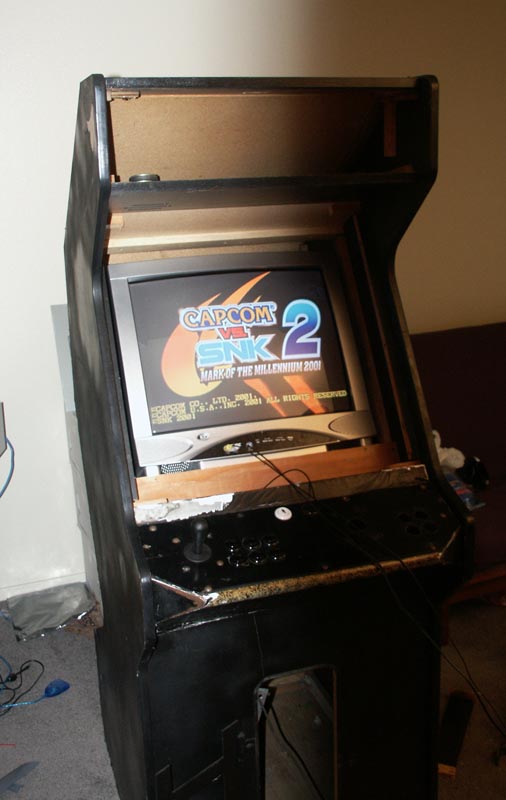

auxilary Posted November 20, 2006 Share Posted November 20, 2006 picked up an original SF2 cabinet for $20. Found 4 quarters in it, so it's really $19. It's pretty beat up, needs work, but usable. I am currently building a front control pad so I can fit more controls on it. The TV is a walmart $140 unit 24", hooks up to an old pc running MAME (Multi Arcade Machine Emulator), which will be serving about 500-600 oldschool arcade games, ranging from Pacman to Marvel Superheroes vs. Street Fighter. Almost everything from early 80s to late 90s. Controls are from x-arcade, lifetime warranty for 2 joysticks, 20 buttons, and $30 for all of hte above. Controls are hacked up sony playstation controllers that I soldered and rewired to work with the arcade buttons and joysticks, and they run through a USB converter on the PC. This also allows me to hook up my PS2 if I want to play any fighting games from it. So far total cost of the project has been $190, and $140 of that was the TV Quote Link to comment Share on other sites More sharing options...

auxilary Posted November 20, 2006 Author Share Posted November 20, 2006 i am just using an old pc i put together from spare parts. amd athlon xp2000+ (1.67ghz) 512 mb ram ati radeon 7000 32mb video card with tv out 40gb seagate hard drive sound blaster live Quote Link to comment Share on other sites More sharing options...

auxilary Posted November 20, 2006 Author Share Posted November 20, 2006 well, i got tekken tag for PS2 (i have a hard drive in my ps2, and yes, i own tekken legally, just speeds up load times), and the joystick i built out of ps2 controllers works great for tekken and plugs right in Quote Link to comment Share on other sites More sharing options...
