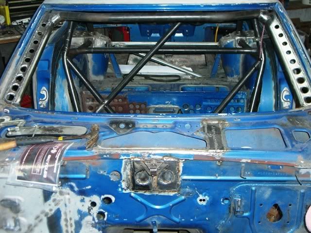

Booztd 3 Posted February 20, 2007 Share Posted February 20, 2007 Guys I picked the car up from the cage builder's on saturday. I am quite impressed with the work that was done. The car will be certified for 8.50 and slower ET's. The swingouts are fully removable and the T-tops are fully functional as well. Rear Bars tied into main hoop Drivers side kick panel, notice how the kick panels are still in place Window net up Drivers side swingout pin Passenger Area, swingout pin, main hoop, and harness bar Passenger swingout & pin T-top and interior panel clearance Passenger bar swung-out I should be painting it on wednesday, and maybe start working on getting the rest of the interior back in Quote Link to comment Share on other sites More sharing options...

Z-Gad Posted February 20, 2007 Share Posted February 20, 2007 Lookin good, but I think you need some more bars around the driver to be certified for 8.50's though... Quote Link to comment Share on other sites More sharing options...

Booztd 3 Posted February 20, 2007 Author Share Posted February 20, 2007 what's shakin? Th400.......rwd, much lighter......its doable. I said its cert'd for 8.50's becuse thats the step between 9.99 and faster. I doubt I'll make 8's, or even low 9's this year, but we'll see 11.49-10.0 and you need a 5 point roll bar 9.99-8.50 and you need a 6 point cage 8.50-7.50 and, well thats alot more ♥♥♥♥ To go faster than 135 you need a window net To go faster than 150 you need a chute Quote Link to comment Share on other sites More sharing options...

Lason Posted March 3, 2007 Share Posted March 3, 2007 Your missing two bars that are going to keep you from getting it certified. There needs to be diagonal bars fron the main hoop down to the tranny tunnel to be considered a NHRA legal 10 point. Other than that it looks real good. Quote Link to comment Share on other sites More sharing options...
Booztd 3 Posted March 7, 2007 Author Share Posted March 7, 2007 Your missing two bars that are going to keep you from getting it certified. There needs to be diagonal bars fron the main hoop down to the tranny tunnel to be considered a NHRA legal 10 point. Other than that it looks real good. I'm on page 87 of the NHRA Sport Compact rulebook and I do not see this rule outlined anywhere, if so could you please help me out with that? Also, I have no idea why tying two diaganal bars into the transmission tunnel would help for any reason. The trans tunnel is pretty thin sheet metal and would provide no rigidity if stress was placed on those points Quote Link to comment Share on other sites More sharing options...
katman Posted March 7, 2007 Share Posted March 7, 2007 "Also, I have no idea why tying two diaganal bars into the transmission tunnel would help for any reason. The trans tunnel is pretty thin sheet metal and would provide no rigidity if stress was placed on those points" Werd. I always thought the two diagonals to the tranny tunnel were a waste of tubing. Structurally a diagonal in the plane of the main hoop from driver's head to passenger side bottom of main hoop would add much to the integrity of the rollover structure, but if the sanctioning body doesn't require then you decide whether it's needed or not. In road racing it would be. Quote Link to comment Share on other sites More sharing options...
JMortensen Posted March 7, 2007 Share Posted March 7, 2007 I agree that the trans tunnel isn't the smartest place to brace to and I too don't really understand why the drag racers put bars there as a general statement, but in a Z the trans tunnel right above the diff crossmember is pretty heavily reinforced. There is a layer of heavier steel where the strap bolts into and this continues laterally through the control arm bushing mounts, a reinforcing plate on the underside of the trans tunnel, and the cargo deck area has a vertical reinforcing plate right on top of the trans tunnel inside the car. Quote Link to comment Share on other sites More sharing options...
Booztd 3 Posted March 7, 2007 Author Share Posted March 7, 2007 Structurally a diagonal in the plane of the main hoop from driver's head to passenger side bottom of main hoop would add much to the integrity of the rollover structure. I believe they call that a 'petty' bar dont they? Quote Link to comment Share on other sites More sharing options...
bjhines Posted March 7, 2007 Share Posted March 7, 2007 That is some pretty nice work. Did the interior get burned in the process? I recall the tough decisions around my roll cage design, there are soo many variations of the rules depending on what you are doing. With that said, there are certain features that are just too good to pass up. I think most organizations speak of some type of diagonal in the main hoop. It has been pretty well established that this bar is an important part of cage designs. Some people add the diagonal as literally part of the main hoop. I think the tube has to be an un-cut tube all the way from the drivers head to the passenger floor. It looks like your horizontal seat-belt tube is in the way. There is a way around this problem. I have seen many cages with the rear diagonal running from the drivers head to the passenger strut tower. Actually all of these seem to be Xs rather than one diagonal. Those tubes might be fairly easy to add without any extra work. ... Quote Link to comment Share on other sites More sharing options...
