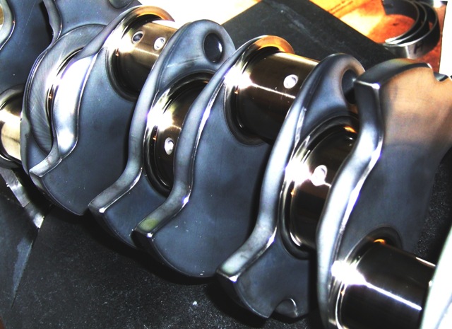

Pete, Here are some pics of an OEM Ferrari 355 crankshaft and bottom end during rebuild (Note the MASSIVE main bearing surface area):

Check this out. I think the notches in the couterweights are to gain clearence to be able to remove more weigh from the rod bearings, yes??? Will it really be that hard to remove weight from your crank design? Another added benefit I was just thinking about, is that though your crank weight might not be too much lighter, won't the shorter stroke mean the weight is closer to center, thus it should still "feel" lighter due to the lower rotational inertia. Do I have that right?

As for that crankshaft that you pictured, the notches are not for clearancing, but are a by-product of drilling the angled holes into the rod journals. ;) (note mine are drilled in a straight line through the entire crankshaft, that pictured is a great idea.)

What I meant is that the notches look like they were put there befor the drilling. But now that I'm looking at it again, they do seem to taper too one side. So they probably are just drilling through the counter weights. Though I gues it might be possible to come at multiple angles for added reduction.
