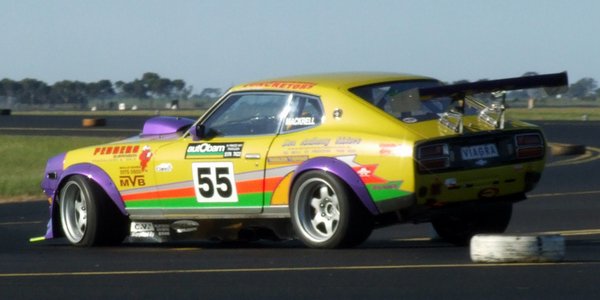

260DET Posted January 11, 2008 Share Posted January 11, 2008 Here is a pic of it, note the truck 4WD wheel hubs. Beautiful it aint. Quote Link to comment Share on other sites More sharing options...
OlderThanMe Posted January 16, 2008 Share Posted January 16, 2008 Dual R200 diffs and a Hilux transfer case... link found here on another thread here on HybridZ: http://forums.performanceforums.com/forums/showthread.php?t=67224281 "NERO" said in the link: OK, Kevin's car. It now has 880bhp nascar 6lt Chev engine, manual's auto 4spd 5000 stall (so no clutch and expensive manual and less time lost in gear changes), Toyota Hilux transfer case, R200 diffs with LSD's front and rear, Proflex suspension, 11" slicks all round. Faster than any WRX/EVO yet encountered. Massively fast in the wet. Has won the last Mt Gambier event outright, Aust champion in hillclimbs in class last 3 years another post from "NERO": It's continually developing, as most cars that are actually used regularly do. Kevin was thinking of a spaceframe/FG body car to get rid of 150kg of weight. I don't think sandown would be that good for it...it would be good at winton, esp in the wet. Back to my thoughts: just looking at it... the aerodynamic modifications look quite effective for a low speed rally car. Quote Link to comment Share on other sites More sharing options...

OlderThanMe Posted January 16, 2008 Share Posted January 16, 2008 To me it looks like it still has IRS in the rear...specifically, tubular control arms. Look at this pic: http://forums.performanceforums.com/forums/showpost.php?p=839951303&postcount=18 Notice rear wheel camber change at launch in this video: definitely not a truck frame. I believe the statements "NERO" made. Quote Link to comment Share on other sites More sharing options...

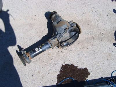

OlderThanMe Posted January 16, 2008 Share Posted January 16, 2008 So to build a monster like this... I'm guessing you would get a front diff from a nissan pickup(as in picture) some kind of center differential/transfer case, and the same ring and pinion gears front and back. When did Nissan put a R200 up front in the pickups? I'm guessing current Frontiers have them? The attached pic is a 1990 pickup diff. (R180?) Answered my own question front diff writeup on nico club. "C200 and R200A [short nose] gears ARE INTERCHANGEABLE. Yes, the same part numbers are used for the same ratios in the Nismo catalog for both diffs." C200 is just the rear diff in the solid axle. That brings the question if a C200 ring and pinion can be used in a R200 short nose to bolt in the back of a Z... Hmm... easily matched OE diff ratios! Quote Link to comment Share on other sites More sharing options...
