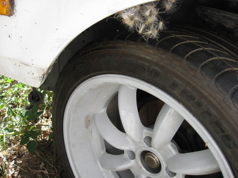

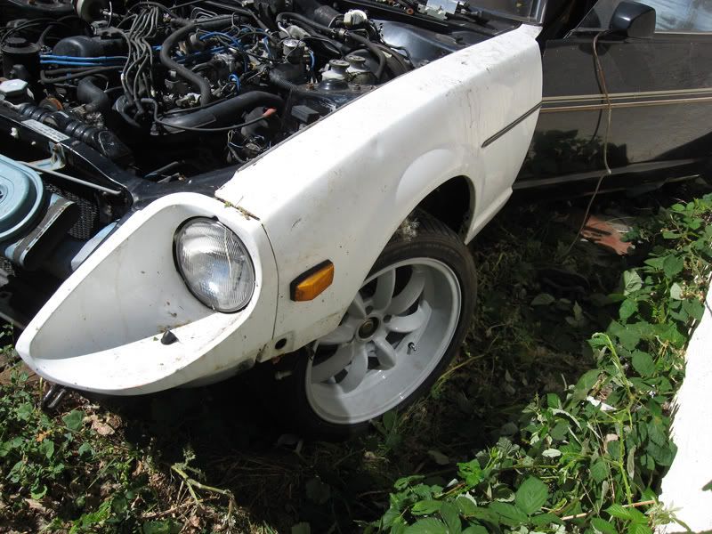

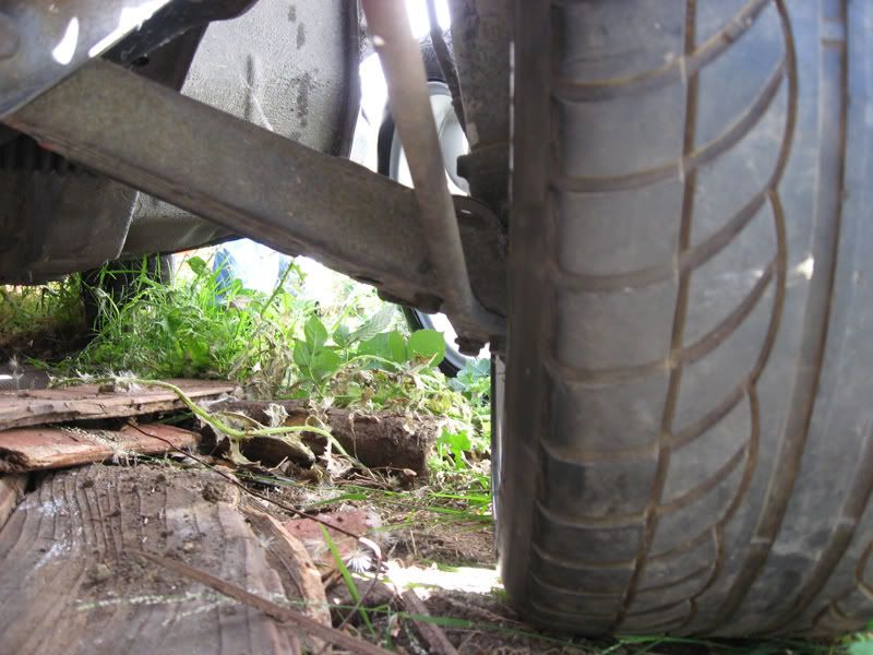

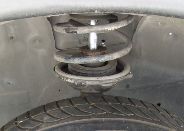

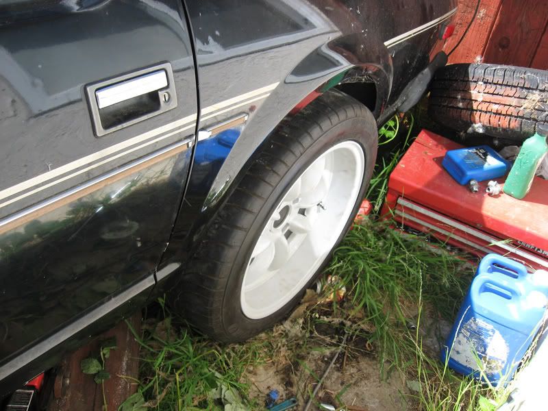

Gollum and I were able to fit the prototypes on his hack job 280zx today :mrgreen:. As far as I can tell the suspension was all stock. Unfortunately the front lower valance/air dam was missing, but I do believe it will clear with out an issue. The wheels and tires cleared with flying colors all around. The rear especially has room for more tire/wheel inward. As far as flaring goes... The front only sticks out maybe .5"-1" the rear closer to .75"-1.25". I think the fronts actually look fine with out flaring, but the rears probably look a bit out of place w/o a tad bit of rolling imho. Sorry that I couldn't get more photos at greater distances, it was cramped there. The wheels really look great on the car, unfortunately the pictures do not do them justice imho. Enjoy! :)
