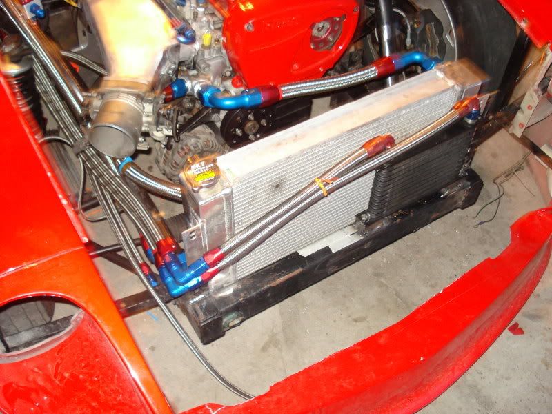

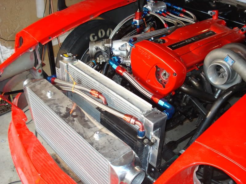

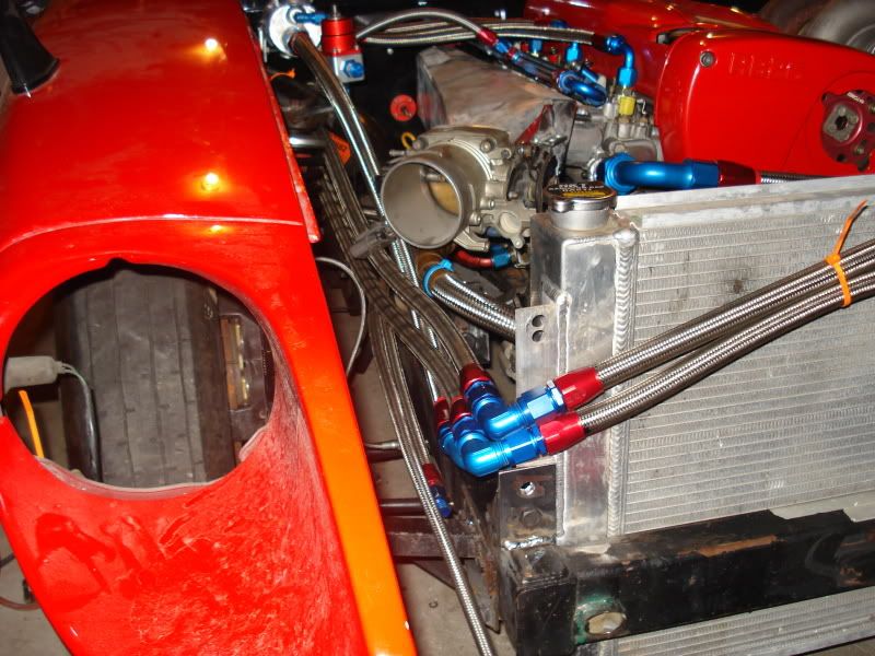

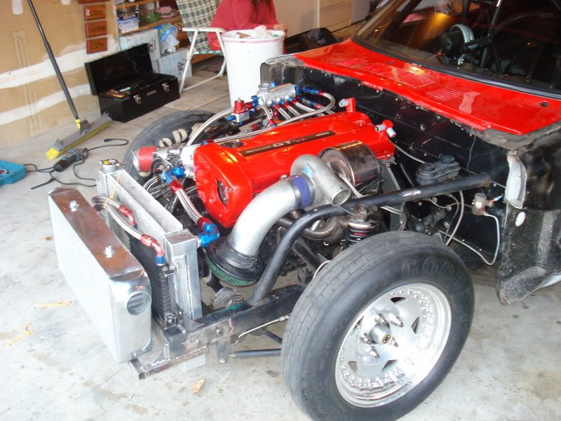

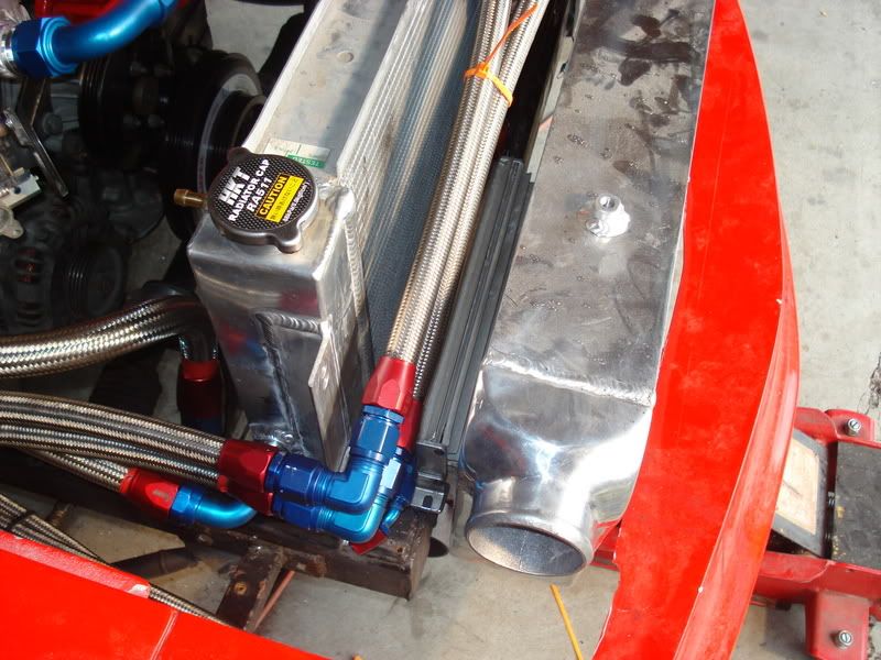

stony Posted September 26, 2007 Author Share Posted September 26, 2007 Update: oil cooler/filter relocator is plumbed Gonna take a break and let all the holes in my hands heal up before i make any more hose The oil cooler lines will be clamped to the side of the radiator for anyone wondering Next is the fuel system. Have to mount the new EFI pump/filter, mofify the tank with a return fitting and vent along with install a better sump. the -10 hose is allready run to the engine compartment all i have to do is run the return. Quote Link to comment Share on other sites More sharing options...

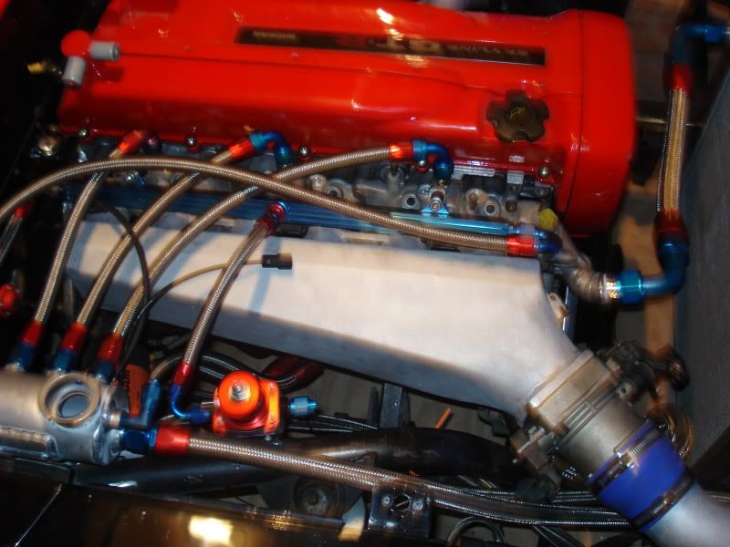

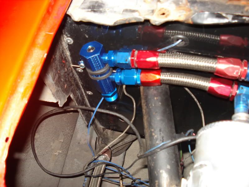

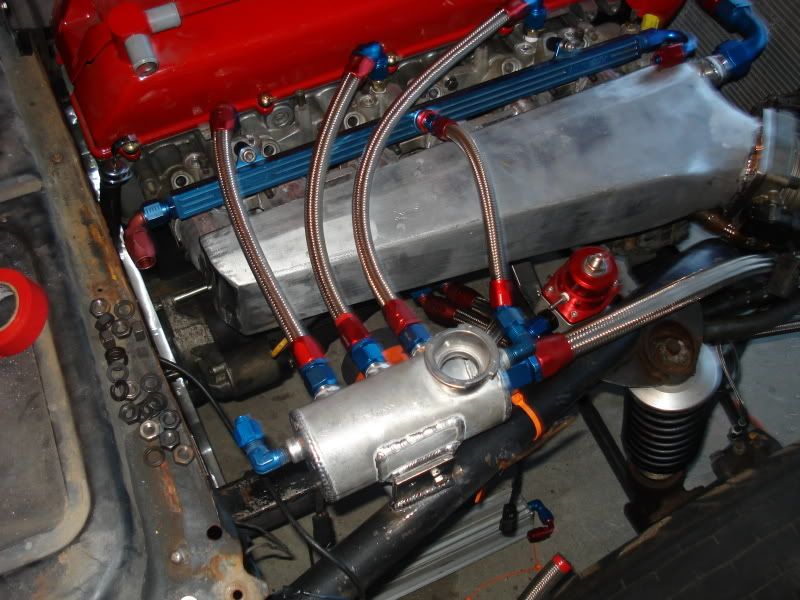

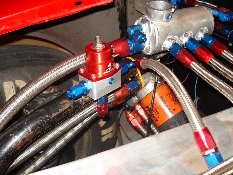

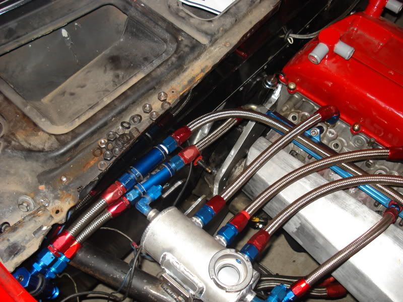

stony Posted September 27, 2007 Author Share Posted September 27, 2007 Got some of the fuel system done tonight :> All the fuel system needs is a -10 so I can hook up the distro block to the supply line, a -8 return hose routed from the FPR to the tank and a vent line installed in the tank. Next comes intercooler piping and a couple odds and ends for hardware and ladies this thing will be almost ready to start up. Quote Link to comment Share on other sites More sharing options...

turbo_fb Posted September 28, 2007 Share Posted September 28, 2007 stony said: For a second there I couldnt figure out why the fuel return line went into the water catch tank Finaly good pictures of that extra water outlet from the intake. Nice project and pics. Thanks. Quote Link to comment Share on other sites More sharing options...
Careless Posted September 28, 2007 Share Posted September 28, 2007 turbo_fb said: For a second there I couldnt figure out why the fuel return line went into the water catch tank Finaly good pictures of that extra water outlet from the intake. Nice project and pics. Thanks. HAHHAHA, it took me like 2 minutes of hard staring to figure out that the hose from the Rail was not connected to that 90° bend at the water canister. Quote Link to comment Share on other sites More sharing options...
stony Posted September 28, 2007 Author Share Posted September 28, 2007 Quote Link to comment Share on other sites More sharing options...

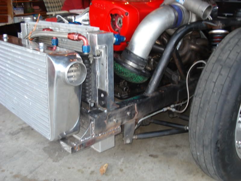

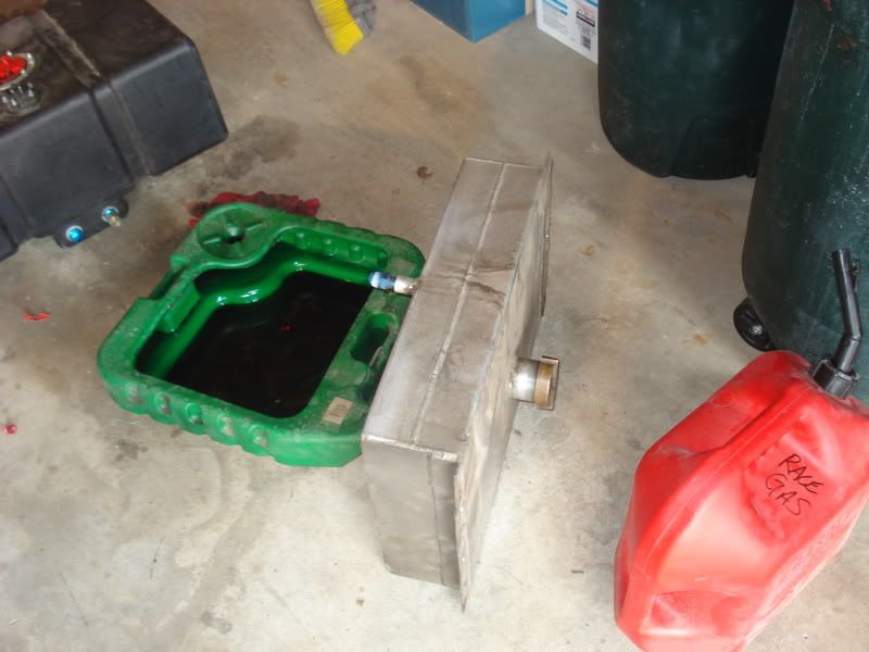

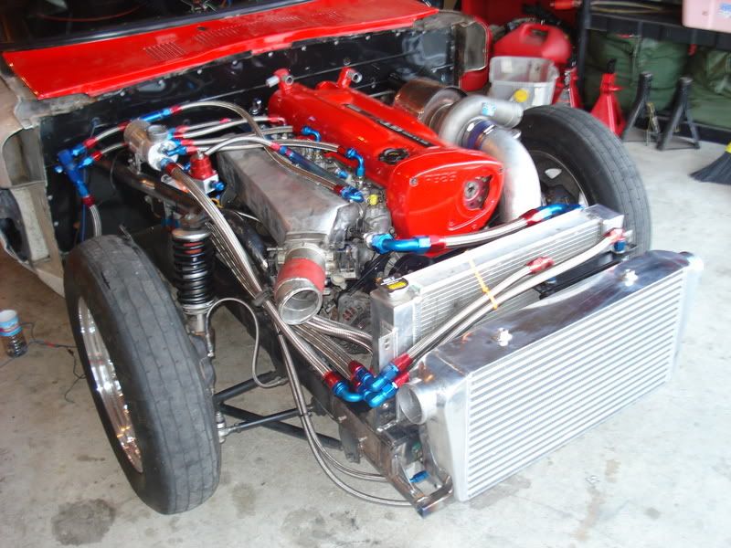

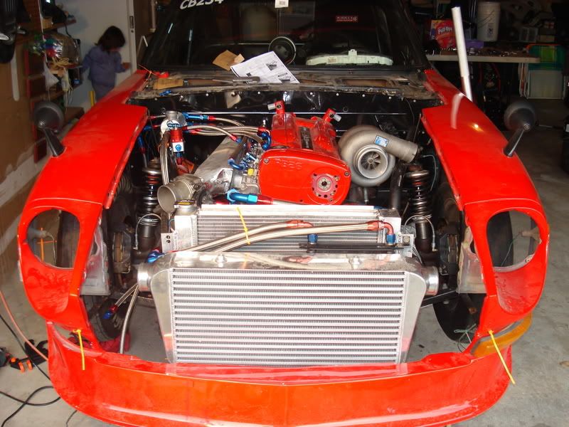

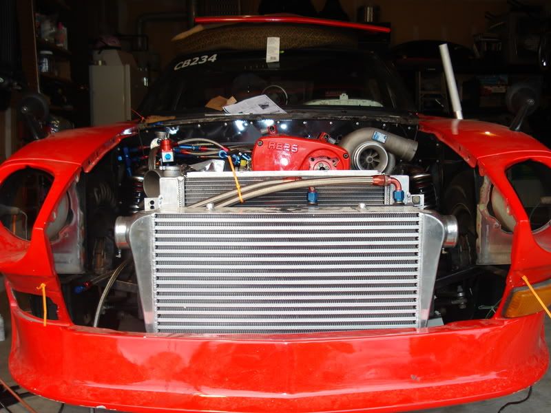

stony Posted September 28, 2007 Author Share Posted September 28, 2007 Working mounting the intercooler today and finishing up teh tranny cooler and fuel system. I got the fuel tank out and its a tad small!!!!!! will be modified with a HUGE sump and fitting for a return line and vent here are some shots of the intercooler in its location. Quote Link to comment Share on other sites More sharing options...
stony Posted October 1, 2007 Author Share Posted October 1, 2007 Well all the welding is done now all that is left is fuel tank, exhaust intercooler piping, and electrical. Quote Link to comment Share on other sites More sharing options...

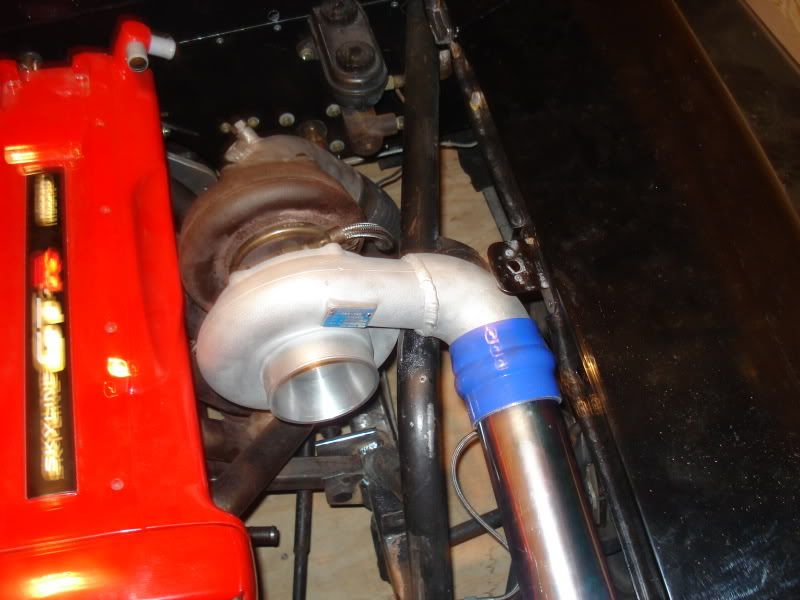

stony Posted November 11, 2007 Author Share Posted November 11, 2007 Sorry some of the pics are blurry its getting kind of cold outside and i took these in the trailer after i finished up today. Quote Link to comment Share on other sites More sharing options...
stony Posted November 11, 2007 Author Share Posted November 11, 2007 All the welding is done just need to find someone brave enoug to weld on the fuel cell once thats done then it all goes together for a final fit check then the engine comes back out to get the converter installed. Then off to get wired up Quote Link to comment Share on other sites More sharing options...
